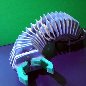

Pic 2 shows the first real world test of a soft robot arm that is controlled by robot neurons. To see a video and instructable on the robot you can go here: https://www.instructables.com/id/Soft-Robots-Make-An-Artificial-Muscle-Arm-And-Gri/

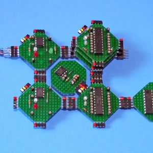

Step 4: Sensor Neurons for Robots
Sensor Neurons are designed to interface with different sensors such as switches, compasses, infrared sensors, etc. They work by constantly checking a sensor or sensors and recording the sensor value in a variable. When it receives a serial or other command from the master controller, the sensor neuron gives the value to the master.
I used fiberglass perf board with a pre-etched line pattern to make quick permanent circuit boards. Details on this method can be found here: https://www.instructables.com/id/Picaxe-Projects-1-Making-Fast-Printed-Circuit-Mo/

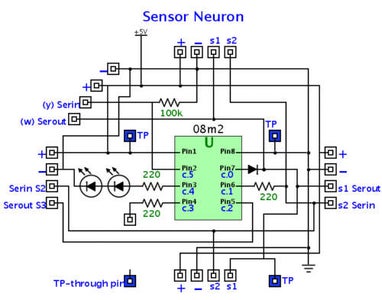

Step 5: Sensor Neuron Schematic
The schematic was quickly made using a free, very easy to use program called Scheme-It. Available from Digi-Key: http://www.digikey.com/schemeit

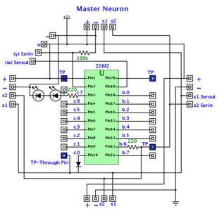

Step 6: Master Neurons for Robots
Master neurons poll all of the sensor neurons, determine the importance of what is sensed and then decide on responses. They then tell the actuator neurons what sequences of outputs to activate.

Step 7: Master Neuron Schematic
A 20M2 or 20X2 Picaxe micro-controller is used for the master neuron.

Step 9: Other Possibilities
Circuits That Fit Curved Surfaces
The step 8 pic shows how 24 gauge wires can be used to join Tinkertrons so that they can fill odd volumes or curved surfaces.
Making Smaller Neurons
Much smaller neurons can be created using surface mount technology. I built these in a larger size to make them faster and easier to make. I can also more easily redesign the circuits as I experiment with them.
