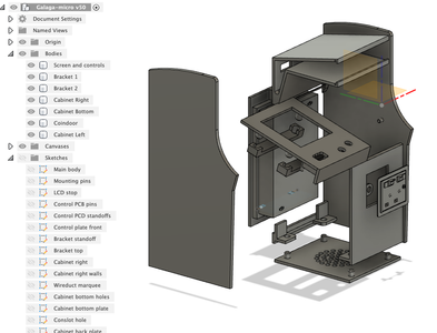

Step 2: Step 2: Print the 3D Parts
Print all the parts for the case:
  1. The batteryholder (for 3 AAA batteries)
  2. The cover for the batteryholder (or use 2a that does not have any text on it)
  3. The righthand side of the cabinet (is used as the mounting point for the other components).
  4. The coindoor
  5. The screenbezel and control panel (that hold the small screen, the joystick and the buttons)
  6. The brackets that clamp the screen to the controlpanel (so print this part twice)
  7. The bottom plate (jus snaps into place) or use 7a which has holes for the speaker)
  8. The left side of the arcade cabinet.
  9. as a bonus a small and a slightly larger joystick (although I just re-used the Tiny arcade joystick and buttons)

The final picture shows how ALL the other different components come together.
g. Take the 'Cabinet right' part and slide the screen and control assembly into the slot.
h. Glue the coindoor in.
i. Glue the speaker to the botton cover (with the holes)
j. Glue the batterybox into the back of the cabinet.
k. Shove all the electronics in the space
l. run 2 small wires through the back to the top Marquee are place the led circuitboard
m. CHECK to see if all the electronics still work!!
n. Glue the left side of the cabinet to the right assembly.
o. Snap the bottomplate into place.
