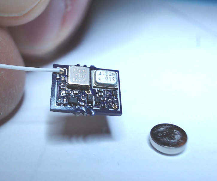

I wanted to know how small a FM spy bug could be build when manually assembled.
This is what I came up with, it measures about 0.05 square inches and is powered by a single 1.55V silver oxide battery.
Frankly, this is just a fun object, I don`t have a practical use for it.
I`m sure professionnally made spy bugs could even be smaller and work at higher frequencies which allows the antenna to be made smaller.

Step 2: The Circuit
All the components here are the smallest that could be obtained for a reasonable price. All the components together cost about $6 US.
To the left we see a microphone which works down to a voltage of 0.9V. Its maximum voltage is 1.45V though, which is why we need to decrease the battery voltage a bit. This is done with the schottky diode.
The oscillator to the right is then modulated with the microphone output signal.
The frequency can be adjusted with C4 and/or L1. Once everything is assembled it`s easier to replace L1 or put a capacitor in parallel with it. If you watched the video on the previous page you will understand why. :-)

Step 5: The Components
Now the components are put on the board with the help of fine tweezers.
Step 6: Soldering
The board now needs to be heated. This can be done in an oven or on a hotplate. I found it easiest to glue the board on to a hotplate with superglue before depositing the solder paste and the components.
When assembled the hotplate can then just be turned on without moving the PCB, lowering the risk of accidently shifting the components.
The temperature is adjusted to about 250C (480F). As soon as the solder paste melts it will connect all the components to the PCB traces just like normal solder wire. The board should then be removed (careful not to shake it too much) and left to cool down.

With the layout I used we could then solder a wire into two vias on the back that serves as a battery holder.
Alternatively two wires can be connected to + and - in order to connect a different type of battery.
Step 8: Antenna
The last step is to connect the antenna wire. Ideally it should be at least 1/4 wavelength long.
The wavelength is calculated like this:
Wavelength = speed of light / frequency. That means for about 100MHz we would get 75cm (about 2.5ft).
I agree this is pretty long, but the wire can be very thin which can make it hardly visible.
