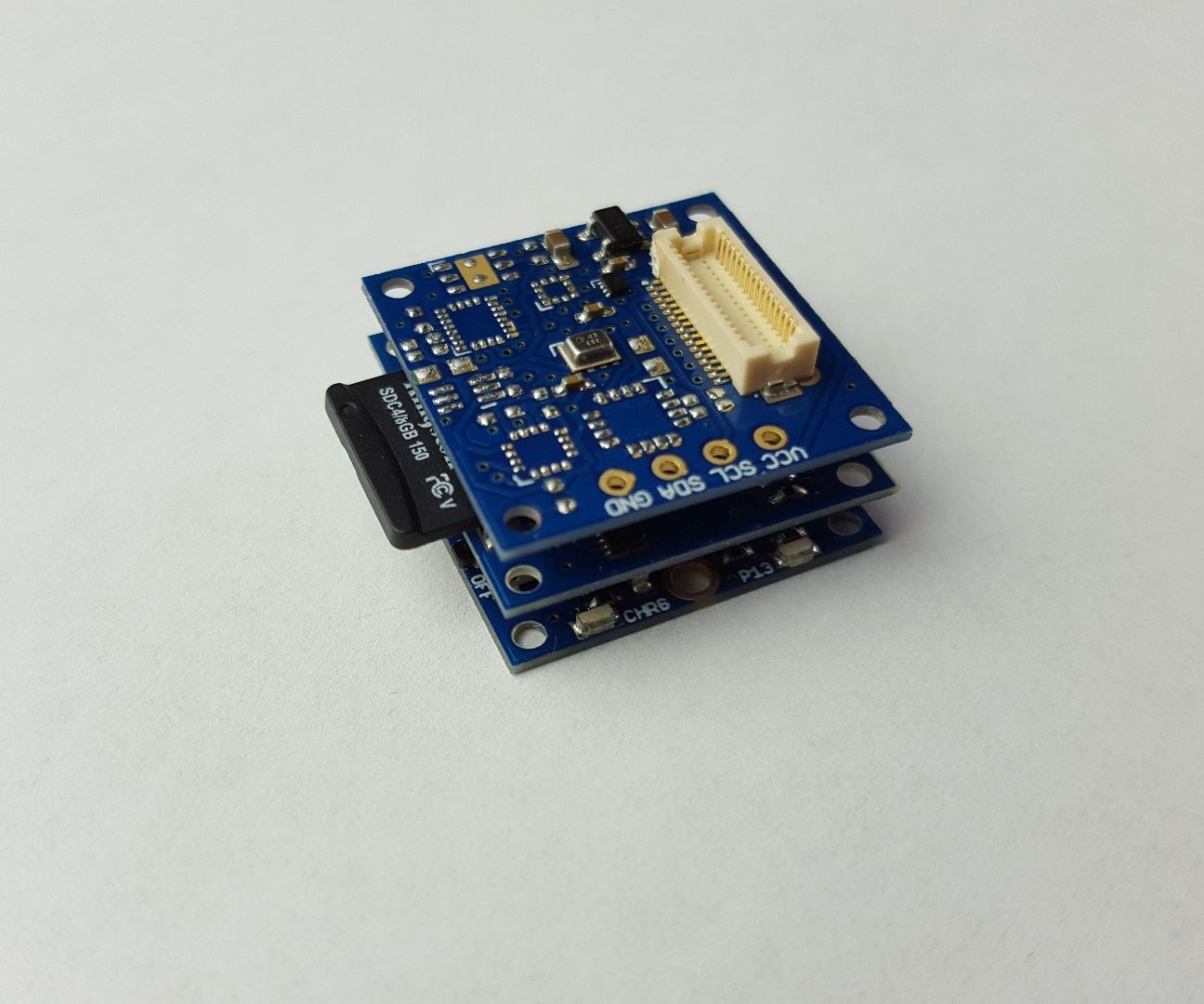

Step 3: Assembling the Boards
Start with the TinyDuino on the bottom of the stack. Add the USB TinyShield, then the Flash Memory TinyShield. The GPS TinyShield goes on top.
With your Mounting Kit, add spacers between the boards on the side opposite the connector. This will make sure your stack stays rigid and prevent your connectors from coming apart if pressure is placed on that side. If you're having difficulty placing them with bare fingers, I recommend a pair of tweezers to make the job easier.
Drop the screw through the holes and placed spacers and screw in the bolt on the other side to seal the deal. Finger tightening will be just fine to hold everything in place.
Plug in your Lithium Battery and your assembly is finished!

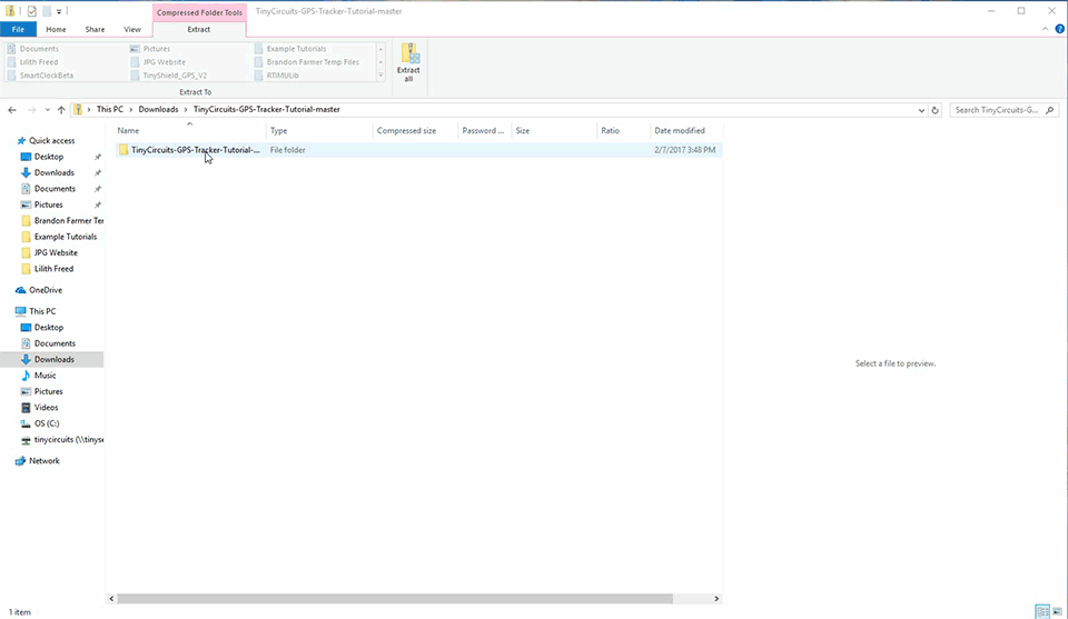

Opening the .zip file downloaded from GitHub.
Click here to download the .zip file containing the sketch. Save the 'GPS_Tracker' sketch folder as pictured above to any destination you like. Double click on 'GPS_Tracker.ino' to open the IDE.

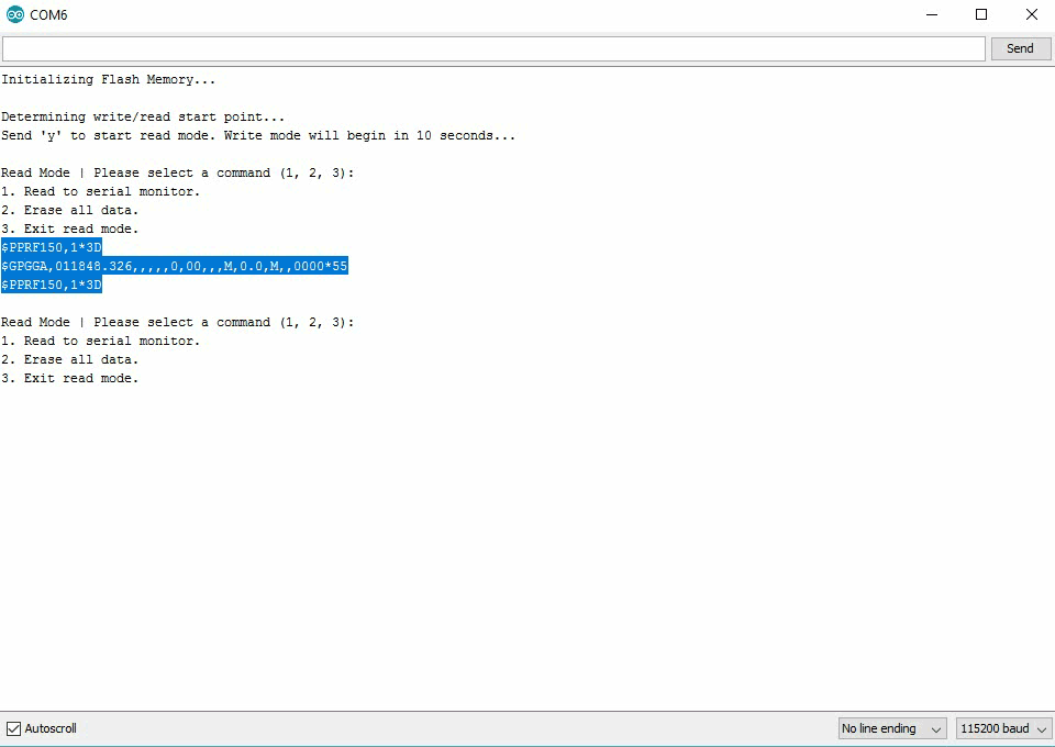

When you first opened the Serial Monitor to verify the operation of your TinyDuino, you saw the following dialog pop up:
The dialog that appears upon turning your device on.
We will now interact with this dialog to retrieve the data from your Flash Memory TinyShield. Send 'y' as shown below to begin read mode:
You can also hit the "enter" key to accomplish this.
We will read the data from our device by sending '1'.
The data displayed here is for example only - your data will look much different.
We can copy and paste the block of strings into Notepad or another plain text editor like so:
Use the shortcut CTRL + C or CMD + C to copy this data.
Save that file as a .txt file. It's ready for the next step! As for your device, if you wish to erase that trip's data from its memory, send '2' to clear all data:
Make sure you've saved all your data before taking this action!
