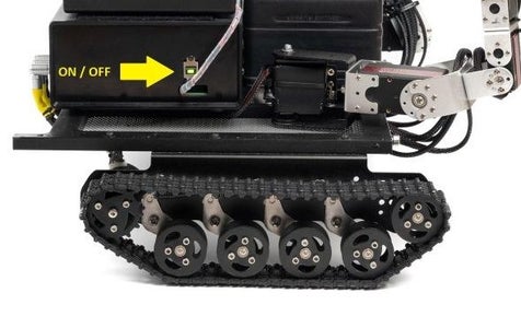

Power-up the Kenji-X1 with a green illuminated switch (Fig.6.b.), located on the right side of the robot. Please note, the green LED indicator should be illuminated, to be able to power–up the robot. Otherwise check if the rechargeable battery is installed. After booting is finished, and the robot is on working duty, you can find the name on your network list. Use the provided password and IP-address to connect to it.
As soon as it’s powered you will hear a booting sound, and you will be asked to “update kinetic parameters” on the LCD display (Fig.6.a). You should then on your laptop open the terminal program and start a SSH session with the provided IP-address (Fig. 7.a).

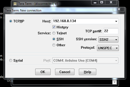

Step 4: Connecting Remotely

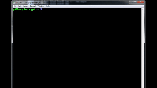

Type in the “name” and “password” (Fig.7.b) and afterwards a successful connection with the Kenji-X1’s onboard SBC aka (Raspberry-Pi) will be established (Fig.8.b). Entering the username and password, will boot to Linux console (Fig.8.). From now on, you can do pretty much anything via onboard SBC of Kenji-X1.
We should establish one last communication node on Kenji-X1 to make interacting with the robot fully functional. In console (Fig.8.) type-in the command “sudo minicom” and hit enter. You will hear several high pitch sounds coming out from the Kenji-X1 and text appearing inside the shell. Congratulations (^_^) … now you gained access to roboDrive Engine. From this point and onward there will be active connection to all network nodes, unless you as a user decide to break them.

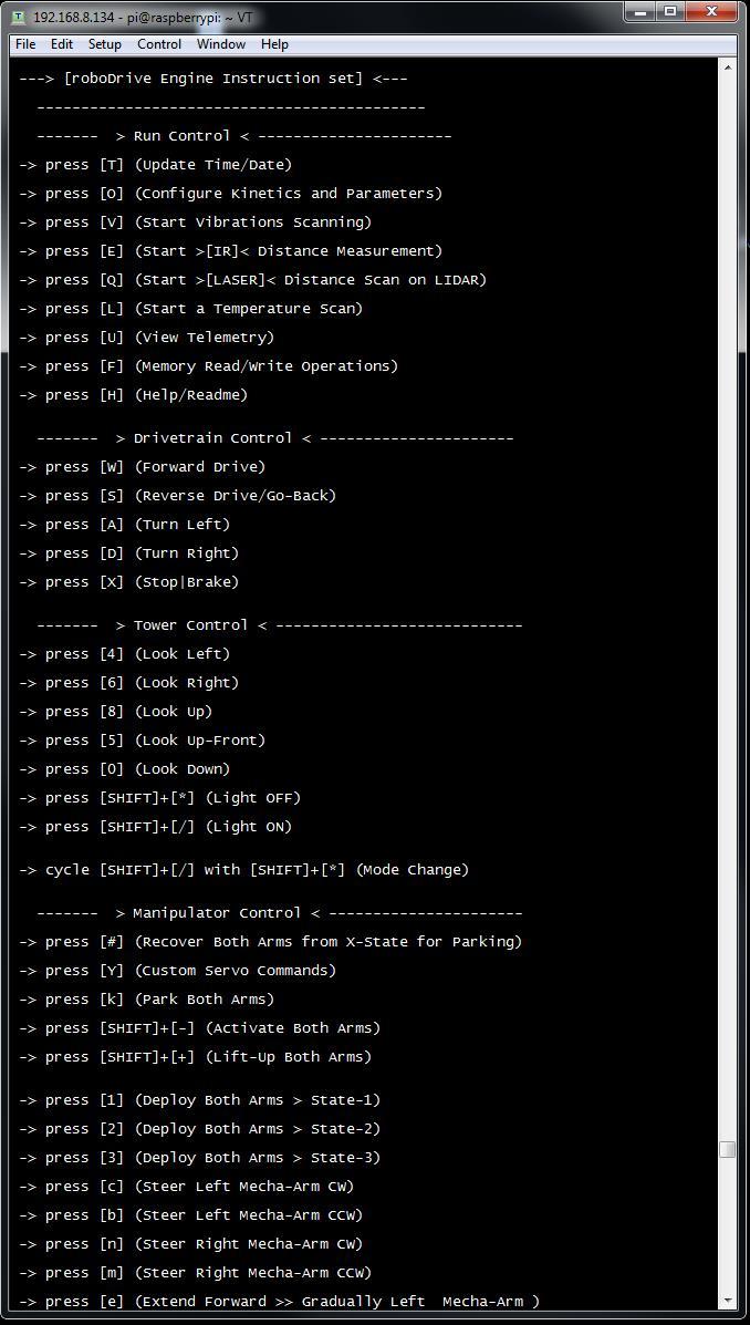

Let’s make ourselves familiar with some of the roboDrive Engine’s instructions set. To view the “help/readme” info in (Fig.9.) type-in capital letter “H”. In “Run Control” we can configure the platform kinetic parameters: ground speed, tower rotation speed and so on.
Let’s type-in capital letter “O” to enter the menu. The first thing you’re being asked to “enter the vehicle ground speed”,” enter tower rotation angular velocity”
and so on (Fig.10.) below.
Let’s enter all the needed kinetic parameters to the system as shown in (Fig.10): they take values in range (0 - 255). Here 0 represents the fastest and 255 is the slowest, we move across with 8-Bit range.

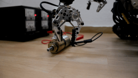

Step 7: Manipulator Control and Steering
It’s time to deploy the conductive-probe and connect to the DC-motor’s metallic frame. Therefore, I am sending command “V” from my remote PC to un-park Mecha-arms. It takes second or two, and now both mecha-arms are in un-parked position (state-2), which would fit the best for this task. Normally there are several states (1-4) available to the user on Kenji-X1, of course you can also code new ones as well.
Only un-parking and engaging manipulators don’t make a suitable contact with the DC-motor’s frame. I will switch from driving to manipulator steering control and try to steer around left/right up/down to make it work (Fig.14.). After several attempts, I managed to touch the frame of the DC-motor with the flat surface of the conductive-probes disc.
At this moment I have managed to get a contact with the
DC-motor. Now, I just apply minor corrections and fine-tune the probe position by slightly moving left to right. The mecha-arm is pushing already the conductive-probe against the DC-motor’s frame, so there is a proper connection made.
So far the surface to surface contact has been successfully
established. Now It’s time to request data from the conductive-probe and save it inside our onboard SBC’s memory card.

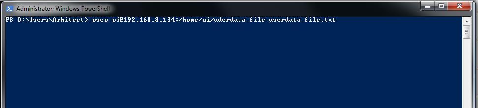

Let’s get that datafile transferred to our PC, where currently me, or you “Kenji-X1’s operator” residing now. On my PC, I can achieve that by typing a command inside windows PowerShell
“pscp user@192.168.8.134 : home/pi/userdata_file userdata_file.txt”
Please note you should enter the provided password for the Kenji-X1’s onboard SBC. The file will be copied to the “D:\Users\Arhitect” folder in my example, and on your PC, depending where your path is. In PowerShell, check it via “pwd” command where your path is.
Please install “putty” software for using “pscp” aka “putty secure copy” command and much more in PowerShell. https://documentation.help/PuTTY/pscp-usage.html
The file has been copied remotely to my PC and is located in directory “D:\Users\Arhitect”. Because we changed the working environment from Linux to Windows, if you open this text file, it will look “fuzzy” (^_^) (Fig.21.a.).

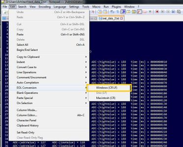

We should make an “EOL” correction for Windows machines.
In context-menu, click on “edit with Notepad++”, if you don’t have Notepad++, just get it from here https://notepad-plus-plus.org/downloads/ .
Changing the EOL conversion to Windows(CR LF).
Click to edit the file in Notepad++ and when its opened up, inside the program, go to “menu” then “edit” then “EOL Conversion” and hit “Windows(CR LF)” and save the file via “CTRL-S” and close the Notepad++. That way, we changed the “end of line” termination to the windows style. If we open the file now, it will look similar to (Fig.19.) data stream.

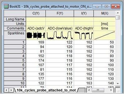

Step 12: Visualizing Measured Data
There is handful of ways to visualize measurement data, and they all are good in their own way of doing it. At the end of the day it’s up to you how you are visualizing your data. I have chosen OriginLab Pro. It is really great software which has been around since ages. Especially if you’ve worked with scientists, you might already come across, because it’s really popular in those circles.
We will start by running the software on PC and normally it will open up a new and empty book by default.
I will import the “userdata_file.txt” which we copied to my PC. OriginLab has an import wizard under the section “menu” then “File”. Start by clicking once on an empty data-book and make it active, then go to import and import the file as “single ASCII” or you can also try “import wizard” if you have issues importing data through “single ASCII”.
The “import wizard” gives you more options to manipulate and you can change things like the “delimiter” names, and more. You can try various scenarios to find the best options which will satisfy you the most. Eventually after successful import you can nearly see some tiny thumbnails at the top of each column we've imported.
Each column has its dedicated name in OriginLab-Pro software, so as seen in screenshots above the columns C(Y), F(Y), I(Y), M(X) are the 3 x amplitudes from our conductive-probe, and as you might still remember we are working in time domain and therefore the last one is the time.
You should explicitly tell the program which axes should be plotted as X-Axes and which ones as Y-Axes. I will tell the program to plot the dependency:
f([C(Y) F(Y) I(Y)],M(x))
Which means that “M(X)”dataset, which has all the time values inside will be plotted as X-Axes and all others “C(Y), F(Y), I(Y)” which are holding the vibration waves amplitudes as Y-Axes. For better overview I will divide down the M(X) dataset by 1000 to get time in seconds. Otherwise the values of the X-Axes are too high. In total we plot 4 x datasets in one graph.
Step 13: Visualised Vibration Profile of the Running Brushed DC-motor
Finally, we have it … in (Fig.25.) we visualized the measurement data and created a beautiful and informative graph from it, which you can include in your semester work, or classwork. But along the way, we also learned a lot more, and now you can navigate ourselves with confidence in such complex interconnected systems and in between communicating nodes.
