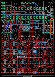

Step 2: The Circuit
The circuit is built mainly around the Arduino on a breadboard-circuit with regards to the crystal, ceramic capacitors and reset-resistor. It also uses I2C-communication with the display and a button-matrix for the keyboard. There are two ways to power the device: the first way is from the battery charging-board that is soldered to the PCB and is led through the switch. The other way is through the 6-pin jumper. These pins make it possible to upload code to the device without having to take out the IC and can also power the device. DO NOT turn on battery power while powering through these pins. Lastly, there is a single GPIO (pin 9~) that is programmable via BASIC.
There are two errors in the circuit! I have tried to mark these in the Eagle-files provided and, on the circuit.
  • Error 1 (Orange square on image): The shift key connected to resistor R8 has one button-pin connected to a GPIO on the IC and the other button-pin connected to a pull-down resistor (R8) but not connected to VCC, because I forgot. I shorted the resistor and used the ATmega’s input pull-up resistor instead. I have not fixed this since it is easy to just replace with a resistor with a very low resistance or a wire.
  • Error 2 (Blue arrows on image): For some reason, resistor R3 didn’t connect to the IC’s pin 13 (digital pin 7) on the PCB. I made a physical connection on the PCB and corrected the mistake in the files.
Step 3: The PCB
The PCB is 2-layered with a green solder mask and routed using the Auto Router. I blame the auto router for the aforementioned error 2 but I think it might have been my fault. Let’s pretend it was the auto router’s fault though. It is designed in Eagle and developed by JLC PCB. The buttons were soldered by hand with an iron and this was difficult but not impossible. There is a hole in the upper right corner to make it look like a key chain, but I could NEVER imagine carrying this with my keys. There are also two holes between the display and keyboard for mounting the battery.
On the back, I soldered the battery charging board with the USB port facing down. The board is not made for SMD soldering, but it works fine. There are also holes for mounting the display. The holes came with the library and are probably a good idea to use, although I have not used them yet.
