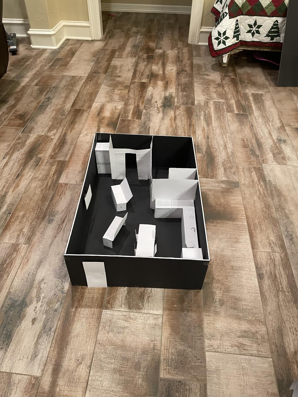

Step 3: Building the Outside Walls
To build my outside walls, I cut two 8 by 30 pieces of foam board, and two 8 by 20 pieces of foam board. This will make my model 8 inches tall, 30 inches wide, and 20 inches long. This translates to 8 feet tall, 30 feet wide, and 20 feet long in real life.
To put the walls together, I taped each one to the botttom floor, which is 20 inches by 30 inches. Then, I lifted each one up to tape it to the wall next to it. This created the floor and outer walls of my house.
Step 4: Make Bedroom and Closet
To make my bedroom and closet, I made a bedroom that is 14 inches by 8 inches, which is 112 square inches. After adding the closet, the bedroom was 97 square inches. I cut out a piece of poster paper that was 8 inches by 14 inches, and a piece that was 8 inches by 8 inches. I cut a 3 inch by 7 inch door out of the larger piece. Then I taped the two pieces together.
To make my closet, I cut out a piece that was 5 inches by 8 inches, and a piece that was 3 inches by 8 inches. I taped these two pieces together, then I taped the 3 inch side to the shorter bedroom wall.
I taped the whole thing to the outer wall, which made the bedroom and closet.
Step 5: Make Kitchen/Dining Area
To make the kitchen/dining area, I made a 2 inch by 3 inch by 7 inch rectangular prism and drew a oven and stove on it. Then I made a 2 inch by 3 inch by 11 inch rectangular prism and drew a sink and microwave on it. Finally, I made a 3 inch by 3 inch by 6 inch rectangular prism for a refrigerator.
To make a table, I cut legs and glued them to a rectanglular piece of paper. To make chairs, I drew a shape on a piece of paper, cut it out, and folded it. Picture 2 shows the shape, and picture 3 shows the finished chairs.
All the appliances and furniture in the model are made to scale based on measurements I took of my own appliances and furniture.
Step 6: Finish Up the House
After finishing the kitchen/dining area, I made a restroom that is 5 inches by 8 inches. The bathroom is 40 square inches. Then I made a stacked washer and dryer that is 4 inches by 4 inches by six inches. The washer and dryer take up 16 square inches. Then I added a 2 couches and a TV to the living area. The living area is 304 square inches.
Step 7: Done
The tiny house is now finished. It contains a 97 square foot bedroom, a 15 square foot closet, a 40 square foot bathroom, a washer and dryer that take up 16 square feet, a 128 square foot kitchen/dining area, and a 304 square foot living area. This adds up to 600 square feet. I hope y'all enjoyed this instructable.
