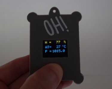

Tiny mdt is a small electronic gadget that measures environmental data and shows it on a small 0.96" OLED display.

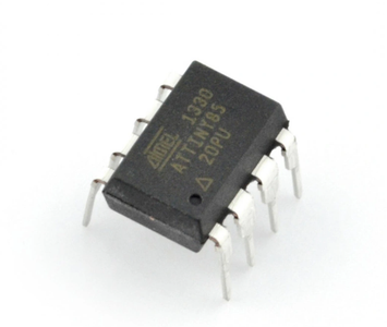

The data is acquired and processed by an ATtiny85 microcontroller.
The device is powered by a 3v CR2032 coin cell
the card only works when the power button is pressed and turns off when released.
So most of the time the device stays off, saving energy.
According to my calculations, with moderate use, the battery should last about 10-12 months.

This is a small portable weather station in the palm of your hand!
The board uses the excellent BME280 sensor which measures humidity, temperature and barometric pressure.

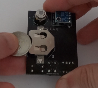

  1. Tiny mdt PCB.

  7. Attiny85 microcontroller (suggested: https://www.digikey.it/it/products/detail/microchip-technology/ATTINY85-20PU/735469

Step 1: Solder Components on PCB
It's a very simple and quick operation! Because the few components that make up the project are all through hole mounting!
Step 2: Load Software Into Attiny85 Microcontroller
Download the Arduino IDe Type1 (tiny_htt_o.ino) or Type2 (tiny_hpt_o.ino) attached code.
Load it into Attiny85 using the programmer you prefere.

Step 3: Insert Battery and Enjoy!
Don't forget that the card only works when the power button is pressed and turns off when released.
So most of the time the device stays off, saving energy!!!
