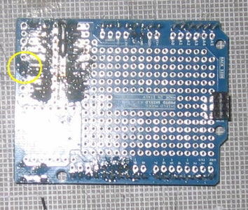

Begin by soldering the 20 Pin DIP socket into place on the Proto Shield, as in the 4th image.  Try to be neater about it that I was.  (I was reusing the shield from another project and had some solder bridges across connected perfs that took a while to clean out).  Make sure you don't bridge any adjacent perfs.
Next, add your hook-up wire as in the 5th and 6th images.  As I mentioned, I like to color-code things,  so red goes from pin 20 (Vcc) to the Arduino +5v, black goes from Pin 10 (Gnd on the 2313) to Arduino Gnd, Yellow goes from Pin 1 (Reset) to Arduino 10, green wires go from Pin 17 (MOSI) to Arduino 11, Pin 18 (MISO) to Arduino 12 and from Pin 19 (Serial Clock) to Arduino 13.  Also, hook up an extra black wire to the second open perf on pin 10 and run it to the outer unconnected perf hole adjacent to pin 5, leaving a little more lead than normal, but don't solder it in yet-just strip the end and run it through that hole.
Now we'll put the jumper, which is the two snap-off header pins, in at pin 4 (Gnd on the ATtiny 45/85) and to the outer unconnected perf hole adjacent to pin 4.  Insert the header pins so that the long metal ends stick upwards, not downwards through the board like the other stacking headers pre-attached to the board.  Solder the pin that attaches to the pin 4 trace first, then bend the ground wire sticking through the unconnected perf hole at pin 5 over to contact the remaining header-pin.  Solder these two together as in image 7.
Add the reset 10 Microfarad capacitor across the Arduino Reset and the remaining ground pin on that side, making sure to note the polarity ("-" to Gnd) as in image 8.  Use the heat sink between the board and the body of the cap so you don't fry it while soldering it.  (The smell of burnt electrolytics is just awful.)
