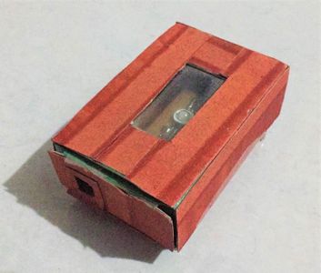

Step 9: Enclosure
Finally, to protect the PCB and other hardware, you can design your own enclosure.
Here I have used cardboard.
I have arranged a transparent dome structure found on Rotating Disco Lights available in the market. It has numerous cuts been made on the dome which disperses light in several directions. This added beauty to the lamplight.
