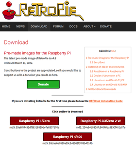

First, you can install RetroPie on the Raspberry Pi Zero using this link
https://retropie.org.uk/docs/First-Installation/
Then you can install GPIOnext following the instruction here
https://github.com/mholgatem/GPIOnext
