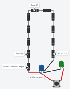

Step 2: Solar Cell With 7 Diodes (2V)
Following the drawing, it is very easy to mount a solar cell with 7 broken diodes that can generate over 2 V
Please pay attention to the diodes polarities when you begin to solder the device.
Step 3: Solar Cell With 10 Diodes (3V)
Following the drawing, it is very easy to mount a solar cell with 10 broken diodes that can generate over 3 V
Again, please pay attention to the diodes polarities when you begin to solder the device.

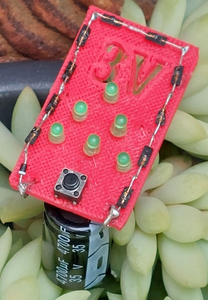

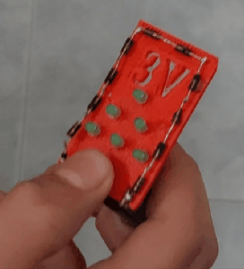

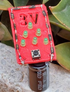

Step 4: Build a Tiny 3V Solar Cell
Taking into account the above steps, we can build a cool tiny solar cell to light 6 green leds.
It will use 10 diodes, a little switch and a 4700 microfarad capacitator.
The time to fully load it is about 20 minutes approximately when it exposes directly to the sun.
