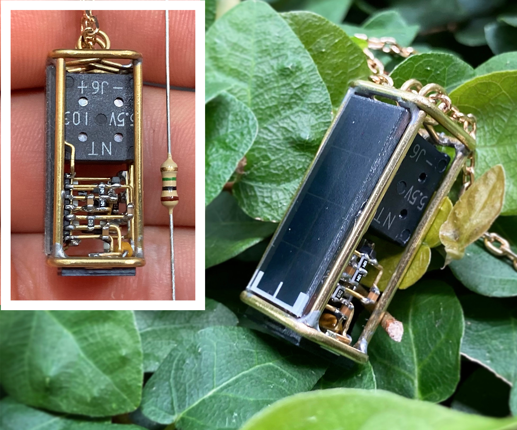

Step 2: Freeforming the Circuit 1: MCP112 190
We are going to start freeforming by building up a stack consisting of the 2 voltage monitors and 2 transistors. First is a voltage monitor and I bend up pin 1, or the output, to make contact with the gate of the transistor.
Step 3: Freeforming the Circuit 1.5: Gluing the Circuit Together
Next we must add the transistor. To make the final circuit more robust, but mostly to make soldering easier, I first glue the two packages together with some super glue. I do this for each sot23 part but will just show my set up this once. I use some blu tack to hold the base part in place and some tweezers to place the second part on top. the surfaces are super tiny so instead of trying to put a drop directly on the components, I squeeze glue out onto a piece of tape on my workspace and transfer just a dab of glue over with the tip of a skewer.
Superglue bonds break down with heat which was not a problem with soldering these sot23 packages but is definitely something to keep in mind.
Step 4: Freeforming the Circuit 2:
Once the two components are glued together, we can solder the bent up output of the voltage monitor to the gate, pin 1, of the transistor.
Finally we bend up the emitter, pin 2, of the transistor such that it can connect to the emitter of the second transistor.
Step 5: Freeforming the Circuit 3:
Continuing as before, I glue on another transistor and solder both pin emitters, pin 2, of each transistor.
Not shown, we also must bend up the gate of the second transistor to make contact with the output of the final voltage monitor.
Step 6: Freeforming the Circuit 4: Second MCP112 190
Finally for the sot23 components, we must glue on the final voltage monitor and solder its output to the gate of the previous transistor, pins 1 on each.
Then we bend up Vdd and Vss, pins 2 and 3, of the final voltage monitor, so that we can solder the capacitors and photodiodes on.
Step 7: Freeforming the Circuit 5: Capacitors
Next we add the capacitors to either side of the voltage monitors. Each capacitor connects to Vcc and Vdd, pins 2 and 3, of their respective voltage monitors.
I used the same super glue then solder trick for these capacitors but because they are much smaller the super glue broke down much more easily and it didn't work as well.
Step 8: Freeforming the Circuit 7: BAV70
Next we have to add the diodes. As mentioned in the component list, this could be done with and 2 general purpose smd diodes.
The legs of the BAV70 are not quite long enough to reach where they need to connect so I had to use some brass wire to connect them. The brass looks too thick in these photos but it is the thinnest brass wire I have at 0.020" (0.51mm)!
Little bit of a continuity error here in the last photo, the next step should be to connect the emitters of the transistors to the cathodes of the diodes to arrive at out final ground connection but I actually did this after I put on the photodiodes. Would have made more sense to do it here though.
Step 9: Freeforming the Circuit 8: Photodiodes
The final part of freeforming the brains is to add the eyes, 2 smd photodiodes. The cathode of each photodiode goes to Vdd, pin 3, of each voltage monitor.
Then I bent some more brass wire to connect the anodes and to form our positive connection point. I forgot to photograph anodes connected but you will see how it looks in the next steps.
Step 10: Freeforming the Circuit 9: Testing
Finally we can test the circuit and see if everything is connected properly. To do this we simply connect one side of the motor to the collector, pin 3, of one of the transistors and the other motor lead to our positive point. Then you can connect the positive and negative of the circuit to a large (1000uF+) capacitor slowly charging through a resistor. You can just connect the circuit to a power supply but doing it this way mimics the way our circuit will be connected eventually, to a capacitor charging via a solar panel.
When I first tested nothing was happening and I thought I screwed up! but turned out I just had my power supply set too low and light was hitting the wrong side of the circuit so it was trying to turn on the motor that wasn't there. Phew.
Step 11: Preparing the Motors
Next we can prepare the motors. Learning from my previous attempts at mini photovores I arrived at this set up for the motors. I cut some 3mm acrylic into a quarter circle shape and glued the motors onto it first to provide some structure.
For these particular vibration motors I also had to remove the minimal extra housing they had and the off-balance weight.
Step 12: Preliminary Layout
Now that we have all the parts I decided to try laying them out to see how to best continue. Using some blu tack to hold the capacitor I arrived at this layout. It covers the circuit a little but I think the final aesthetic is as balanced as it can be and it ended up being very mechanically solid too! In the end I was very happy with this solution despite it covering the circuit somewhat.
Step 13: Freeforming the Circuit 10: Connecting Positive to the Solar Panel
We can now start actually connecting everything together. To start with I cut and bent another section of brass to connect the circuit to the positive of the panel.
Step 14: Freeforming the Circuit 11: Motor Connections
Next I bent some more lengths of brass which will end up being the motor mounts. So they have to route from pins 3 of each transistor to some place near the positive of the solar panel.
Then I soldered the motors to these connections and the positive of the panel. This turned out to be a really great solution. It is simple, compact, and very solid.
In the final photo you can see how the brass connections we made have connected to the motor
Step 15: Freeforming the Circuit 12: Connecting Negative to the Solar Panel
A nice easy step here, just solder the negative of the circuit to the negative of the panel. At this point I also added the 3mm yellow led at the back to act as the rear "wheel". It doesn't do anything electrically, it is just there for mechanical reasons. This "wheel" only really works on smooth surfaces but it's not like this little guy will be able to handle rough terrain anyway ;).
Step 16: Freeforming the Circuit 13: Connecting the Storage Capacitor
Final component now! The capacitor! I soldered a length of brass wire to the anode of the capacitor (noted by the small nub), and then soldered it to the photopopper. It took quite a bit of heat to get the negatives connected and by the time it was all done I realised the capacitor had shifted a little so it probably would have been a good idea to set up some kind of jig for this step to keep everything aligned.
Step 17: Adding the "Wheels"
I got a little ahead of myself with excitement and did this step without taking a photograph because I was so keen to see if it would run. The problem with using motors like this is that there is not much grip, so to remedy that I stripped some breadboard wire and pushed the insulation onto the motor shafts.
The hard part about this is that every little bump at the tip of the wheel will make the bot jump and not move as well, so I spent some time after initial testing with a lighter and then an exacto blade, smoothing out the tip of the wheel. It still jumps sometimes but I like it, gives him a little extra character (not that it was ever in danger of lacking character!)
Step 18: Finished!
Look at that little cutie pie!
