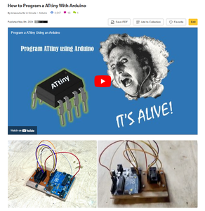

When I first started to investigate and learn how to program the ATtiny85 I was totally confused! The tutorials that I found on line didn't give a complete step by step guide and I had to work my way through a number of them to finally work out how to do it. Luckily for you I've recently put together an Instructable on exactly how to do this and it really isn't that hard.

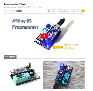

You will however need to get yourself an Arduino Nano which you'll use to program the ATtiny85. Again, I want to reiterate that this really isn't hard to do and if you follow the Instructable below you will be able to program your ATtiny85 with the Tetris sketch
How to Program ATtiny85 with an Arduino
I have also done an Instructable on building your own programmer for the ATtiny85. You can go all out and get a PCB printed or you can just breadboard the programmer.
Programmer for the ATtiny85

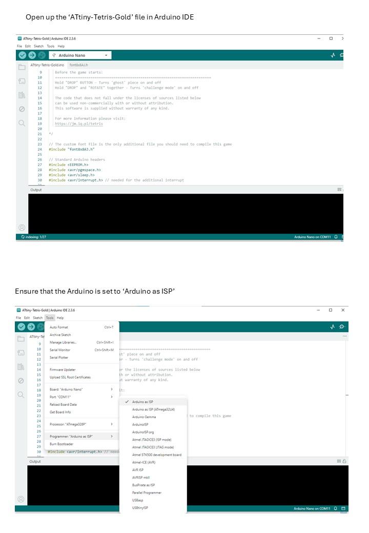

  1. Open up the 'ATtiny85-Tetris-Gold IDE file which will open it up in Arduino IDE
  2. Ensure that the Arduino is set as 'Arduino as ISP'

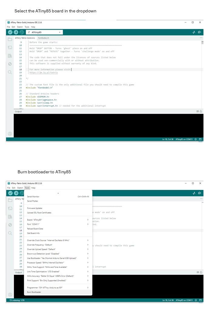

  3. Go to 'tools' and make sure that the processor speed is set to 8Mhz Internal Oscillator. Also change the Override Clock Source to 'Internal Oscillator 8Mhz'
  4. Now select the ATtiny85 in the dropdown and burn the bootloader

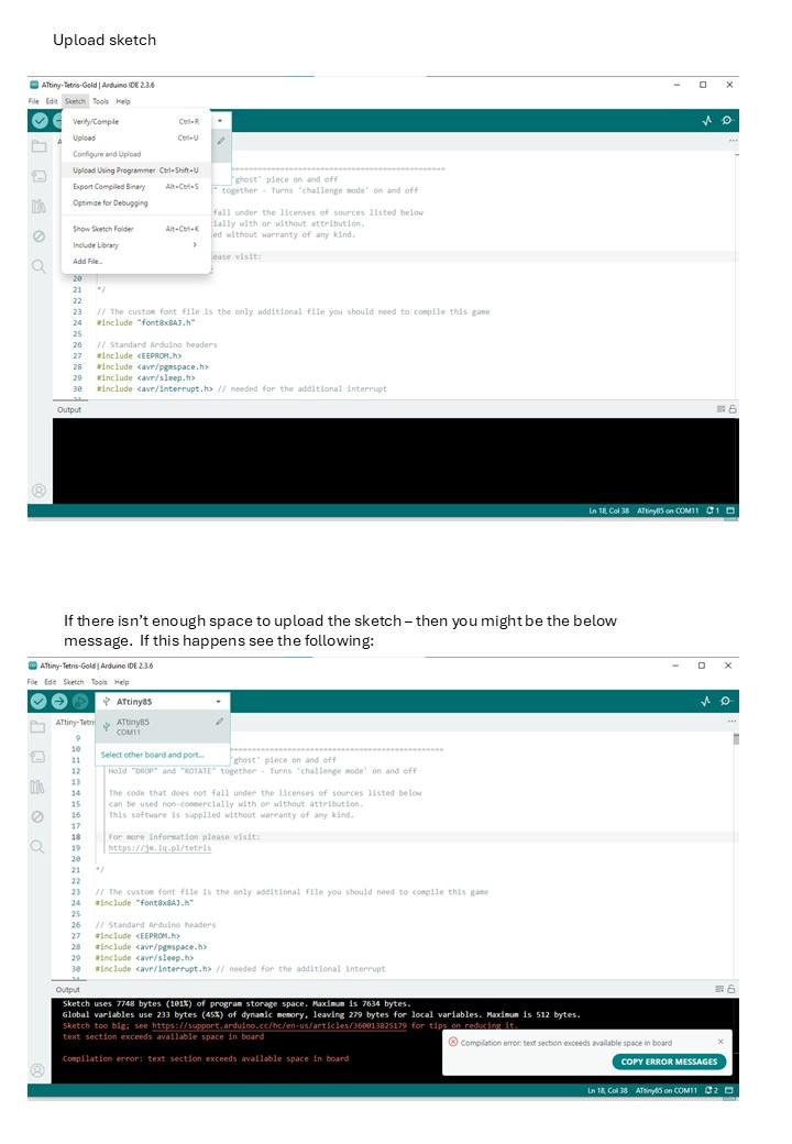

  5. You can now upload the sketch via 'upload Using Programmer'

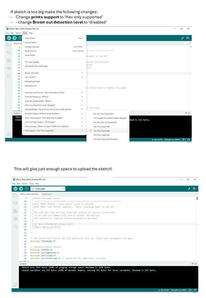

CAUTION!
  1. If you get a message that says that sketch is too big, then you will need to reduce the size of the sketch. You can do this by changing the following:
  2. Tools / Print Support / change to 'Hex Only Support'
  3. Tools / Brown Out Detection Level / change to 'Disabled'
  4. Now try again to load the sketch. It should be good now to load
