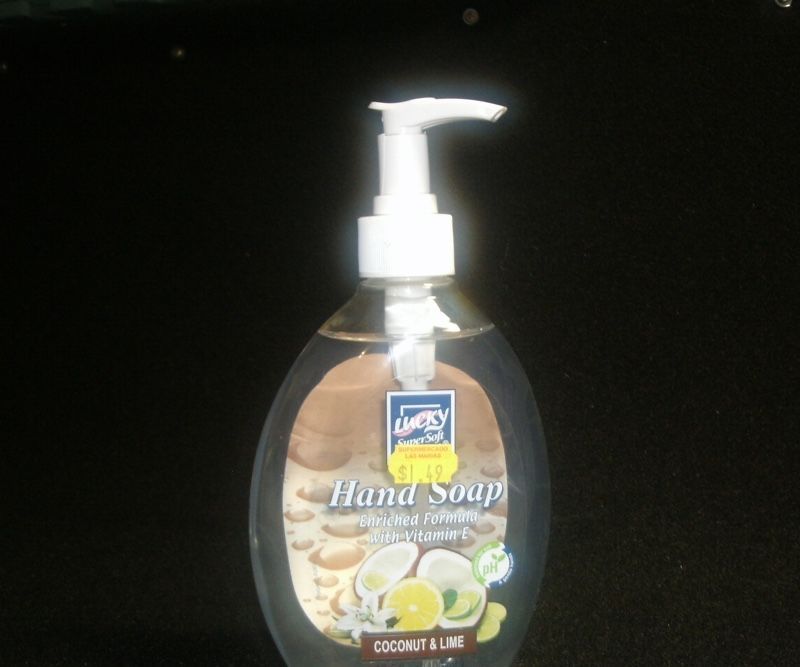

Sanding PVC reeds was a lot of work, so I experimented with clear plastic packaging material I found in the trash. It came in different thicknesses and with different degrees of rigidity. Thinner material makes reeds that are easier to play. Plastic reeds can be cut out of scavenged packing material with scissors.
For your first tootophone, I suggest you go the easy route and just cut a reed out of scavenged plastic packaging material. You can make mellower sounding reeds out of rubber, but it is more complicated, since you have to make the material. (I haven't found off-the-shelf sheet rubber material for reeds yet.)
