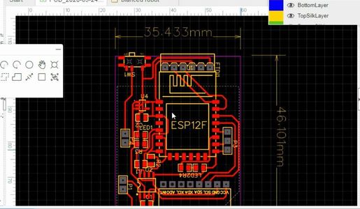

Step 2: PCB Design
I made the design of the PCB on the free software (EasyEda), its an great tool, allows to check you 3d PCB model.
you find all the require files about the PCB below.

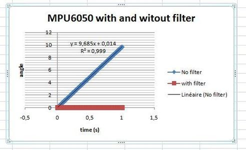

Step 3: Programming
I thought in the beging that the software will be the easiest part in this project, but sadly its not the case, i ran into a problem called the drift and to avoid this issues we need to combine our system with a complementary filter. for more infos about that check out the video below, and you find the link to the code there.
