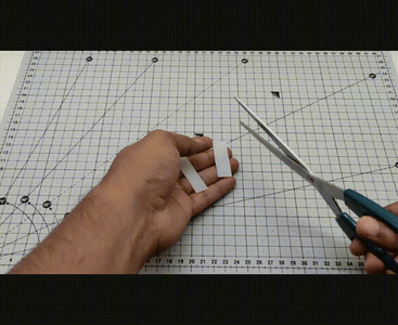

Step 2: Diffuser Plastic
  • Cut the diffuser plastic sheet with scissors for 40 x 14 x 1 mm

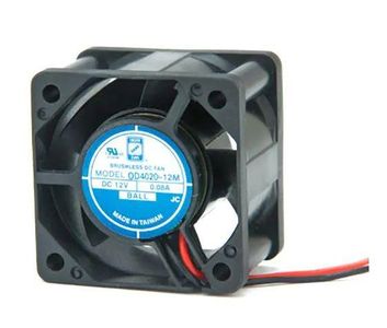

Step 3: DC FAN
  • A 12V High speed DC fan is used in the design, commonly these FANs are used in SMPS and server applications
  • 40x28 mm - 2 wire DC fan
  • DC FAN part number : OD4028-12HB
  • Similar DC fan with various CFM, RPM and dimensions are compatible with the design (For better results select power less than 6W)

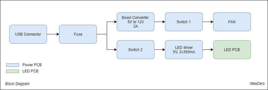

Step 4: Electronics
Two different custom designed PCBs are used in the setup:
  1. Power PCB (USB Input, Control and LED drive)
  2. LED PCB (White LEDs in parallel)
Schematic, BOM and Gerber files of the PCBs
Step 5: Power PCB
Notes:
  1. Verify the orientation of the push button relative to the image reference before assembly, as it is DPDT.
  2. The MEL7135 delivers a constant current of 350mA. The PCB allows for the installation of 2 ICs, depending on the desired brightness and number of LEDs. The number of ICs can be adjusted accordingly.

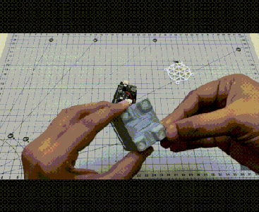

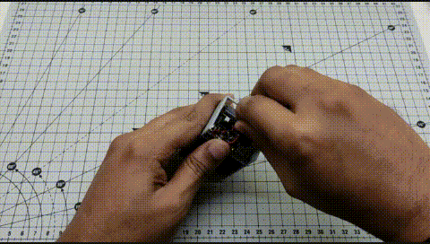

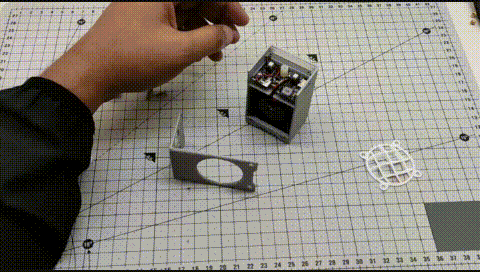

Step 8: PCB and 3D Part Assembly
  • M3 Brass inserts x 3 is installed to the 3D printed BODY
  • x2 on bottom
  • x1 on top for PCB
  • Insert the fan in the socket together with PCB and align it to the top mount hole and USB cutout
  • Add M3 Standoff to the PCB through the body
  • Slide the LED Diffuser plastic
  • Slide the LED PCB
Step 9: Enclosure Assembly
  • Assemble the CAPE part to the body
  • Fasten M3 x 10mm bolt to 3 brass insert sockets

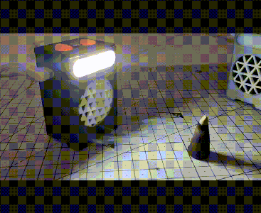

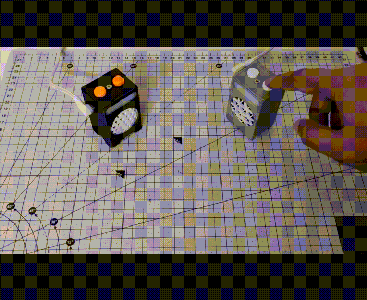

Step 10: In Action
Plug the USB cable and power ON to get the fumes out of your way
Incense stick smoke test for demonstration !!
Device is a bit loud due to the high RPM FAN, but works like a charm
