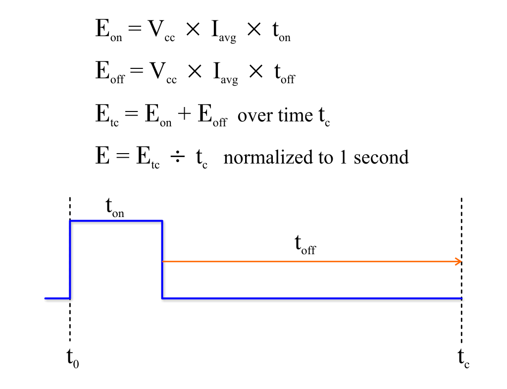

There are many ways to do this but we prefer to break it down to the basics and convert everything to energy. Electrical energy is measured in Joules (symbol J) and by definition:
A Joule is the energy dissipated as heat when an electric current of one amp passes through a resistance of one ohm for a period of one second.
Since energy (E) is also voltage (V) x charge (Q), we have:
E = V x Q
Q is Current (I) x time (T):
Q = I x T
So energy in Joules can be expressed as:
E = V x I x T
where V is the voltage, I is the current in Amps and T is the time in seconds.

To do this, we can say Tc is the cycle time for our measurements, ton the active time and toff the inactive time and rearrange our energy formulae as shown here:

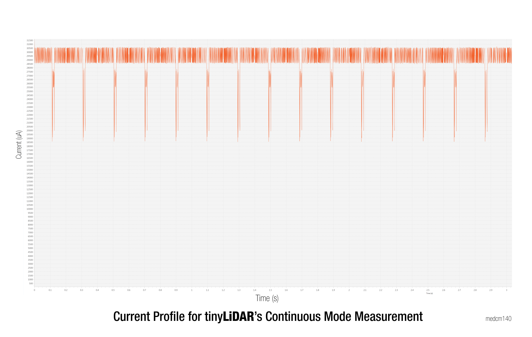

MC Mode
From the inception of tinyLiDAR, we were obsessed with trying to get faster measurements from the VL53 ToF sensor. So we optimized our firmware to get the fastest and most consistent streaming data from it. This involved introducing buffering. A little buffering is a good thing since it allows the host controller (i.e. Arduino) to get its measurement data in a flash and move on to more important things. Therefore buffering is absolutely necessary and due to this we are able to achieve streaming rates in excess of 900Hz even on the relatively slow Arduino UNO. Hence, the fastest response time will be in using tinyLiDAR's MC or "continuous" mode.
BTW, if you ever get a chance, you should connect a serial cable to the TTY output pin on tinyLiDAR and you will see what this MC mode does. It literally takes a measurement as fast as it possibly can and in doing so, it fills up it's I2C buffer with the absolute latest data. Unfortunately, since it's running at full speed, it is also burning the max amount of power. See below for the current vs time graph of this MC mode.

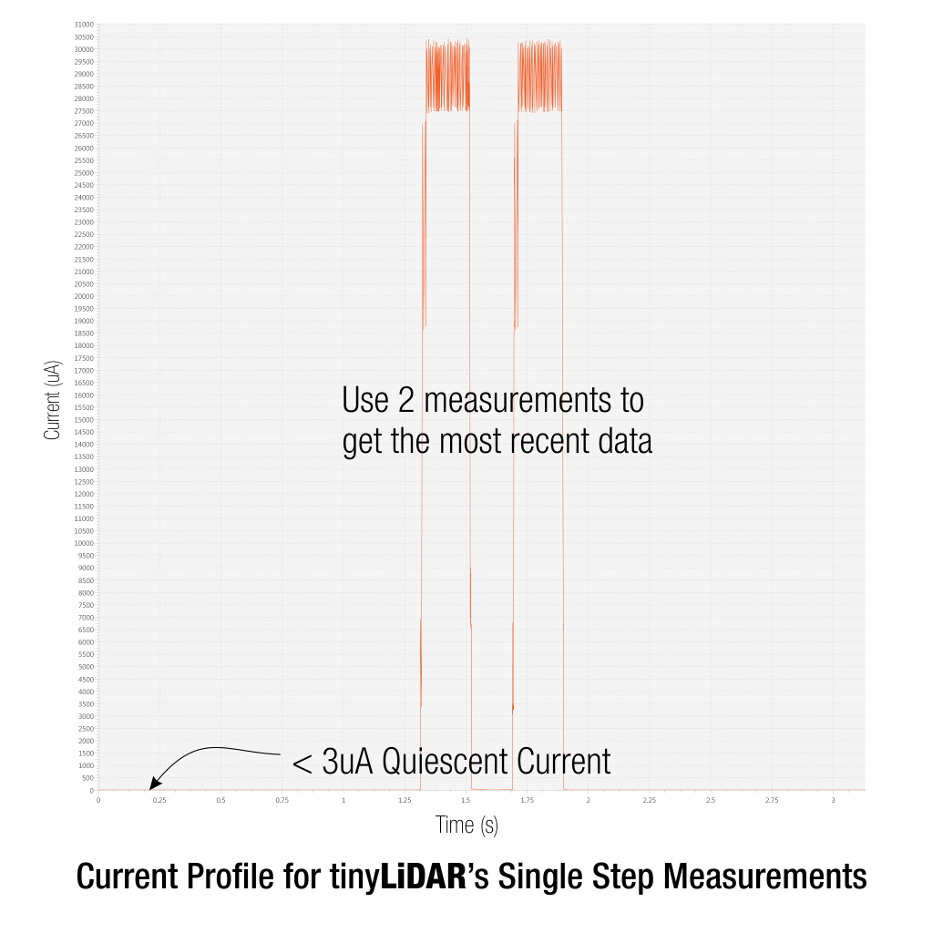

SS Mode
The next mode is what we call "SS" for "single step" mode. This is basically the same high performance mode above but in a single stepping loop instead. So you can get fast responses from tinyLiDAR but data will be from the previous sample so you will have to take two measurements to get the very latest data. See below for the current vs time graph of this SS mode.

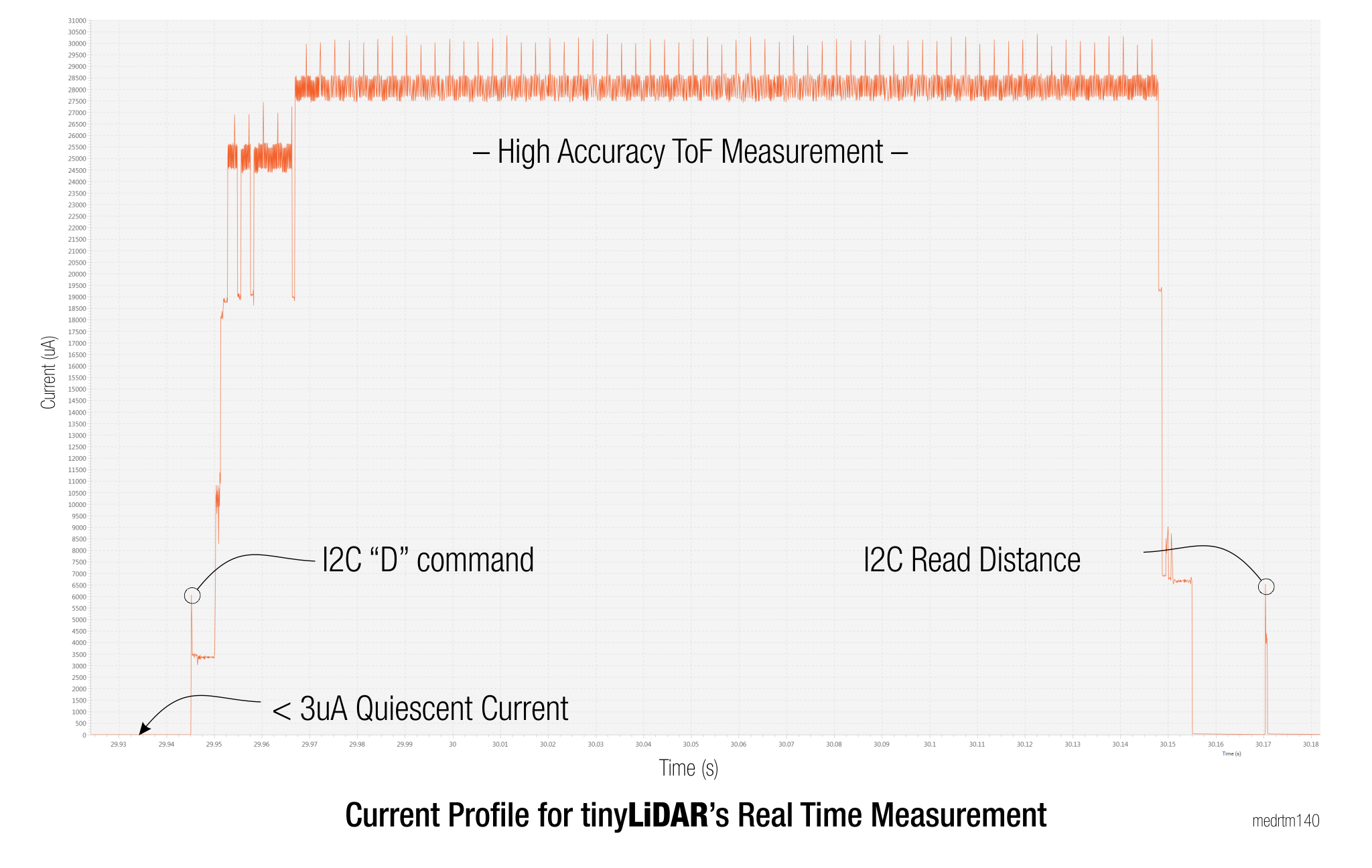

Happily, we can now say that we have a solution for this scenario as of firmware 1.4.0. It's called the "RT" mode for "real time" measurements. And it basically implements a trigger, wait and read method. To use it, you can still just issue the "D" command to start the measurement, but for this RT mode you must wait an appropriate amount of time for the measurement to finish and then read the results. tinyLiDAR automatically goes to its lowest quiescent state of sub 3uA in-between samples. It's actually still simple to use and even more energy efficient now since you only have to take one measurement instead of two to get the very latest data, i.e. zero buffering.
See below for the current vs time graph of this new RT mode.
Step 3: Actual Measurements
Using the MC continuous mode for infrequent IoT measurements makes little sense since we only need single measurements. Hence we can focus our attention to the SS and RT modes instead. Operating tinyLiDAR from a regulated supply of +2.8v provides us with the lowest power dissipation. So in using the High Accuracy (200ms) presets, we measured the following energy consumption on tinyLiDAR:
SS/single-step mode: 31.2 mJ averaged over 2 measurements
RT/real-time mode: 15.5mJ averaged over 1 measurement

Normalizing to Tc
E = (Eon + Eoff )/Tc
= (31.164mJ + 4.872uJ)/1
= 31.169mJ or 31.2mJ per second
