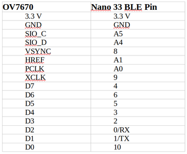

The OV7670 camera needs to be connected to the Arduino Nano 33 BLE. Refer to a previous project for full details
https://www.hackster.io/umpheki/ov7670-camera-and-image-sensor-with-nano-33-ble-497c5f
Also, Edge Impulse help documentation has an article on how to do this
https://docs.edgeimpulse.com/docs/development-platforms/officially-supported-mcu-targets/arduino-nano-33-ble-sense#connecting-an-off-the-shelf-ov7675-camera-module
Connection between the Nano and OV7670 as per the table
There are two options for completing the connection: breadboard or perf board.
Picture included of the completed breadboard option
As a more robust alternative, you can use perf board, wires and headers to solder a mounting board. Included are some pictures of the finished product:
Once connected, test the camera to make sure that it is taking pictures and transmitting images, before starting the rest of this project.

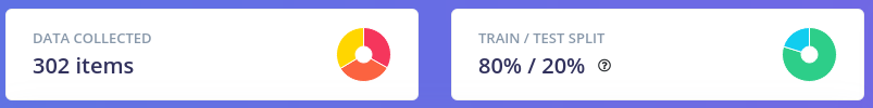

Step 4: Gathering Image Data
You are now ready to start collecting image data for your project. Select objects that the final project will recognize once the completed firmware is deployed. Try objects that have different colors and contrasts. Limit the number of objects to three or four.
On the Edge Impulse left menu, select Data Acquisition
If all is connected correctly, there will be a Collect Data window in Edge Impulse. Select Camera (160x120) from the sensor list and type in a label describing the current object. A preview of what the camera is seeing will show up.
You can now start taking images of the objects you have chosen for recognition by using the Start Sampling button.
Take multiple pictures of the objects, varying angle, distance from camera, attitude, lighting and other variables such no two pictures are the same.
Change the label for different types of objects and make sure the images are split 80% / 20% between training and test
Examples of data used in the project included.

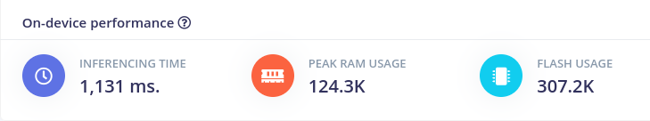

Take note of the On device performance metric. This is the amount of time the target device (in this case Nano 33 BLE) will take to take the incoming data (160 x 120 picture with RGB representation) and convert it to the neural network input (96x96 greyscale picture)

Training takes some time but once complete some important information is displayed
  1. Model Accuracy – this must be close to 100% if possible
  2. Confusion matrix – how many samples were mis classified
  3. On Device performance – an estimate of how long an inferencing cycle will take on the target device and how much RAM is required to carry out the inferencing
In the case of the Nano 33 BLE, max RAM capacity is 256 K. The amount of RAM reported in transfer learning is for inferencing only (arena), it does not include other variables and image buffers. So any value over about 180 K RAM will not work once the model is deployed to the Nano.

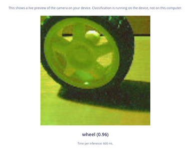

  8. From a command prompt run the Edge Impulse CLI command edge-impulse-run-impulse – debug
  9. This will start a inferencing session on the Nano 33 BLE and the results will print out on the command prompt screen
$edge-impulse-run-impulse
If you want to see a feed of the camera and live classification in your browser, use the address shown on the command prompt screen (typically 192.168.12.49:4915).

For the three objects used in this project, accuracies of above 0.9 were achieved. No bad for the limited training set running on a micro controller with a $5 camera.
