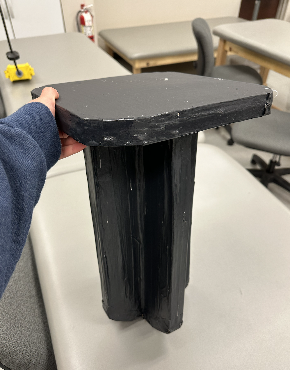

This is a stool made from tri-wall cardboard. The bottom is curved to allow for some rocking. These stools are used in classrooms for students who need some sensory stimulation.
The dimensions I provide in this Instructable are what I use in my class. They should be modified for the person who will be using the stool.

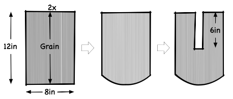

Step 1: Measure and Cut First Stool Support
1. Cut two support pieces
2. Glue the support pieces together with white glue
3. Cut a curve at the bottom of the combined piece
4. Cut a notch at the bottom of the combined piece that is as wide as two pieces of tri-wall stuck together

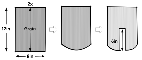

Step 2: Measure and Cut Second Stool Support
4. Cut a notch at the top of the combined piece that is as wide as two pieces of tri-wall stuck together

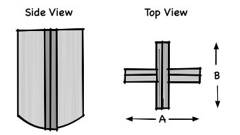

Step 3: Assemble Stool Support
Slide the two sets of support pieces together

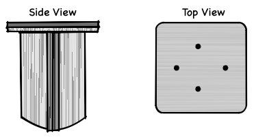

Step 4: Measure and Cut Seat
1. Cut two seat pieces
2. Cut a cross-shaped hole that fits the stool support in one piece

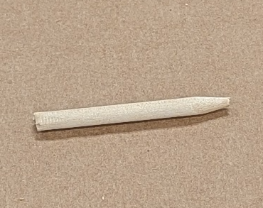

3. Punch holes for nails
4. Glue the pieces together with white glue
4. Round the corners of the combined piece
Step 5: Assemble Stool
1. Connect the top piece with the support pieces
2. Add nails
Step 6: Edging
You need to seal off the edges to help keep water out. I use gummed packing tape. You can look at this video from the Adaptive Design AssociationYouTube channel
Step 7: Finishing
To finish the footrest, you need to apply primer, paint and polyurethane. I use water-based products to make clean-up easier.
