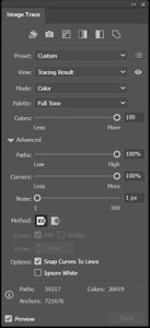

If you plan on using photography as part of your design, it is highly recommended that you vectorize your image. Vectorizing an image means that the pixel color information is converted into simple geometric shapes. If you don’t wish to vectorize your photography, please be aware that raster images may result in artwork that looks pixelated or distorted.
In Inkscape, this can be done by selecting your photograph and clicking Path -> Trace Bitmap
In Illustrator, this can be done by selecting your photograph and clicking ‘Image Trace’ at the top of the screen.
