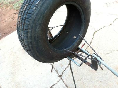

Step 2: Engineering It
The hook on the left side just hooks inside the bead of the tire.
The hook on the right is attached to a handle.
The handle pulls the hook, spreading the tire, extending on an arc, until it goes past center and locks the hook, holding the tire wide open.
Step 3: Finished Product
Cost = $0
Time to build = 2 to 3 hours
It is light enough to store about anywhere and carry anywhere.
It is strong enough to do the job.
