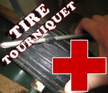

Step 3: Wrap Tire
Depending on your yard equipment, you may need to remove the wheel from the equipment. Removal was not necessary from my wheel barrow.
- Wrap your strap around the circumference of the tire.
- Be sure the strap is around the centerline of the tire.
- Fasten the buckle and pull strap tight to a snug fitting so the strap does not slide from the centerline of the tire.
Step 4: Apply Tension
Now we want to establish a seal between the tire and rim/wheel.
- Insert screwdriver between strap and tire.
- Turn screwdriver to twist the strap.
- Twisting of the strap will shorten the strap enough to compress the tire to the rim and make a workable seal.
- Check to see that a seal has been made between tire and rim. Or at the very least tire is touching rim at all points.
Step 5: Inflate Tire
Establish a good seal between tire and rim.
- With one hand hold the tourniquet tool in place firmly.
- With the other hand inflate the tire with your air compressor with a couple short bursts of air.
You only want to put enough air in the tire to establish the seal between tire and rim to hold the air in. If you put too much air in, there is a chance you will not be able to remove the strap or the strap might snap. Or worse yet you lose grip on the screwdriver and it goes spinning.
NOTE: Hold that tourniquet tightly with your hand. If not, when that tire expands with inflation the screwdriver can go spinning and send you a message through your knuckles. OUCH!
Step 6: Remove Strap and Inflate
Now that you have enough air in the tire to create a seal remove your screwdriver and strap. Inflate tire to the desired PSI which should be labeled on the side of the tire.
You are Done!
