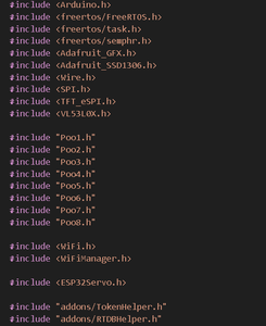

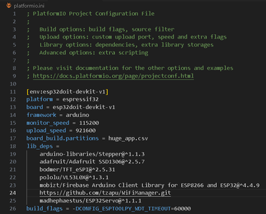

Thhis is our main code for the program. Firstly we would need to setup some libraries for our program. In this code, there are several libraries included in our program which are:
  • Servo motor library
  • TFT SPI library
  • Firebase library
  • TOF sensor library
Afterwards we would need to include the libraries in our program.

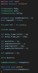

We then would need to add our animation GIF files into the include file in the project file directory. These include files are .h type of files and as of the current project, there are 8 different types of frames for the animation for the LCD display. After that, we declare some of the variables that is needed for our program to run. Since we are using a MOSFET, we would need to use PWM controlled from the GPIO pin of the ESP for the DC motor, in this case we are not using any driver for any motor. We would also need to declare the variables for the capacitive touch sensor, the servo motor and firebase connections.

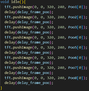

We need to configure a certain function for the display animation. There are currently 8 picture frames that will be played for the animation. In the function we will need to "push" the image to the TFT LCD Display and then give a delay for 1.5 seconds to move to the next frame to be played.

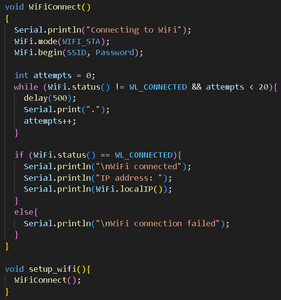

Afterwards we declare another function for the Wi-Fi connection. The Wi-Fi connection will connect to the targeted SSID and Password which is declared within the code. The non dependent Wi-Fi connection task is used so that the program can run with or without the any Wi-Fi connection. However the drawbacks to when the device is not connected to Wi-Fi is that it cannot send the width data from the TOF sensor to the Firebase. If the connection from Wi-Fi is lost, it will directly reconnect back within half of a second. In this code, I also provided alternative method for connecting to the Wi-Fi using a Wi-Fi manager. Users may suit themselves which one is more preferable.

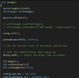

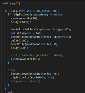

In the void setup, it is used to setup the Wi-Fi connection and firebase connection. We would also need to setup the RTOS task for the TOF and LCD so that they can run each of their own program at the same time. Then we would declare the activation of PWM for the DC motor, the servo motor and the capacitive touch sensor.

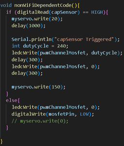

In the void loop. It is the logic for when the capacitive touch sensor is touched then the servo motor will move to open the gripper and then rotates the DC motor to roll the tissue and close the servo motor to hold the tissue.

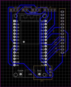

Step 4: Schematic & PCB Making
For the schematic and PCB design. We attempt to make it as small as we could so that it would not take any bigger space for the hardware. The power supply is directly connected to the ESP, we are using micro USB cable connected to the ESP. However it needs to have a supply to drive of a minimum 5 volt and 1 Amps. For the rest of the design PCB, you can follow the from the above design.
