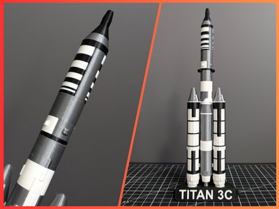

Here's a guide to printing my model of the Titan 3C
In this guide you will be guided through the correct positioning of the parts on the board, the settings in the Slicer and the assembly of the model.

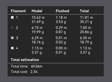

Filament
  • White Filament (10m-32g)
  • Black Filament (7m-20g)
  • WarmWhite Filament (2m-4g)
  • Metal Filament (7m-16g)
