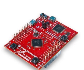

  • Tiva C LaunchPad (TM4C123)

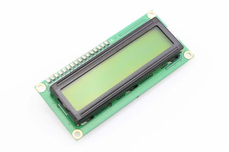

  • 16x2 LCD Display

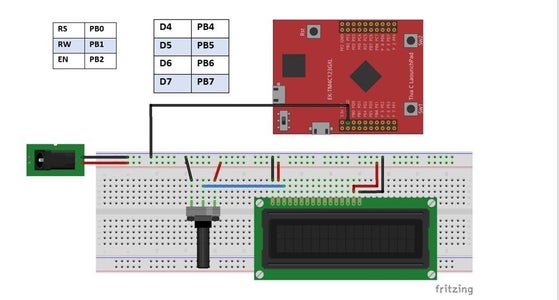

Step 3: Schematic of the Circuit

Step 5: Notes
  • volatile keyword should be included in your code with variable value can be changed any time such as the counter of for loop
  • 5v Power supply is important for LCD display (without it, your LCD does not work correctly)
  • Adjust the potentiometer if LCD does not display any data.
