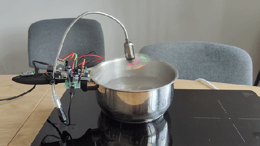

When preparing the lunch, everyone has probably encountered the moment when you let the pan on the fire and the water or milk start boiling and coming out of the pan.
To prevent it you could set the fire lower but that is no fun, let me introduce you the overengineered way:
  1. Take an Arduino board and an accelerometer
  2. Use Embedded AI to detect when the water is boiling thanks to the vibration
  3. Start a fan to blow on the pan to prevent the water from coming out of the pan
Pretty simple right :)

Step 1: SETUP
First, we need to connect the accelerometer to the Arduino board.
Use jumper wires to connect:
  • VIN (mic) to 3.3V (board)
  • GND to one of the GND on the board
  • SDA to SDA
  • SCL to SCL
Then we replicate this mintage: https://adam-meyer.com/arduino/images/2011/03/tip120-lightbulb1.png
(link to the tutorial: https://adam-meyer.com/arduino/TIP120)
The goal of the TIP120 transistor is to be controlled as a switch. Logical 1 outputted by Arduino pin should power on the Fan and logical 0 should stop it. Here we use the A0 pin with the resistor (look at the orange wire in the pictures).
Then you can fix the setup on the pan with hot glue and you need to find a way to fix the fan. I used plastic clamps (serflex).

Additionally I added some printing on the Led matrix and started a fan when the boiling class is detected to prevent the water from leaking out of the pan.

We also use a fan to blow on the pan when the water is boiling, to do so, here is what you need to do:
void setup{
//some code
pinMode(A0, OUTPUT); //A0 is our pin, you can change it if you use another pin
void loop{
// if you want to turn the fan on
digitalWrite(A0, HIGH);
// if you want to stop it
digitalWrite(A0, LOW);
In our case, we turn the fan ON/OFF in the switch case after neai_classification()
If you use everything explained here you will end up exactly with the main code attached!
