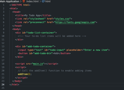

Step 2: Coding the HTML
Now that we have the appropriate files structure for out project we should start coding our html.
<!DOCTYPE html>
<html>
 <head>
  <title>My Todo App</title>
  <link rel="stylesheet" href="styles.css">
  <link rel="preconnect" href="https://fonts.googleapis.com">
 </head>
 <body>
  <div id="todo-list-container">
   <!-- Your to-do list items will be added here -->
  </div>
  <div id="add-todo-container">
   <input type="text" id="todo-input" placeholder="Enter a new item">
   <button id="add-todo-btn">Add</button>
  </div>
  <script src="main.js"></script>
  <script>
   // Call the addItem() function to enable adding items
   addItem();
  </script>
 </body>
</html>
This code will be the starting point for all of our code in the future. This code has makes the box where we can enter the contents of our to do list and the enter button to confirm what we would like in the text field. It also allows our HTML, CSS and Javascript to speak to each other. Right now our website may look to you as "not attractive" but we are going to change that.
