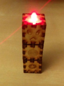

My idea is to make a totem like toy (ToYeM). You can rotate each block and it can emmit light. When the blocks are alligned the right way the light will turn on.

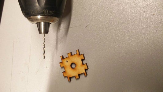

Step 3: Drilling the Holes
You need a small drill to make some holes in the top and bottom parts of the cubes.
We need to make 4 holes in total.
- Top part of the bottom cube.
- Bottom part of the middle cube.
- Top part of the middle cube.
- Bottom part of the top cube.

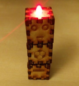

Because we want to rotate the ToYeM and have all cube faces facing the same way we cant just drill all the holes in the same corner. The bottom parts of the cubes are upside down so to match the holes we need to drill them in a different corner (not the opposite corner). Look at picture 3.
After you drilled the holes you end up with something like this. Look at fourth picture.

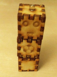

To connect all the cubes together we begin with the first connection. That is the top and the middle cube.
To make 1 of the connections we need:
- 1 nut
- 1 bolt
- 2 ring terminals
- 1 plastic O-ring
- 2 parts of the cube, 1 top and 1 bottom part (make sure the 2 pieces of tape line up)
- We start with the bolt and put 1 of the ring terminals over it.
- Now we put the 2 pieces of the cube over the bolt with the plastic O-ring inbetween. Make sure that the 2 pieces of tape line up.
- Now we get the other ring terminal and put it over the bolt.
- And we finish with 1 of the nuts to hold everything together.
- If the nuts get loose ver quickly after a couple rotations get some glue and glue the nut to the bolt.
Repeat these steps again to make the second connection.

- Test wich side is the + and - just to make sure we connect the battery the right way. To test this get the to wires that you just connected and hold 1 of them to the + side of the battery and the other wire to the - side. If the LED turns on you know how the battery has to be connected. If not turn the battery around. Now it should turn on the LED. Make sure that the electrical tape parts are touching (rotated the correct way).

You can now start playing with your awesome self made ToYeM. Turn the cubes and see how the light turns on only when the ToYeM is rotated in the correct state.
