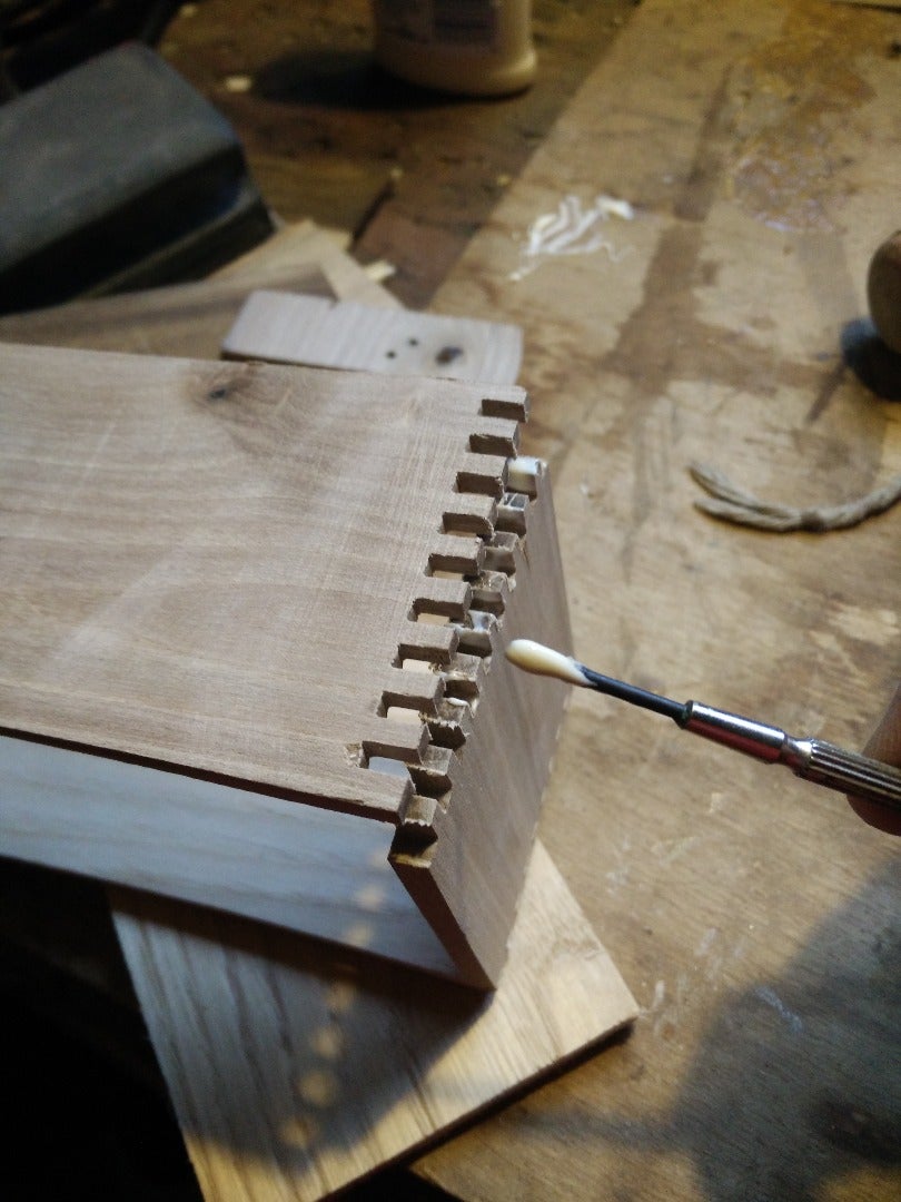

Step 2: Joints
I made the joints as explained in Linn's instructables. Credit goes to her and this is where you should go for instructions.
I made the joints as small as I could, that is the thickness of my granddad's circular saw blade : 2,5 mm.

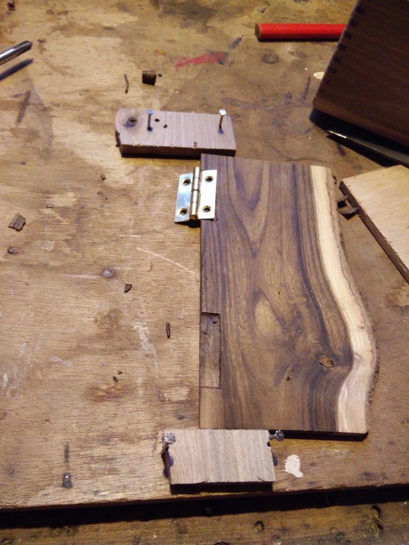

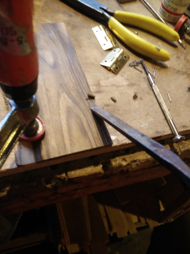

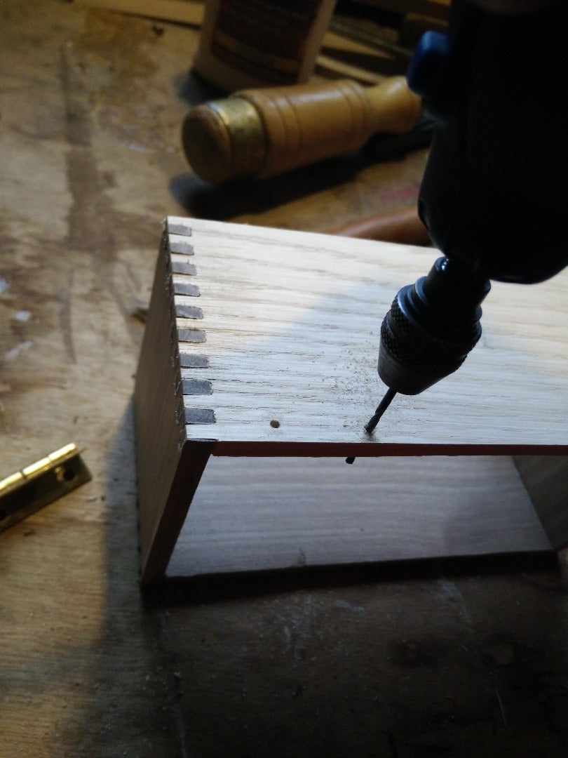

I first pre-drilled the holes for screwing the hinges so the wood wouldn't be split. I then marked where the hinges would be on the lid and chiseled a notch out so the brass and wood would be flush.

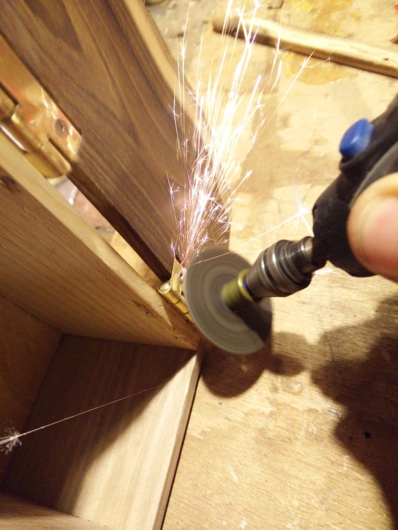

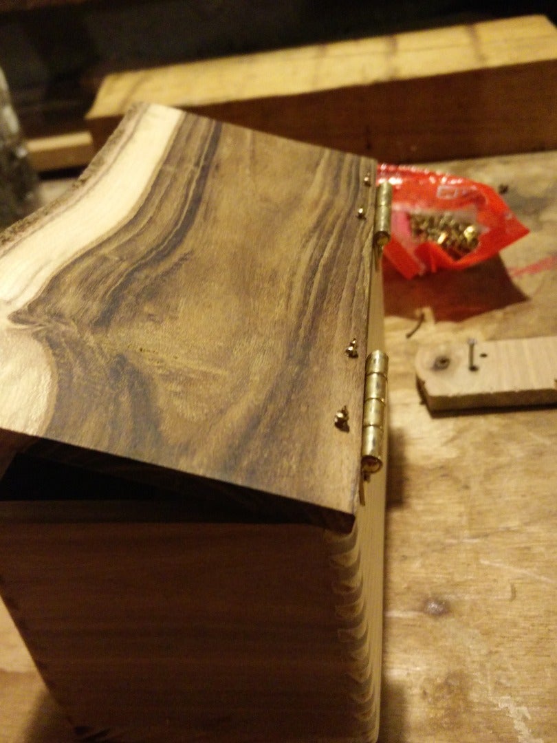

My screws were too long but I knew they would be all along so I decided that I would cut the extra bit and flatten it into a nice metal circle on my lid. I think it gives it a nice look, to have a little bit of metal showing there.
Until the lid was firmly set, I kept it a tad wider than needed to allow for the wiggling room and sanded it flush once attached.
