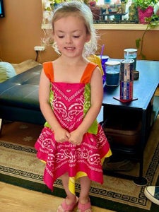

Introduction: Toddler Bandana Skirt and Top
Using five full sized bandanas, I made a skirt and top for my 3 year old granddaughter.

Step 7: Your Outfit Is Complete
I hope you like my granddaughter's outfit as much as she does!
