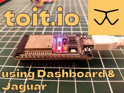

Introduction: Toit.io | IoT Platform Series #2
Hey, what's up, Guys! Akarsh here from CETech.
Today we are going to have a look at toit. A Tool through which, we can use a web dashboard and CLI to control and monitor an IoT Device (ESP32). Written in an IoT-specific language, toitlang.
Created by former Google Employees, Toit was a concept to make IoT Devices easily accessible, to monitor and control for enterprise uses. Simply secure the code on our ESP32 microcontrollers with lightweight containers and orchestrate them through our cloud API.
It uses sandbox containers, where our applications run isolated from the system, and each other, on the devices. Communicate with our cloud through a simple API (CLI), we take care of the rest.
