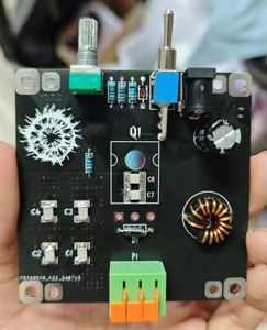

Step 4: Soldering Components
- Insert components into the circuit board according to their type (do not install the MOSFET yet). For easy soldering, you can slightly bend the pins to fix them. Note that **the fan connector should be mounted on the back of the PCB, and a light-emitting diode and 1k resistor should also be soldered on the coil bracket PCB**.
The installation positions of each component are shown in the table below.
 Component Name | Installation Position
1k resistor * 3  | R1, R4, coil bracket PCB
Light emitting diode | coil bracket PCB
3k resistor | R2
1.8k resistor | R3
Voltage regulator diode | D2
TVS (black)  | D1
Green terminal block | P1
White terminal block | Q3 (mounted on the back)
220uf electrolytic cap | C5
100pf capacitor * 4 | C1, C2, C3, C4
4.7nf capacitor * 2 | C6, C7
10uH inductor | L1
IRFP260 | Q1 (do not install this yet)
Switch
DC5525 black power jack
B1K single potentiometer
- It is recommended to solder the shorter components first, then the taller components, such as soldering the SMD capacitors, resistors, voltage regulators, terminal blocks, etc. first, and finally soldering the electrolytic capacitors and switch. If you have no soldering experience, be sure to search for soldering tutorials on Bilibili to learn first. According to historical statistics, 60% of people who had problems after making it were due to poor contact between components and PCB caused by not mastering the correct soldering method.
> Resistor identification
> - 1k resistor has a brown line
 > - 1.8k resistor has a brown line and a gray line
 > - 3k resistor has an orange line
 > If you really can't tell them apart, just measure with a multimeter ^_^
 > Capacitor identification
 > - 4.7nF capacitors are relatively thinner
 > - 220pF/100pF capacitors are relatively thicker
 > - For resonant capacitors, you can choose two 220pF or four 100pF
 > Diode direction identification
 > - The black TVS is non-directional
 > - The red voltage regulator diode needs to be directional, the black line on the voltregulator diode should match the white line position on the PCB silkscreen.age
 > Some friends may not know how to solder SMD components, you can search for SMD component soldering tutorials on Youtube to learn. Simply put, solder one side first to fix the SMD component, then solder the other side.
 >【How To Solder SMD Correctly - Part 1 /SMD Soldering Tutorial - Youtube】
 > Be sure to pay attention to the direction of the electrolytic capacitor, soldering it backwards may cause intense heating or even explosion. The longer leg of the electrolytic capacitor is the positive electrode, and the side with the stripe mark is the negative electrode. Please refer to the picture below to install the electrolytic capacitor correctly.
- When soldering, **be careful of the high temperature of the soldering iron to avoid burns.**
- After all components are soldered, cut off the pins. Please try to ensure that the solder joints are full and smooth, and start from the root when removing the pins.
