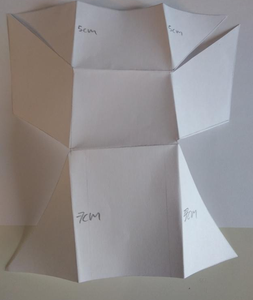

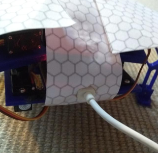

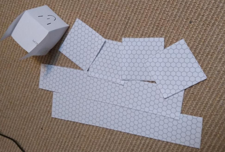

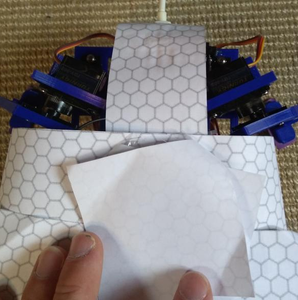

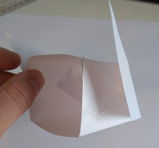

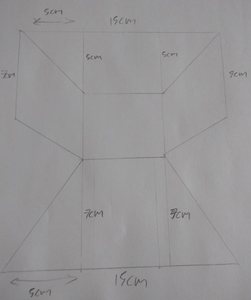

- Paper to make the shell

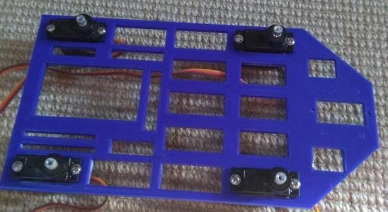

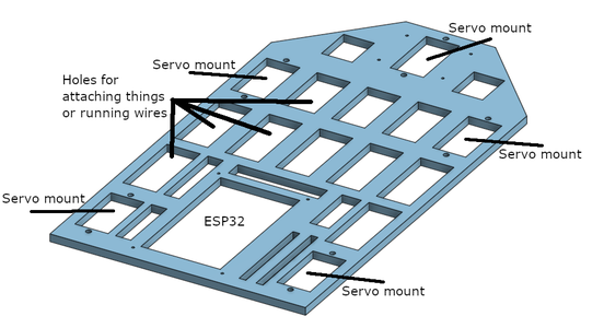

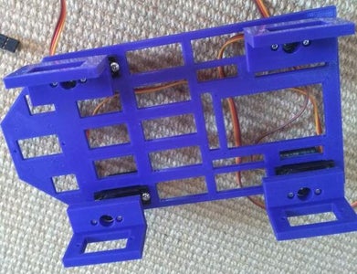

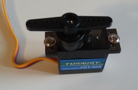

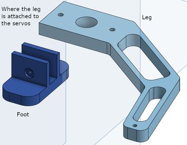

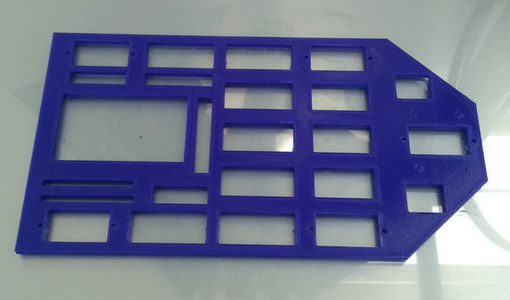

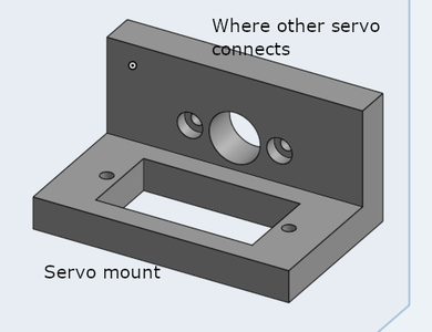

Step 1: Design the Parts
The last image is the servo. From this we can see that we have two mounting holes at the base of the servo, in addition we have a plastic piece on top of the servo that we will attach to.
The base plate has 4 servo mount holes at the edges, with one at the front. I originally added this front hole as a way of either attaching a servo for a head, or as another leg. Another leg would improve the stability of the bot, but I did not have enough servos for this. The holes for the screws here are 2mm, that being the correct size for the screws that came with the servos.
At the back there is one big hole where the ESP32 will be mounted, there are small holes at all 4 corners of this hole where the copper board will be mounted using small screws. These holes are 1mm, but would work better as 1.5mm in hindsight, this is because the plastic expansion from the print made the hole smaller than the designed hole.

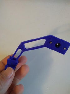

Step 2: Print the Parts
The parts were printed on a creality CR-10. The legs and feet took about 50 minutes each, the hip part took about 28 minutes each and the main body took just under 3 hours. On the hip and leg you can see the plastic piece that fits on top of the servos.
I screwed the foot and the leg together. I then added some double sided tape to the bottom, allowing me to add some rubber which should help with the grip on smooth surfaces.

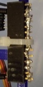

Step 3: Solder Headers Together
I apologise for the horrible soldering in advanced. This really could be improved, and adding a shrinkwrap over the top would prevent any shorts in the circuit.
In this step I soldered an 8 pin header and a 6 pin header together to make a 14 pin rail. I did this once again to make 2 rails. The rails let me connect all the servos to the batteries by connecting the battery to the rail, then the servos to the rail. This is repeated for the ground, the only difference is that the ground also attaches to the ESP32s ground as well as the battery ground.

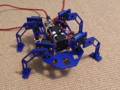

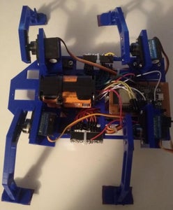

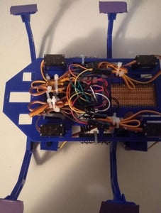

Step 4: Start Assembling the Bot
Assembling the bot was done in this order:

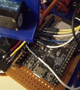

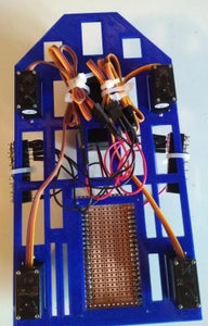

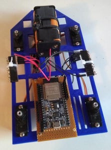

- Place the servos into the body of the bot and screw them in
- Place the ESP32 mounted on a copper stripboard onto the bot, this was then screwed in
- 4 AA batteries were zip tied to the frame of the bot. These will power the servos.
- The rails were zip tied on the side of the bot
- The servos were then connected into both rails, then after that, the GPIO pins of the ESP32. I stuck with the pins between 13 and 33. This is because 0-12 are used for specfic things, like outputting PWM signals on boot. The Pins 34-39 are input only, so you can't use them.
- I ziptied the cables onto the bottom of the bot, this is pretty ugly, but the servo cables are long, sothere isn't a nice way to do this.
You can see the holes I added to the bot have come in useful, we can run cables from the bottom to the top side of the bot. We can also zip tie stuff like the battery to the bot.

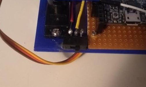

- I added a switch to the bot. This was wired between the battery positive and the positive rail, this let me control whether the servos were on or off. This was done using super glue in my case.
- The last image shows an oversight with the design. When the back left leg moves, it goes over the ESP32 and blocks some pins. I fixed this by bending the pins, but a better solution would be making the body wider so the hip doesn't go over the esp32

Step 6: Add Sticky Thing
I just chose 3M scotch packaging tape, I just cut a section off and wrapped it around until I had DIY double sided sticky tape.
All we need to do is belly flop the bot to pick things up and run off with. So this solution works great for us.

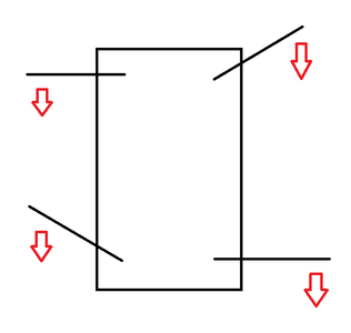

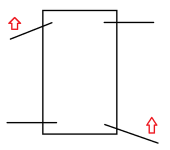

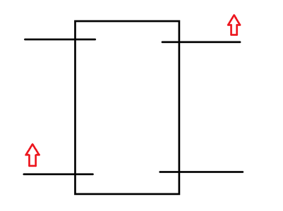

Step 7: Working Out Gaits

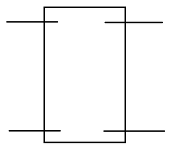

Gaits are very hard for quadrupeds, this is because unlike hexapods when they lift a leg they are unstable. Quadrupeds normally lift diagonal limbs, balancing on the other two limbs. However my bot only has two servos per leg, meaning that there is less control than a normal quadruped. Therefore we will only move one leg per time, this means the bot needs to be able to balance when only one leg is lifted.
The images show the gait the quadruped will use:
- It will move a diagonal pair of legs (Not at the same time).
- It will move all legs back, pushing the whole body forward. The first pair have returned to their starting position.
- It will reset the other diagonal leg pair which have moved back.
- It has now reset to the starting position
The reason we move the first pair is because if we don't, the bot is too front heavy when it moves all the legs back and cannot reset the legs. Therefore, the best way to maintain stability is to try and make sure at least one opposite pair is in the starting position.
This same procedure is followed for turning the bot. The only difference is that in the opposite pair, we move one leg forward and one leg back. Afterwards we turn the servos on one side one direction, and the servos on the otherside the other direction. This results in the bot turning it's body.

void turn_left(){
Serial.println("Turn left");
//Move right front leg back
move_motor_delay(4, 160);
move_motor_delay(0, 20);
move_motor_delay(4, 120);
//Move back left leg forward
move_motor_delay(7, 160);
move_motor_delay(3, 100);
move_motor_delay(7, 120);
//Move all legs
int end_pos[4] = {60, 100, 20, 60};
move_motors(end_pos, body_move_speed);
//Move front left leg forward
move_motor_delay(6, 160);
move_motor_delay(2, 60);
move_motor_delay(6, 120);
//Move back right leg forward
move_motor_delay(5, 160);
move_motor_delay(1, 60);
move_motor_delay(5, 120);
reset_servos();

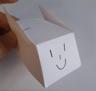

Step 11: Making the Head
The head was simple to make. I just cut out the shape from the first image and folded along the lines until it looked like image two. Then I stuck the top and bottom triangles together on each side, before sticking the middle panel back. This made some ears. Then I drew a face onto the head, making him look pretty happy!
Step 12: Making the Body
The body was made using two strips of paper, both 5cm x 26cm. In addition it used 4 7cm x 7cm squares. I chose a hex pattern, but any pattern would work.
I then taped the strips across the body and along the body, before taping the squares onto each corner of the bot. These squares were done like this so they didn't stop the movement of the legs. I also added a hole at the back so I could still connect the data cable.

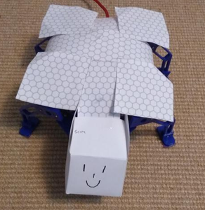

Step 13: Test the Bot With the Body Attached
The final step is to have a look at the bot picking up the paper with the body attached. This is the final product, it can move, albeit slowly and pick things up using it's sticky stomach!
