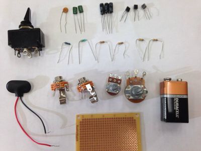

Step 1: Parts List
Resistors:
3 - 100k Ohm (Brown, Black, Yellow)
1 - 10k Ohm (Brown, Black, Orange )
1 - 8.2k Ohm (Gray, Red, Green, Brown)
1 - 470 Ohm (Yellow, Purple, Green, Black)
Potentiometers
1 - 100k
1 - 1k
Capacitors
1 - 47uF Electrolytic
2 - 4.7 Electrolytic
1 - 0.1 Polyester Film
2 - 0.01 Polyester Film
Transistors
3 - PNP
Other
1 - DPDT Switch
1 - Stereo Input Jack
1 - Mono Output Jack
Black Wire
Red Wire
Solder
Soldering Iron
Ammeter/Voltmeter

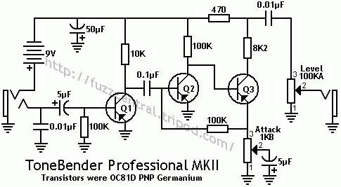

Step 2: Schematic Diagram
This schematic looks much worse than it actually is. If you break the formation of it down into loops it's not quite as scary. ***Ground on this diagram goes to the positive lead of the battery***

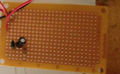

Step 3: Step 1
Start with the stereo (3-pronged) jack. Make sure that it is a Stereo jack and not a mono 12a (also three pronged) jack. The prong closest to the input of the jack is connected to the larger J-shaped part of the jack. This part connects to the positive lead of the battery. The middle prong is the Ring. The Ring typically goes to the negative terminal of the battery , or in this case into to the circuit. Finally, the lowest terminal is the ground.

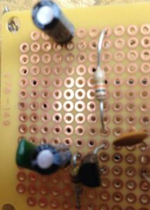

Step 4: Step 2
The lead coming from the ring of the jack connects to the lead from the .01 uF capacitor. The second lead from this capacitor goes to ground. The lead of the capacitor connected to the wire also is then connected to the negative lead of the 4.7uF capacitor. The positive lead of the 4.7uF capacitor is then connected to a 100k ohm resistor. The other leg of this resistor goes to ground.

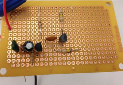

Step 5: Step 3
The next step involves a transistor, the 10k ohm resistor, and the .1uF capacitor. First, the middle leg of the transistor gets hooked up to the .01uF capacitor and 100k resistor junction from the previous slide. The right leg of the transistor (the emitter) goes to ground, whilst the left leg will be attached to the 10k ohm resistor and the .1uF capacitor.
Step 6: Step 4
This step will require another transistor, and two 100k ohm resistors. The middle lead of this transistor will connect to the end lead of the .1uF capacitor. One of the 100k resistors will be attached to this junction as well. The second resistor will be attached to the left lead of the transistor. The right lead will go the the ground.

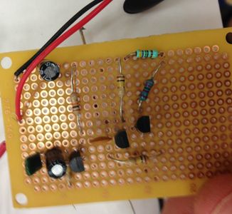

Step 7: Step 6
The middle leg of the third transistor is attached to the junction from the leg of the second transistor and the 100k resistor. The left leg of the transistor connects to the 8.2k (blue) resistor. A 470 ohm resistor (green) is then used to bridge the gap between the 100k ohm resistor and the 8.2k resistor.
Step 8: Step 7
Next, a .01uF capacitor is to be soldered to the 8.2k/470k junction. The 100k/470k junction is then attached to the 10k resistor from earlier. This then attached to a 50uF capacitor which is wired with the positive leg going to the ground. The 50uF/10k junction then leads back to the negative end of the battery.
