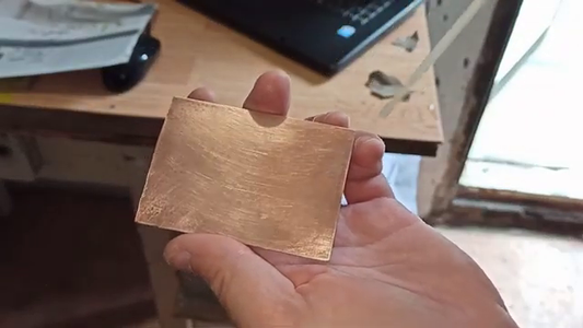

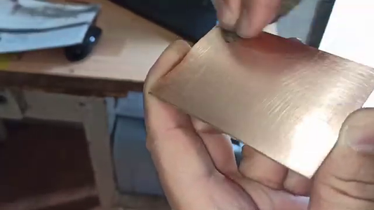

Step 1: Prepare the Copper Clad
As a first step we cut copper clad to a needed size, using coping saw.

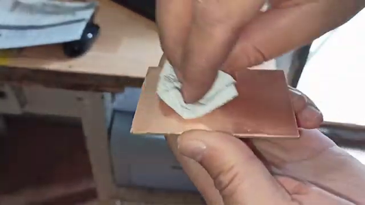

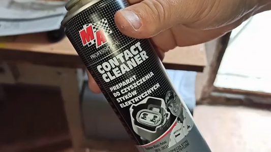

To prepare copper clad for toner transfer, we use fine grain sandpaper to remove any oxidation , than clean it with paper tissue.
Than we use contact cleaner or acetone to clean any grease.

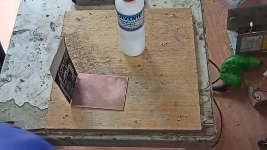

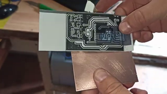

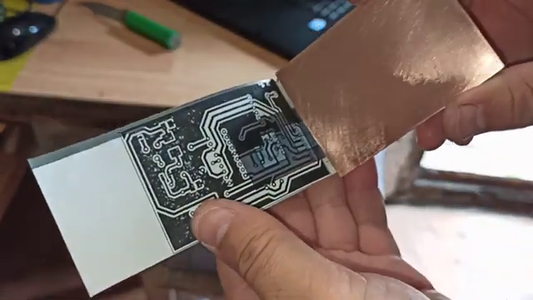

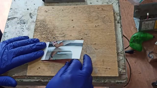

Step 2: Stick Paper to Copper Clad
Using adhesive tape we stick paper with the print to the copper clad.
Printed side must be turned to the copper side, and fastened with adhesive tape, to secure it from moving during the process.

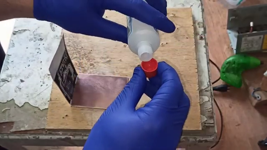

Step 3: Applying Nail Polish Remover
In this step we use nail polish remover, take a small amount and spread it evenly on the surface of the copper plate.
If it dries to fast, feel free to add little more ( check the video ).

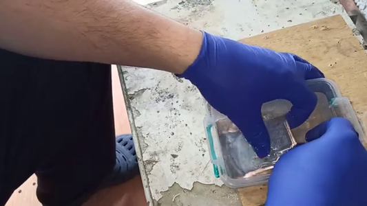

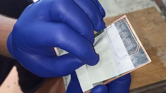

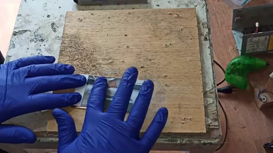

Step 4: Removing the Paper
Ten minutes or so after, we can start to remove paper very slowly.
Just be careful not to damage toner traces left on the copper.
After we removed first layer of paper we put board into the water, and slowly rubbing we remove the rest of the paper.
This rubbing should be done VERY carefully, so we do not damage toner traces.

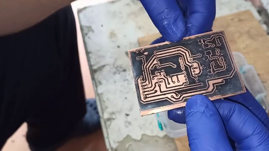

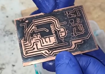

Step 5: Final Result
And in the end , the result is very satisfactory.
As you can see, sometimes some traces are not perfect.
In this case you can use alcohol marker to draw those damaged,missing traces.
