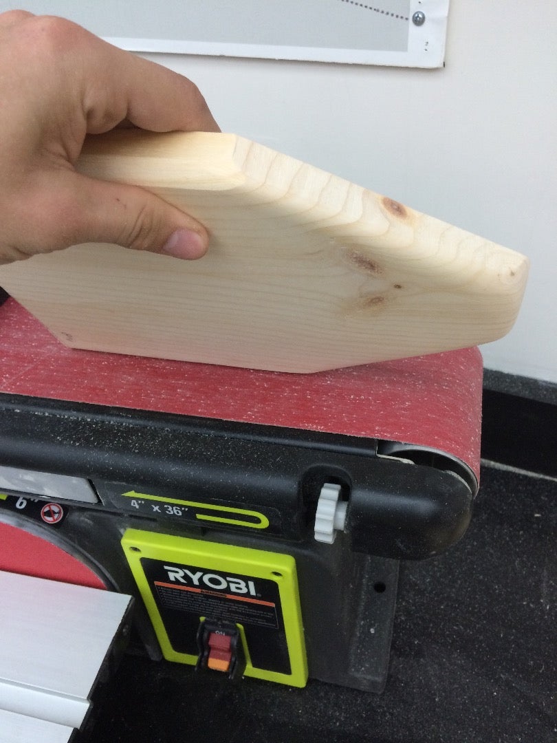

  1. first take your bottom piece and go over to the belt sander.
  2. turn on the belt sander
  3. take the bottom and hold the end at a 90 degree angle and sand the bottom to make the end even.
  4. do that on all 4 sides
  5. next take your end pieces and use the belt sander to round the top edges on your end pieces leaving the 7'' side perfectly square
  6. do this with the side as well leaving the 3'' pieces and the bottom 17'' piece square and rounding the top 17'' piece

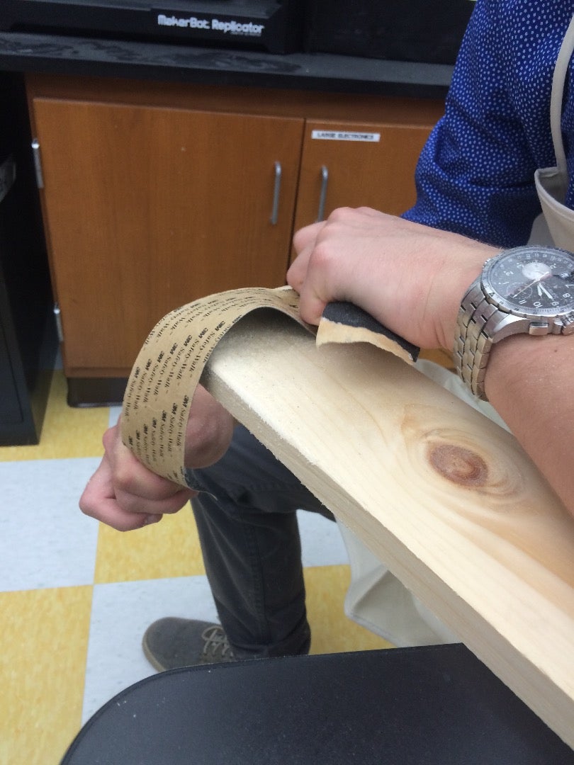

  7. next go over to the tables and take the orbital sander and put a 60 grit pad on it and sand all of the pieces than go to a 120 grit after that is done.
  8. next take the pad sander and sand with a 120 grit sand paper making sure you are going with the grain
  9. next take a piece of 220 grit sand paper and sand all the pieces by hand making sure you are going in the direction of the grain
