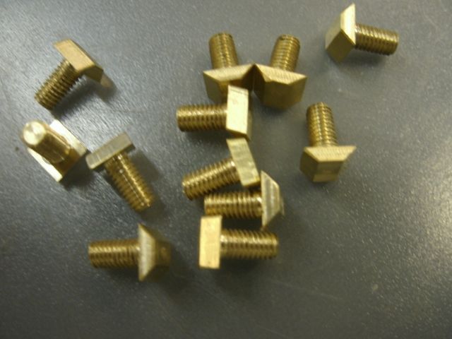

Mounting the die block to the die shoe is a straight forward process of transferring the location of the tapped holes in the die block to the die shoe. There are a number of ways to do this. I used transfer screws for this die, but sometimes I will clamp the die block to the die shoe and match drill the mounting holes.
You put one of these in each tapped hole, place the die block where you want it, smack it with a deadblow hammer.
What you have now is little punch marks on the die shoe. This is where you drill the holes for the screws.
