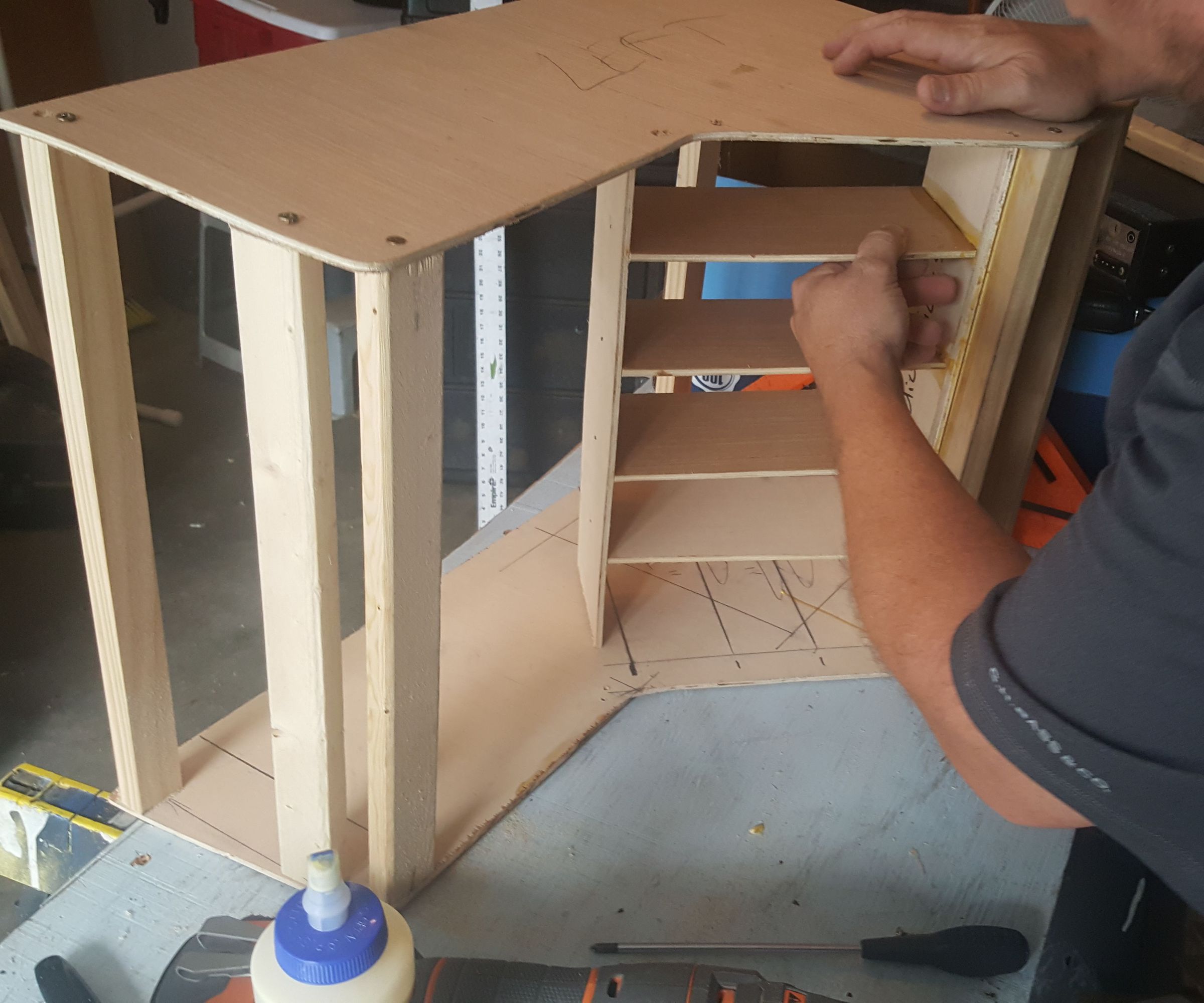

Step 2: Cut the Frame for the Charge Controller and Inverter
I did a little bit of assembly and mounted the charge controller below the inverter
I left the gap in the bottom of the brace to run wires under without them being pinched
Be sure to leave enough room for everything to breathe
Make sure your inverter mounts up high enough that it will not arc
