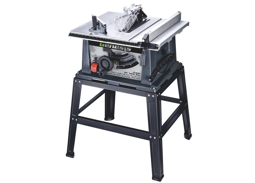

Genesis GTS10SB (~$190)
15 amp motor @ 4,800 RPM

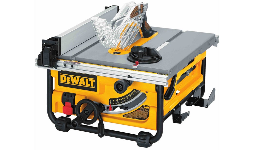

DEWALT DW745 (~$300)

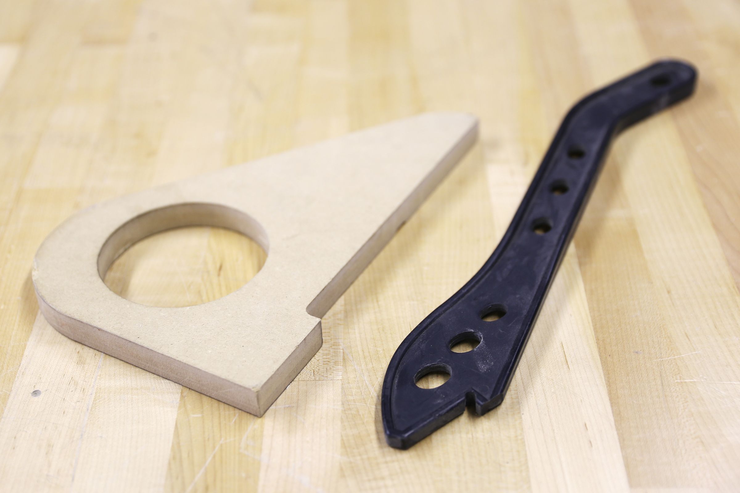

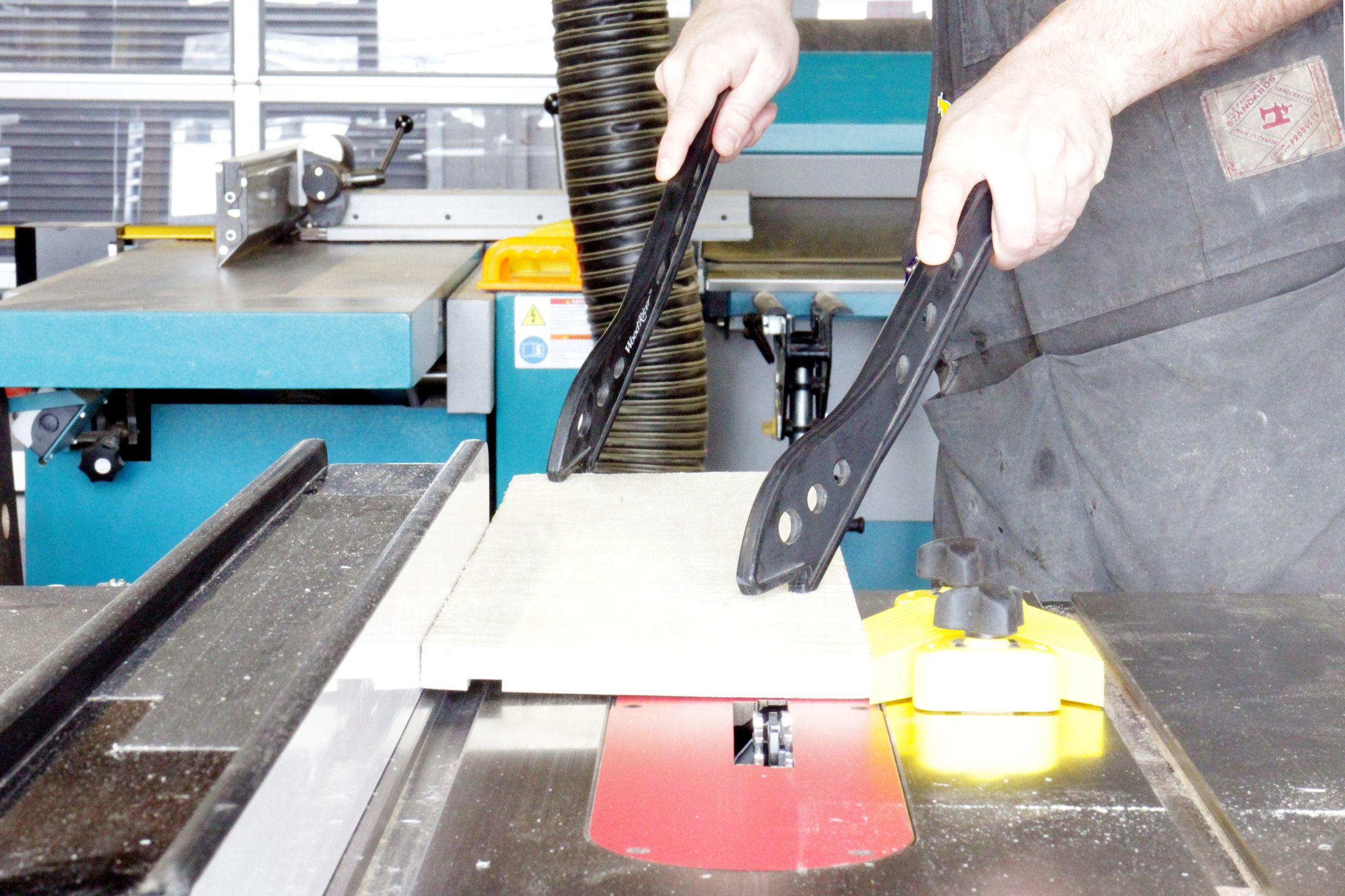

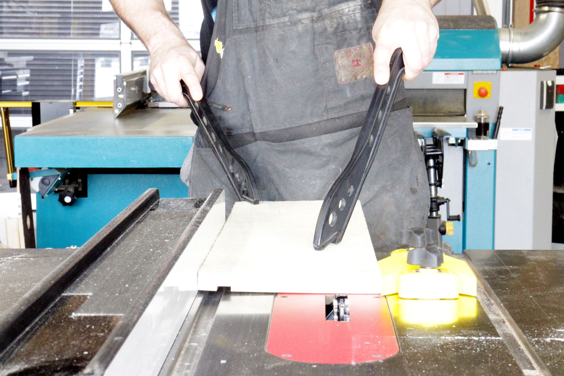

Push Sticks
To keep your fingers away from the blade you'll need push sticks. Push sticks are sacrificial pieces of wood to plastic that help push the wood through the blade.
Push sticks usually have a notch or "bird's mouth" cut that hooks onto the end of the piece you are cutting and guides it into the blade. Push sticks should be viewed as a consumable item; though the idea is to keep them as long as possible, it's not the end of the world if you chew one up or accidentally cut through it (better than your fingers!).

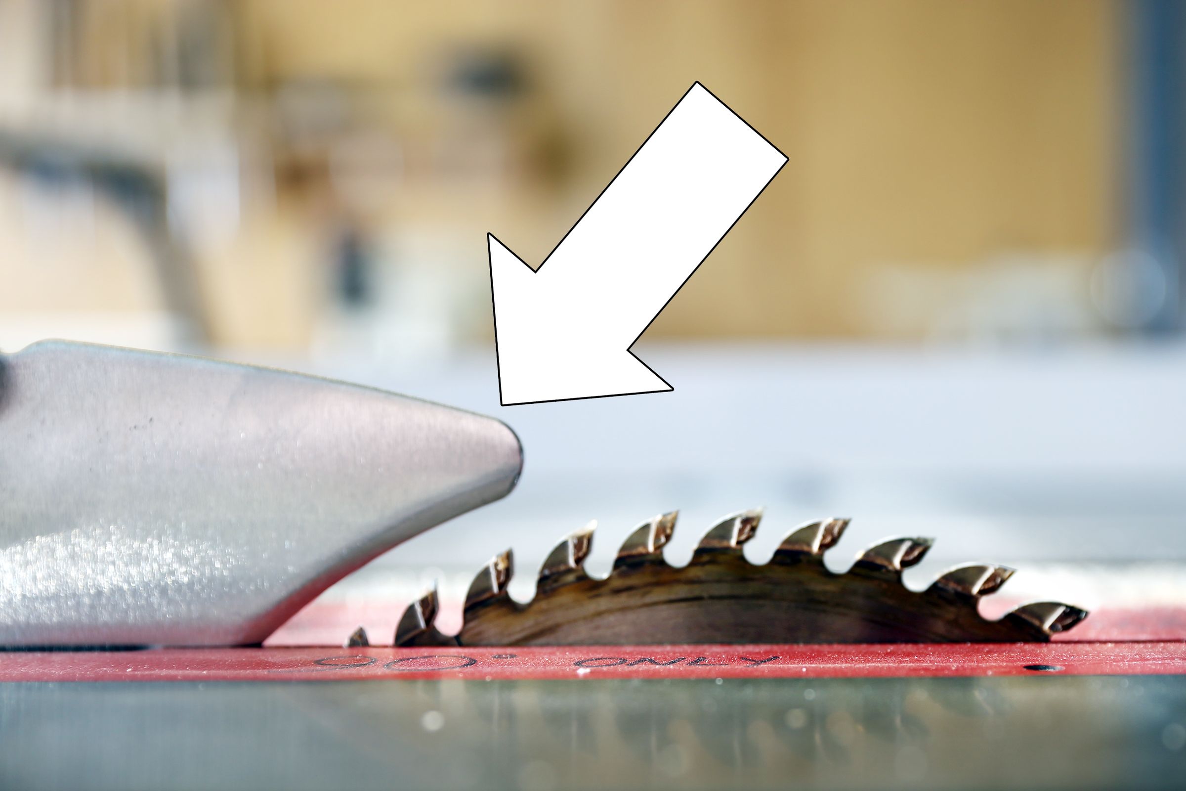

Riving Knife
All modern table saws come with a riving knife, a stationary dull blade that rides along behind the cutting blade that acts to prevent wood from binding against the saw blade after cutting.
Internal stress within wood can cause wood to become misaligned after cutting, so what was once a straight piece of wood can warp into a helical bend after cutting. This is normal. The riving knife acts as a wedge, keeping any warping after cutting away from the cutting blade. Riving knives are removable, for the times when you want to make a dado or other cut that doesn't go completely through the material, however should be in place at all other times.

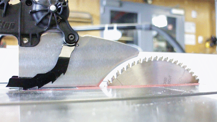

Kickback Pawls

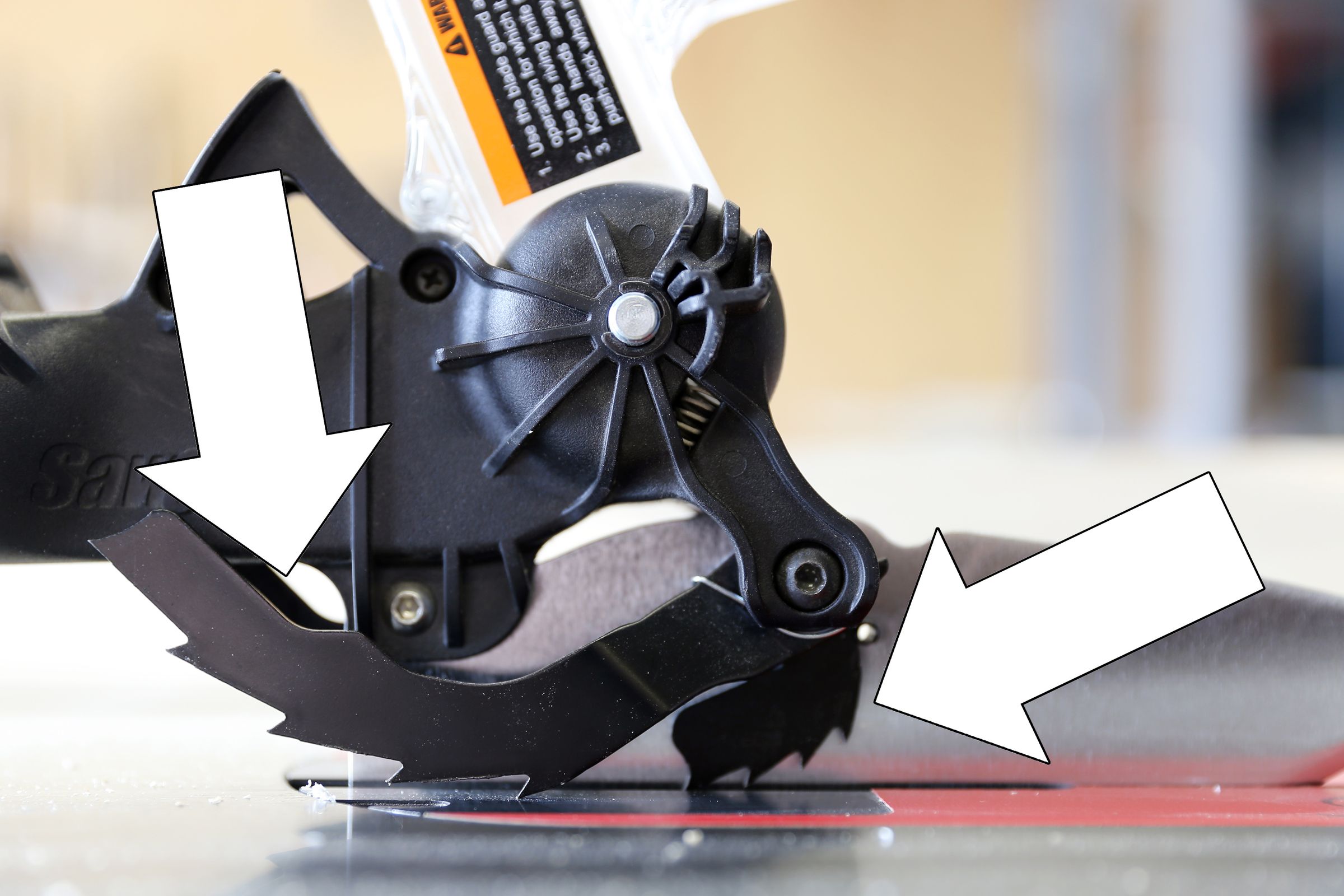

Pawls are serrated spring loaded edges designed to allow wood to travel past it in one direction, but not the other. Not all table saws have kickback pawls, but they are a great feature that can be added to most table saw riving knives.
Pawls are mounted just behind the riving knife and drop down on either side of the cutting blade.
Pawls are spring loaded and move upwards when wood pushes them out of the way, if kickback occurs the serrated teeth catch the wood and prevent it from flying backwards towards you.
Featherboard

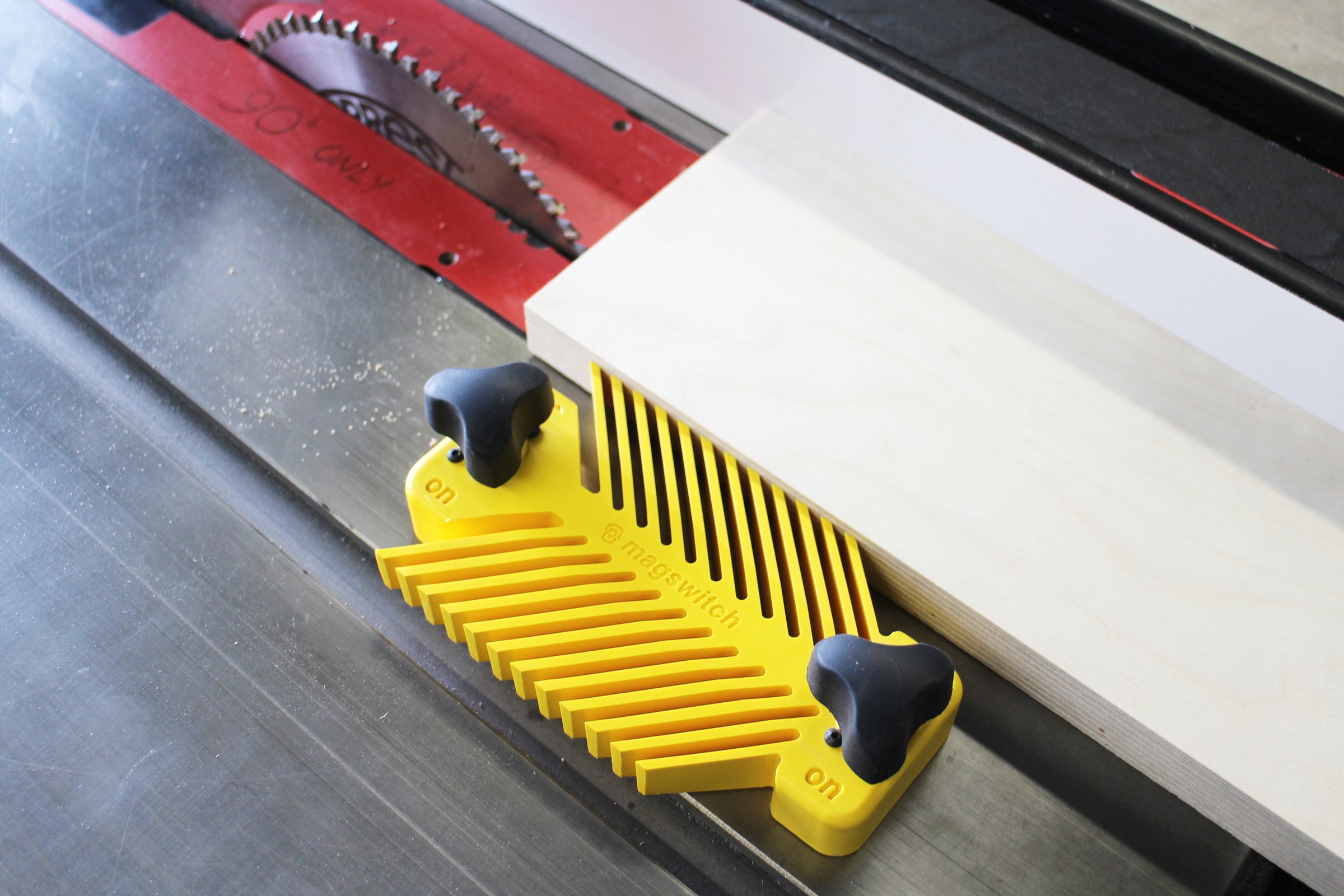

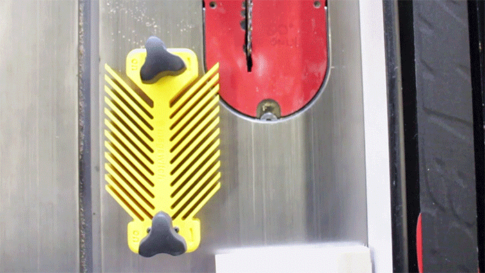

Another great safety accessory that's doesn't come standard with table saws are featherboards. Some are magnetic, some ride in the mitre slot next to the blade, but they both aim to push the wood against the fence and keep it aligned while cutting.
Though you can hold the board with your hands and guide it through the cutting blade, the featherboard applies constant pressure against the workpiece. Misalignment while feeding wood into the cutting blade can cause kickback, and while a featherboard will help reduce the occurrence of a kickback it will not restrain the board if one does occur.
The fingers of the featherboard apply pressure against the wood. In this animation you can see the board starting out of alignment with the fence, then straighten up once the wood makes contact with the featherboard.

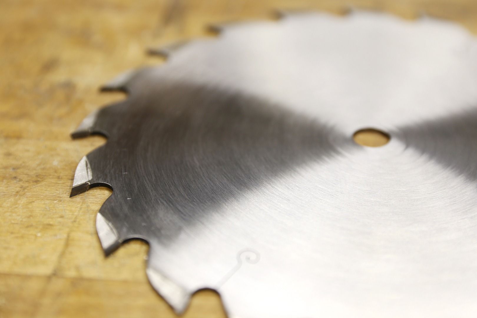

Low Tooth Count Blade
Saw blades with a low tooth count are great for rough cuts, making quick work for large volumes of work. The aggressive teeth are great for construction cuts that aren't meant to be of finish quality.

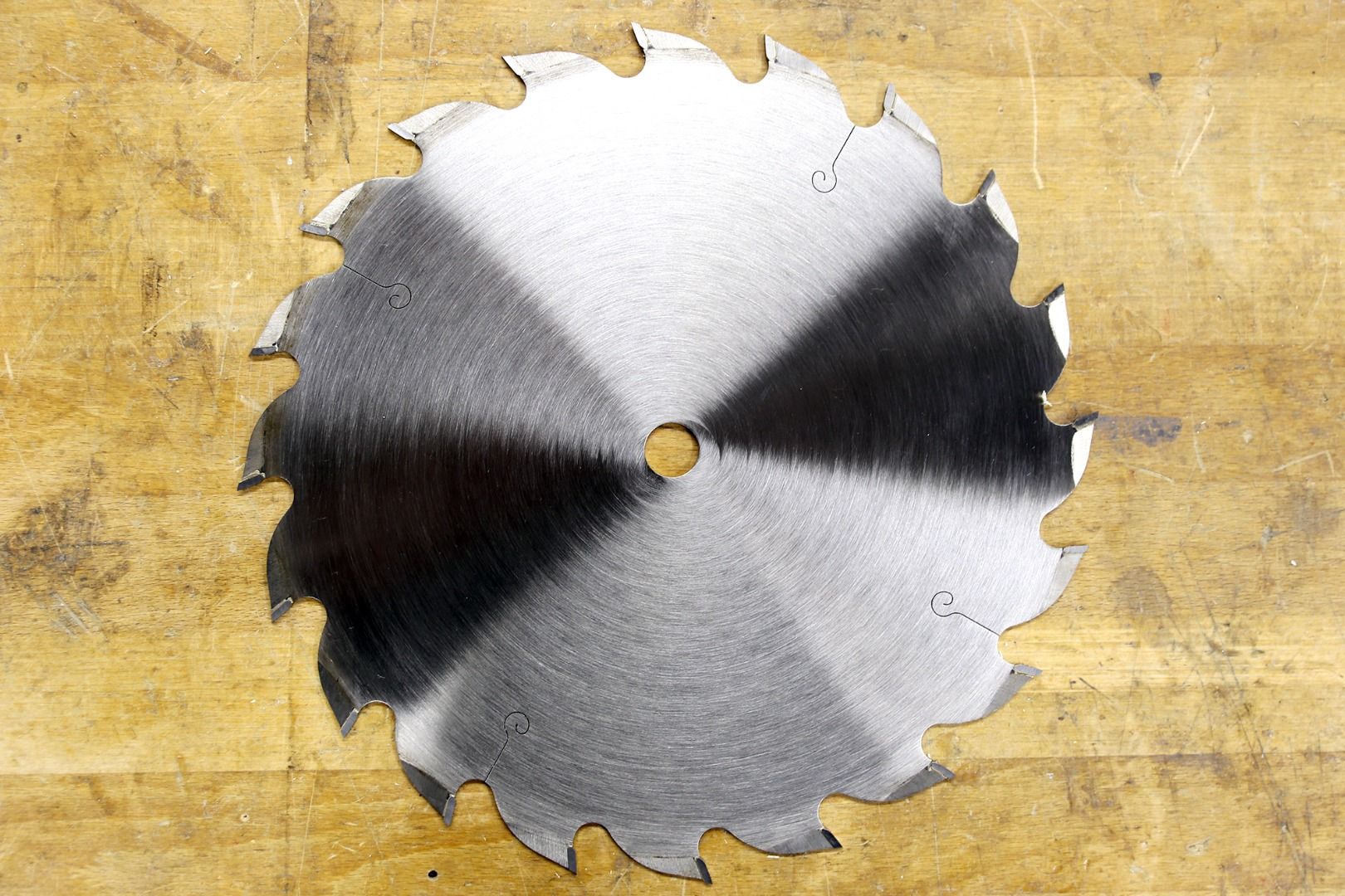

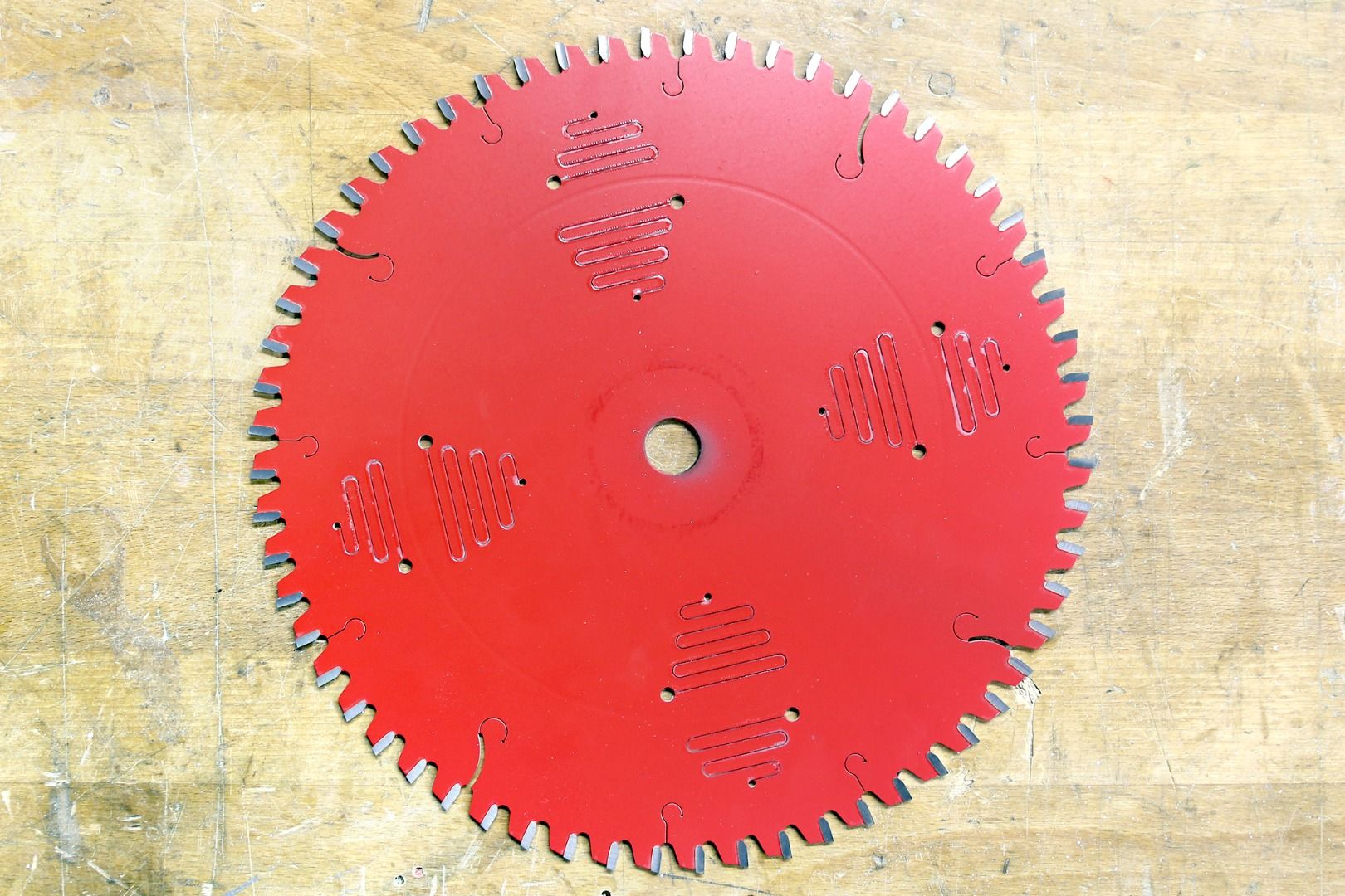

High Tooth Count Blade
Fine tooth saw blades make slower cuts, but the finish quality of the cut is much nicer. Fine tooth blades are great for cuts that will be the finish edge of your project. Higher tooth count blades are able to cut harder materials, like hardwood. With the right blade, your table saw can even cut thin metals.

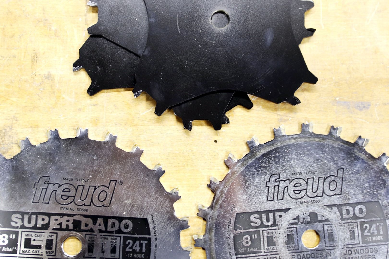

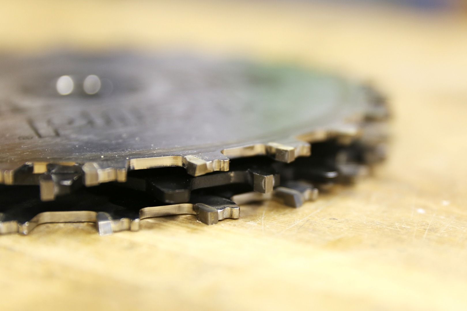

Dado Blade
Dado blades are stacked like a sandwich to achieve the desired blade thickness. Dado blades are used for cutting grooves in wood, either with or against the grain. We'll cover this more in the Dadoes + Rabbets Lesson.

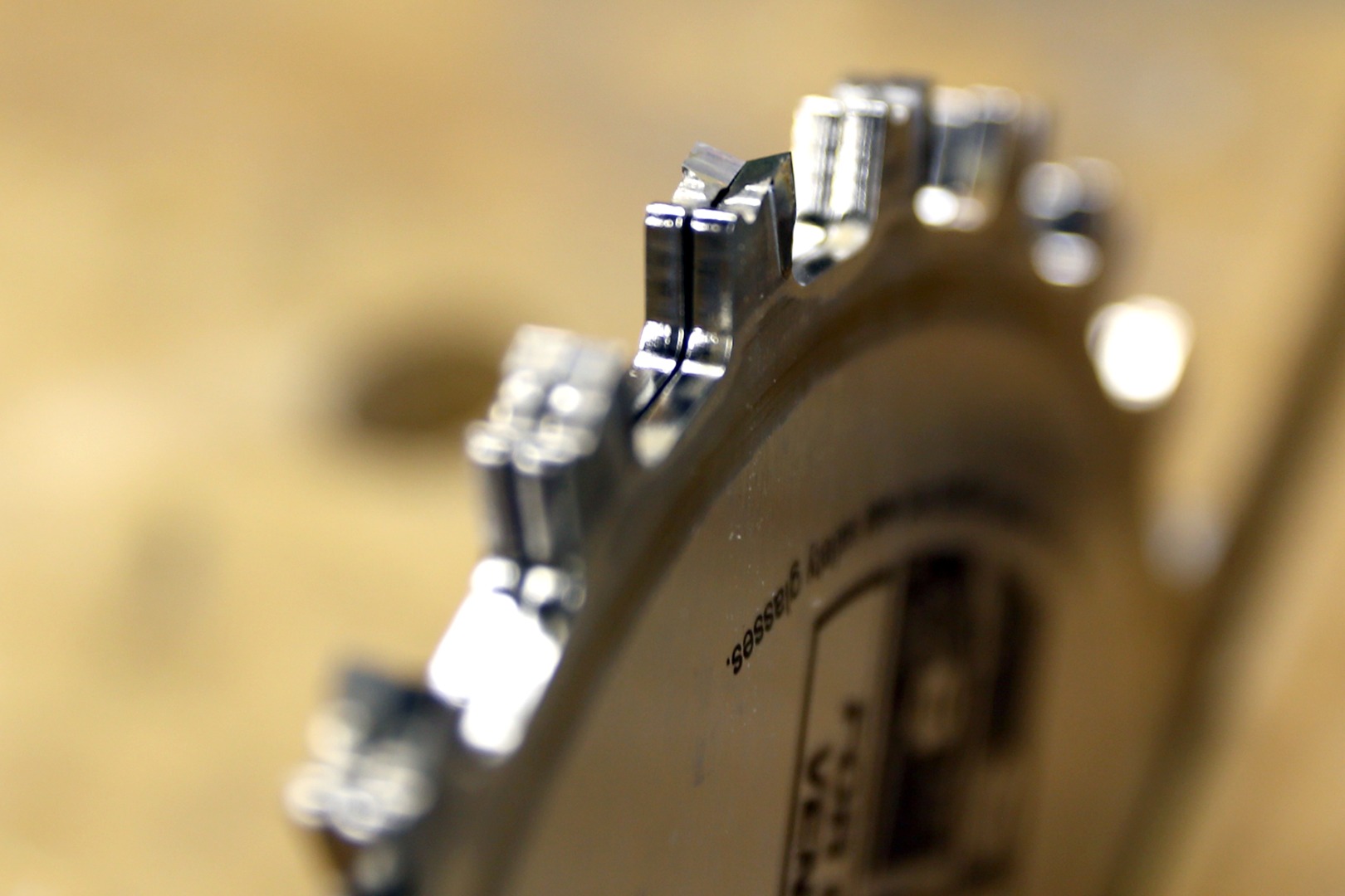

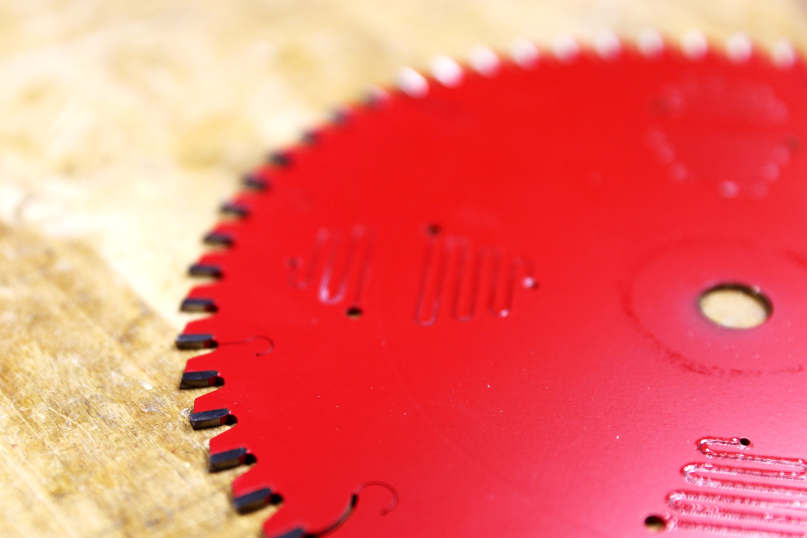

Tooth Crown
If you look closely at the crown of blade teeth you'll notice there's a slight angle to the tooth. The thinner and sharper the blade angle, the cleaner the cut.

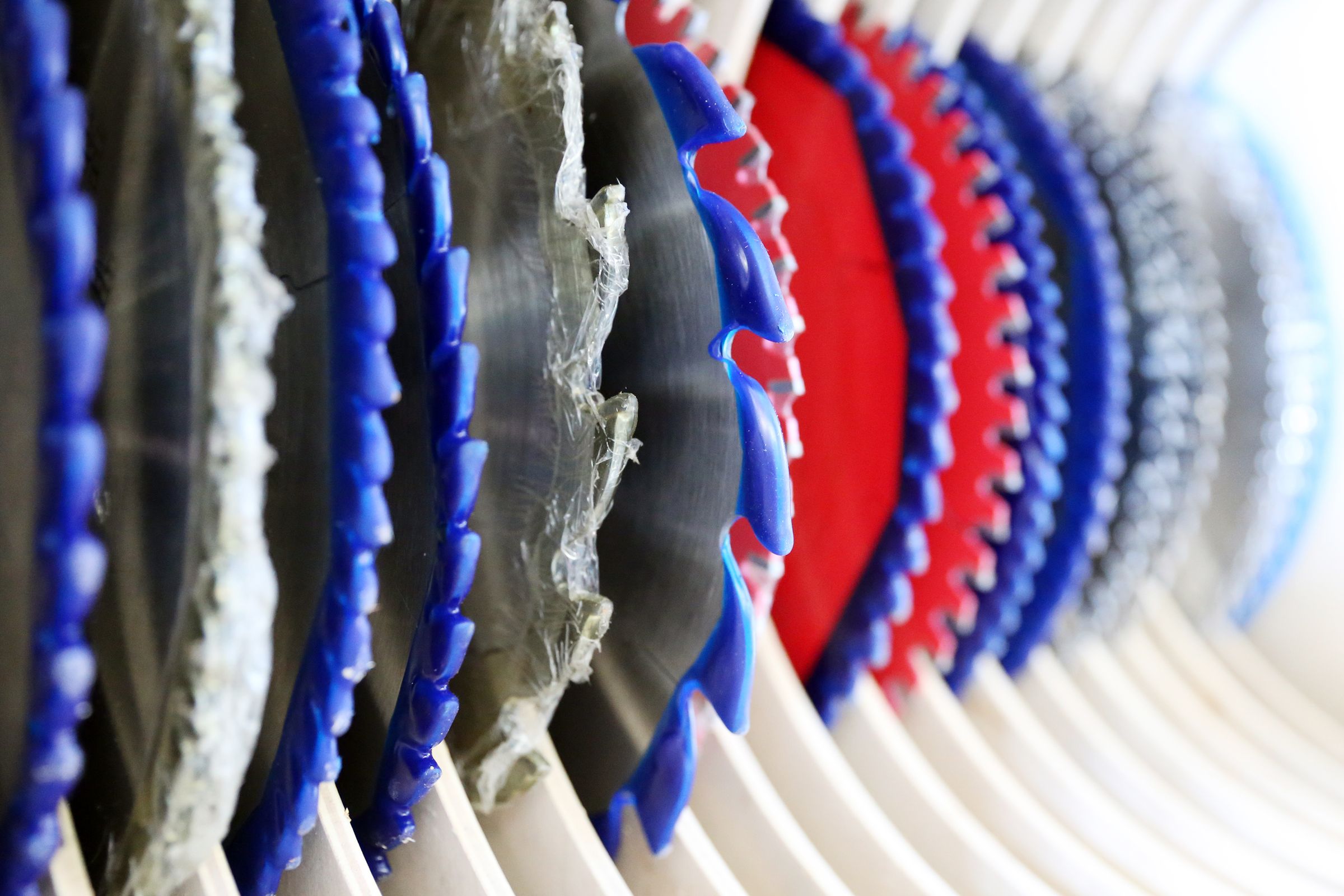

Blade Storage
Blades should be stored to protect the blade tips. If your blade has a plastic cover it's best to cover your blades to prevent damage. I like to keep my blades separated to prevent any contamination from oils and debris that might be present from transferring onto other blades stacked against it.

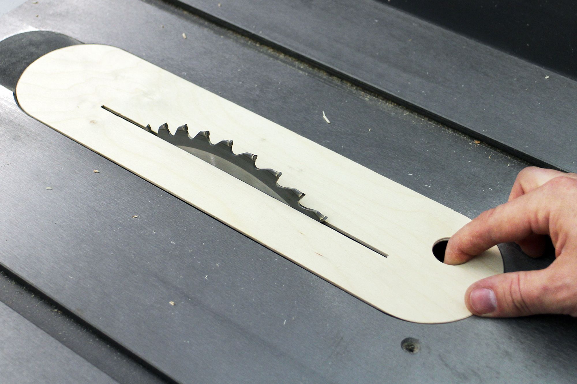

Zero Clearance
An insert that exactly matches the width of the blade. A zero clearance insert prevents small pieces from falling in the gap between the blade and the edge of the insert, and reduces tearout when cutting.

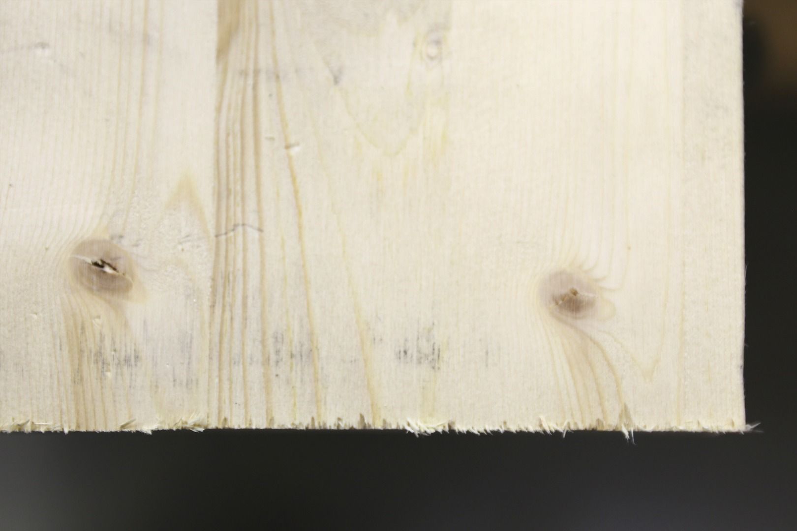

Tearout
Tearout
A ragged finish along the kerf, and only appearing where the blade exits the cut. For table saws this will be the side of your wood that is facing down during cutting.

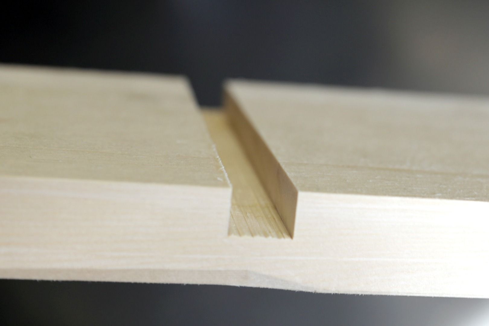

Dado
Dado cut - across the grain of wood
A dado (pronounced "day-doe") is a carved slot. Dadoes can also be called grooves, but officially speaking dadoes are across the grain and grooves are cut with the grain - however both terms are used interchangeably without much fuss.

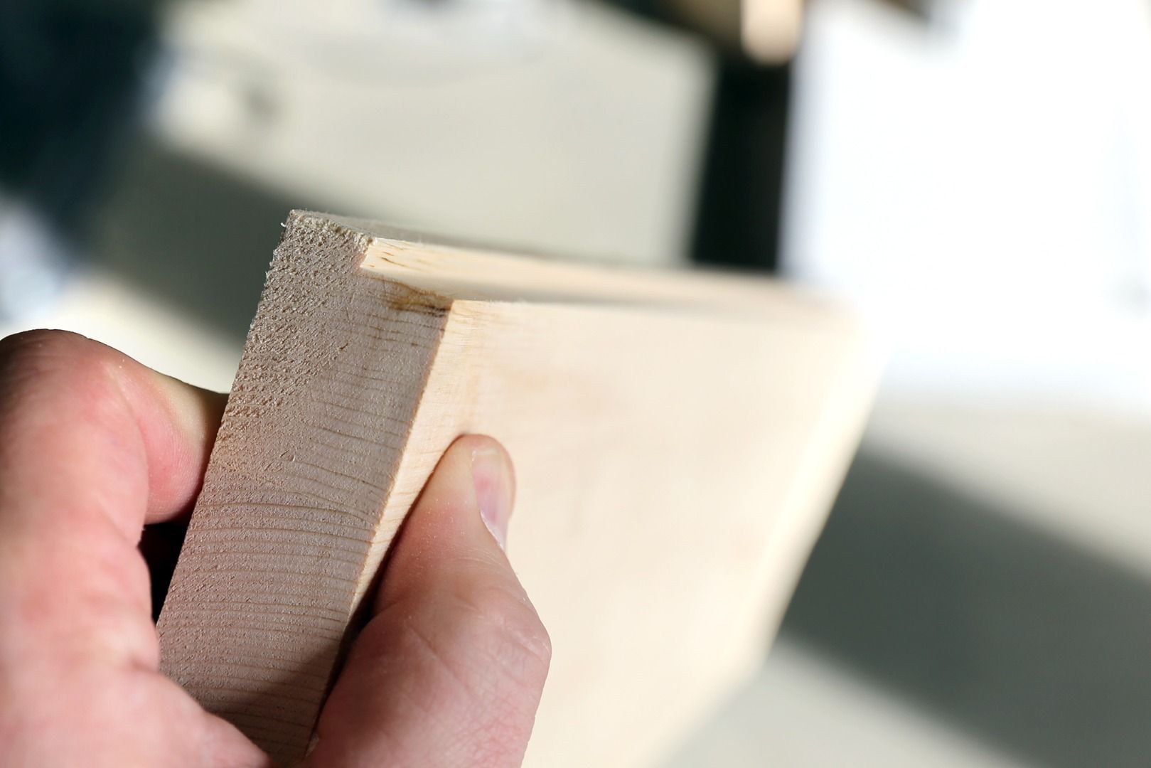

Rabbet
Rabbet cut
A square notched cut along the edge of a board, with or against the grain.
