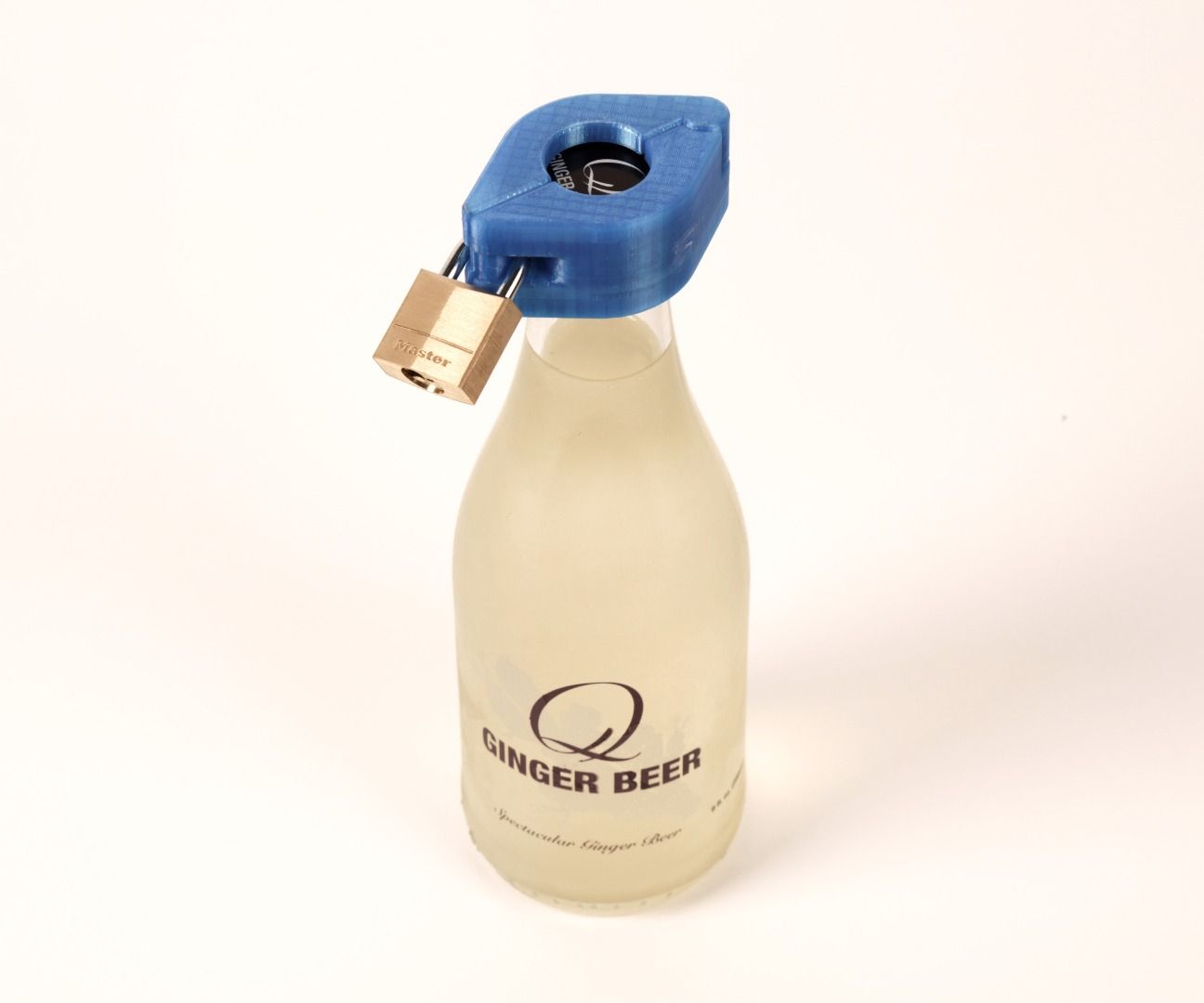

Throughout this class, you'll learn about simple mechanisms and complex forms with the Bottle Lock project based on my instructable from 2014.
