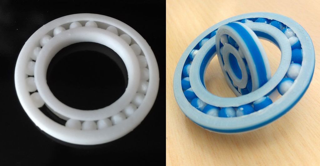

3D Print Ball Bearing in One Shot by Ally Zhao
What makes 3D printing unique is its ability to make complete, complex solid objects. Most 3D printed objects could only be produced by a master sculptor or machinist, and some 3D printed objects would be impossible to produce any other way. The 3D Print Ball Bearing in One Shot by Ally Zhao (shown above), for example, has all of its internal and external parts printed in place- the result is a sealed ball bearing assembly with no seams or fasteners.
3D printing, for most makers, is a powerful shortcut to making precise, complex objects for endless different purposes.

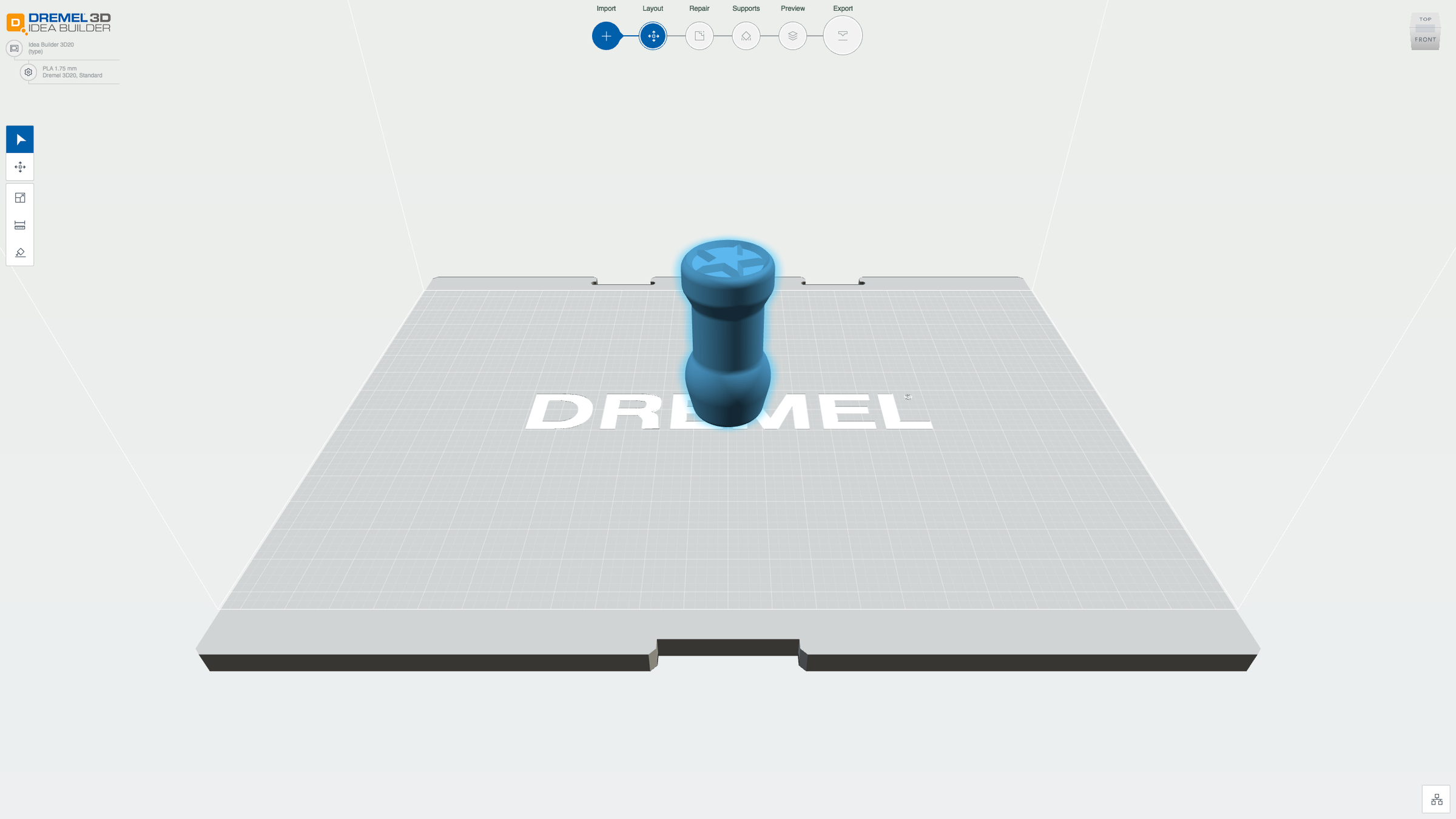

Print Studio: Simple Slicing Software (Free)
Once your model is finished, you'll need to send it to a slicer to create a file that a 3D printer can understand (G-Code). Print Studio is free and easy to use. It's all you'll need for simple models that don't have overhangs, which we'll talk about in the Bottle Lock Project lesson.

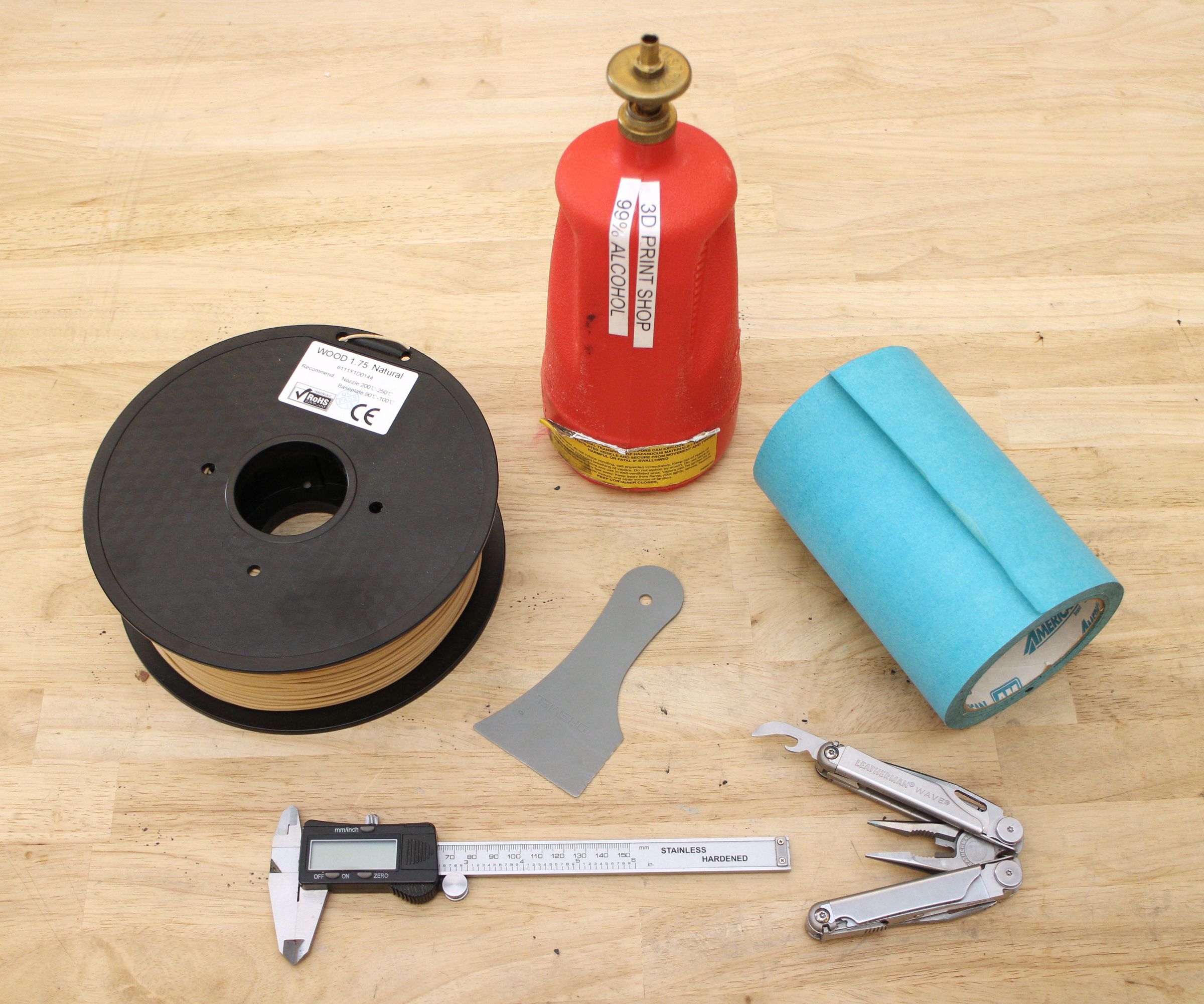

Step 6: Tools + Supplies
Calipers ($17): Calipers are the tape measure of small-scale design. This handy tool will make it easy to measure tight spaces, curved objects, and all kinds of unusual shapes.
Plastic Putty Knife ($7): Getting printed parts off of the build platform can be tricky. This handy tool works like a spatula that will help you remove the part without damaging it or the bed.
Isopropyl Alcohol ($7): Filament has to stick to the build platform. Oil from your fingers keeps it from sticking. Solution: rubbing alcohol! Add cleaning a 3D printer build platform to its endless list of other uses.
6" Painter's Tape ($30): Save your build platform, your money, and your sanity by buying some 6" painter's tape to cover your build platform. It's a great surface for the filament to stick to and it's cheap, so you can replace it when it gets too rough.
Multi-Tool with a Can Opener ($77): No self-respecting maker leaves home without a Leatherman multi-tool. I mostly use the can opener to clean out support structures (more on that later), but I find myself using it quite a lot throughout the process.
3D Printer Filament (varies): Filament is the spooled plastic material that gets extruded into a 3D object. There is a wide array of options for the material, but for this class we'll stick to 1.75mm PLA, which is the best option for the Dremel Idea Builder.
