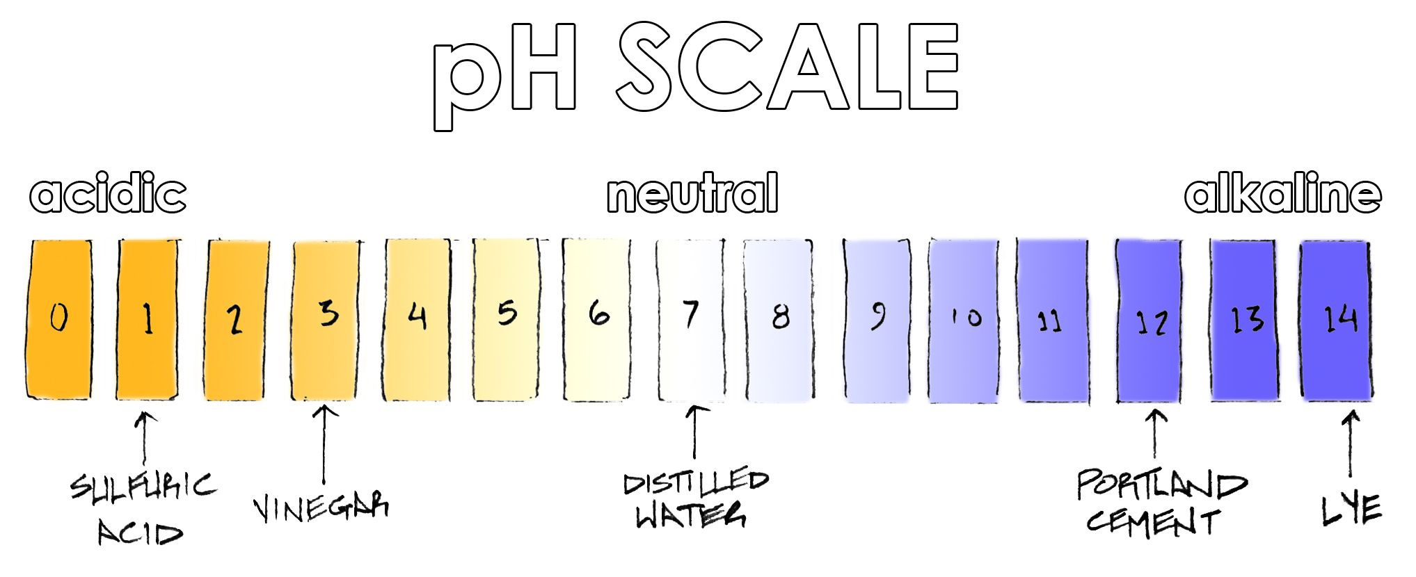

Concrete Alkalinity
Aside from the usual (PPE) there's an added caution to working with concrete, it can cause burns. Most people are familiar with what acid is, and that it can cause burns. On the other end of the scale from acid is base, and just like acid can damage your skin so can basic chemicals.
Portland Cement is very basic (or, alkaline - the opposite of acidic), meaning it's caustic and can burn your skin. If tap water is neutral at a pH of 7, Portland Cement has a pH of 12 to 13. In addition to high alkalinity, the hydration reaction that cement goes under as it cures is aiming to draw out moisture - in this case, your skin.
In most cases you're likely to have concrete on your hands. If left untreated it will feel like the worst dry skin sensation you've ever had. Even brief exposure to concrete can have effects hours later, so wear gloves and be sure to treat any areas by neutralizing the concrete.
How To Neutralize Concrete
To neutralize a base you need to add anything more acidic. Before you go dumping battery acid all over your hands there's a much easier way to combat an alkaline substance: vinegar.
It's a good idea to wash any affected area with water first, as this will begin to bring the pH levels down (pH 7 is more neutral than pH 12), this can be easily done with a hose or a bucket of water.
Flush area with plenty of water to remove all traces of cement as soon as possible - the longer you wait to remove alkaline from the skin the worse the impact to your skin. When you're sure all cement has been removed from your hands and anywhere else you can move on to raising the acidity even more to neutralize any lingering alkalinity.
Pour common white vinegar over the area to bring the pH up even more (vinegar pH is around 2.5-3) and fully neutralize any lingering alkalinity. Make sure yo rub your hands together to really get good coverage.
After, unless you want to smell all vinegary for the rest of the day, it's a good idea to rinse your hands once again with water to neutralize the vinegar acid and bring the pH back to neutral.
