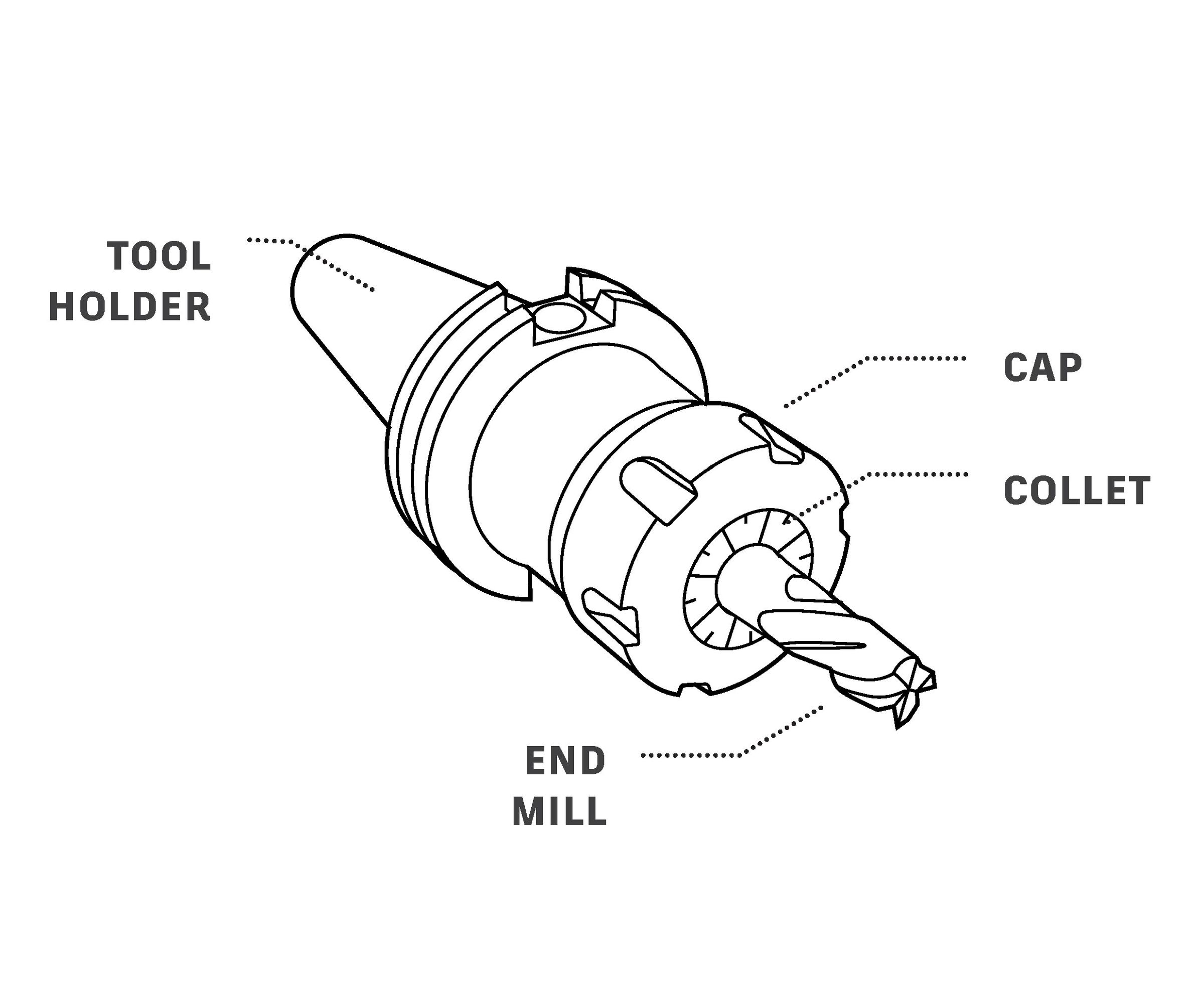

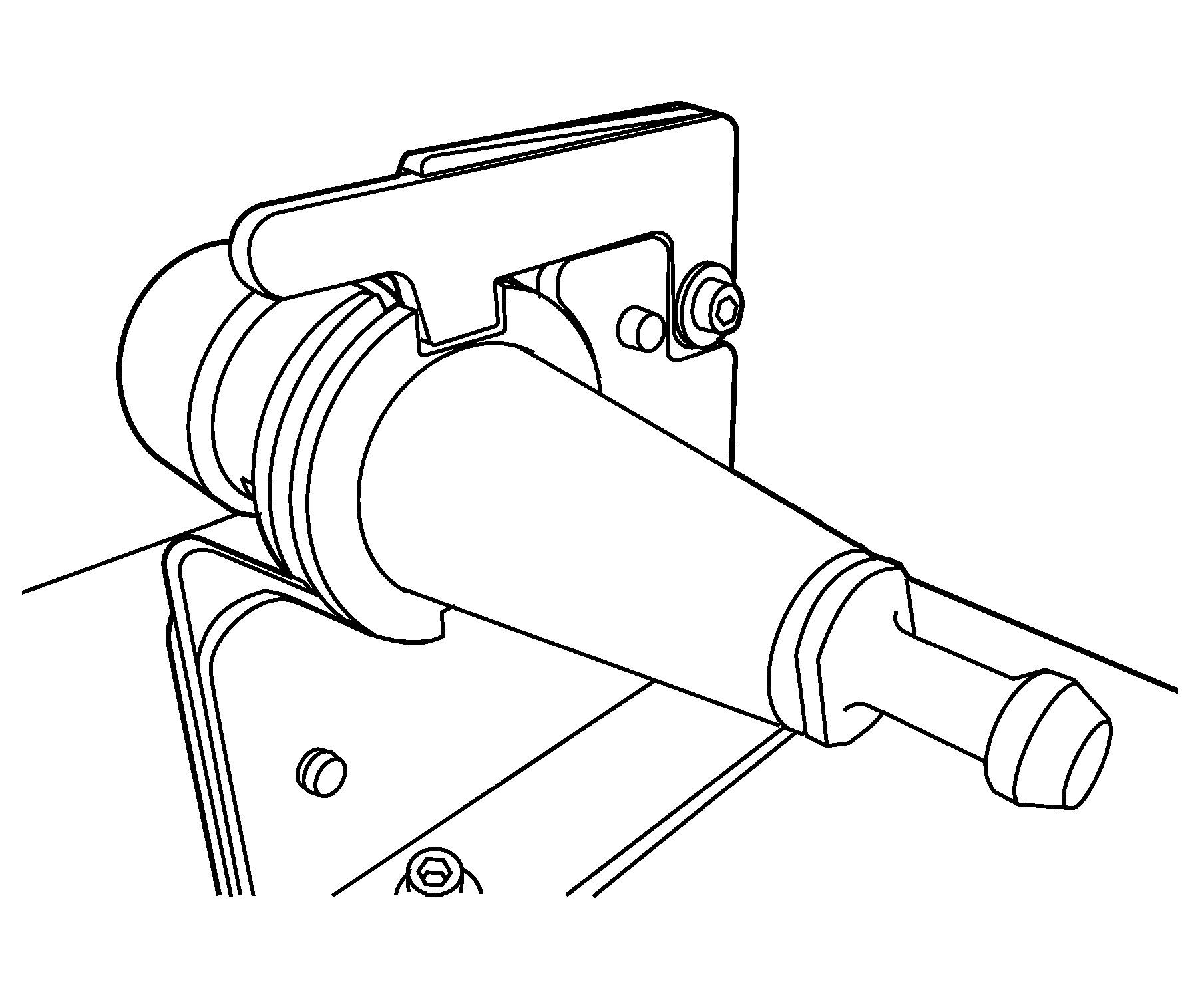

There are two kinds of tool holders: drill chucks and collets. Both kinds should be held in the tool vise on the front of the mill while preparing custom tools.
Drill chucks
- Only use for holding drill bits.
- Tighten by applying force clockwise with the correct wrench for the chuck.
Collets & tool holders
- Use a collet that is the same size as the shank of the cutting tool.
- Snap the collet into the cap.
- Screw the cap onto the collet a few turns.
- Insert the cutter as deep as possible.
- Grip the shank, not the flutes.
- Tighten the cap with the wrench.
For staging the holders, iIn the order listed in your Setup Sheet, set the tools in the storage rack on the front of the mill.

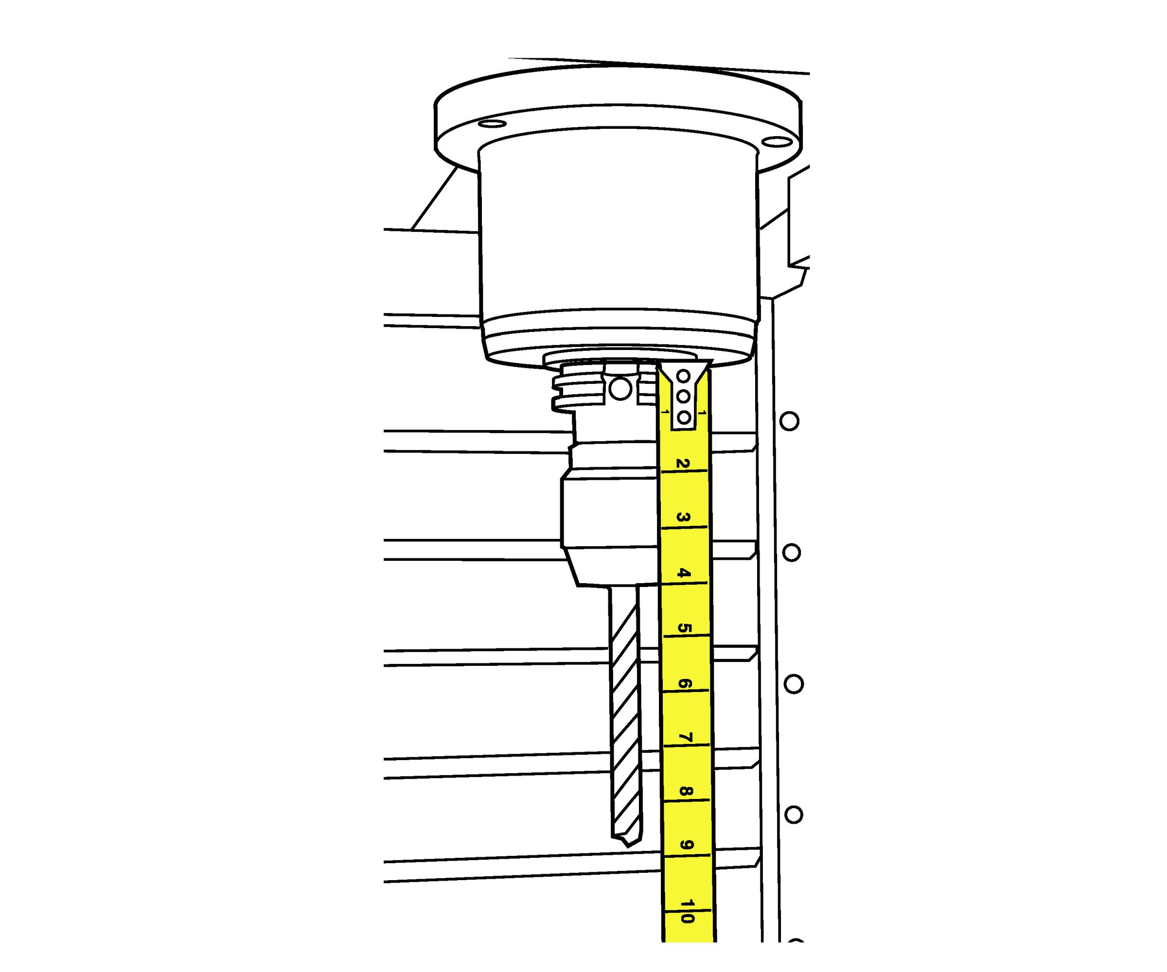

Step 2: Tool Length

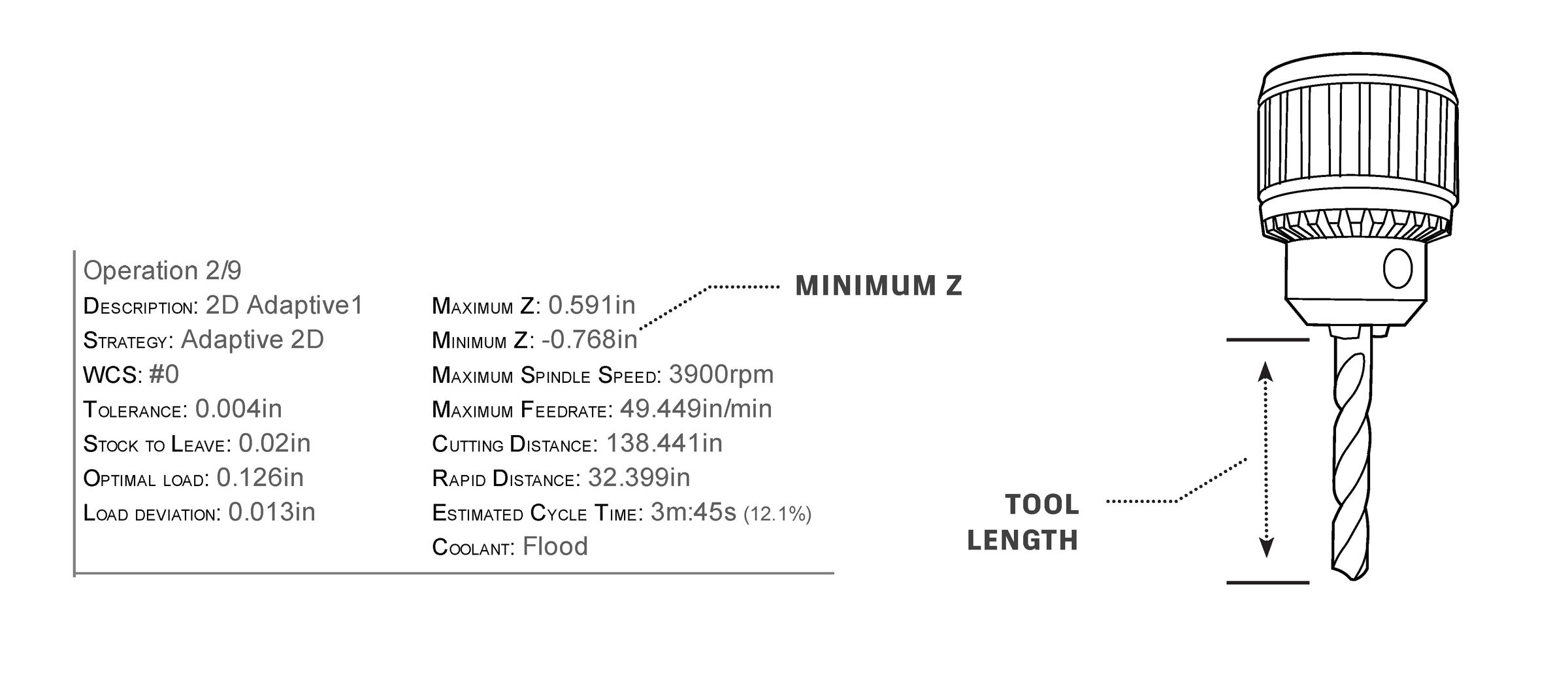

Check the length of the custom tools
In the CAM software, the library tools and tool holders are modeled. The software will detect a collision involving the holder.
The holders for custom tools are not modeled, and collision checking does not happen in software. You need to check for collisions manually.
If you set your Work Coordinate System (WCS) to the top of the stock in your CAM setup, the Minimum Z entry in your Setup Sheet will show how deep the tool will go into the material.
- Look at the Minimum Z entries in your Setup Sheet for each custom tool.
- This is the deepest point that the tool will go into the stock.
- Measure the amount of tool sticking out of the tool holder.
- This is called the approximate tool length.
- The approximate tool length must be larger than Minimum Z

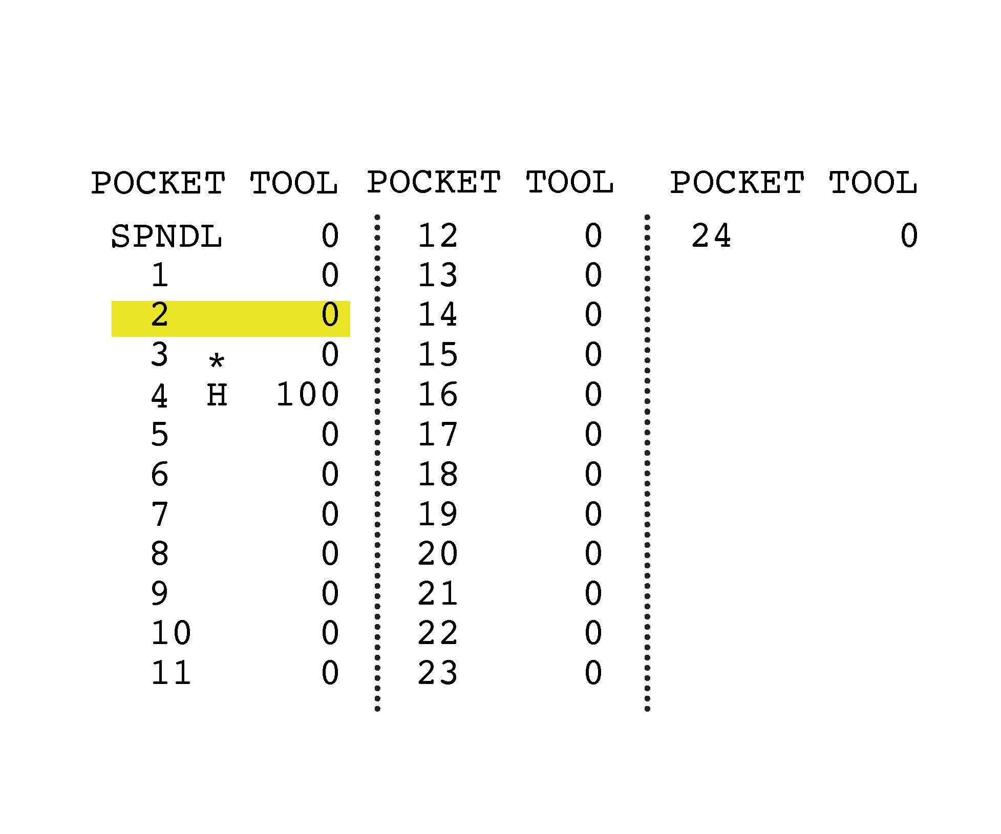

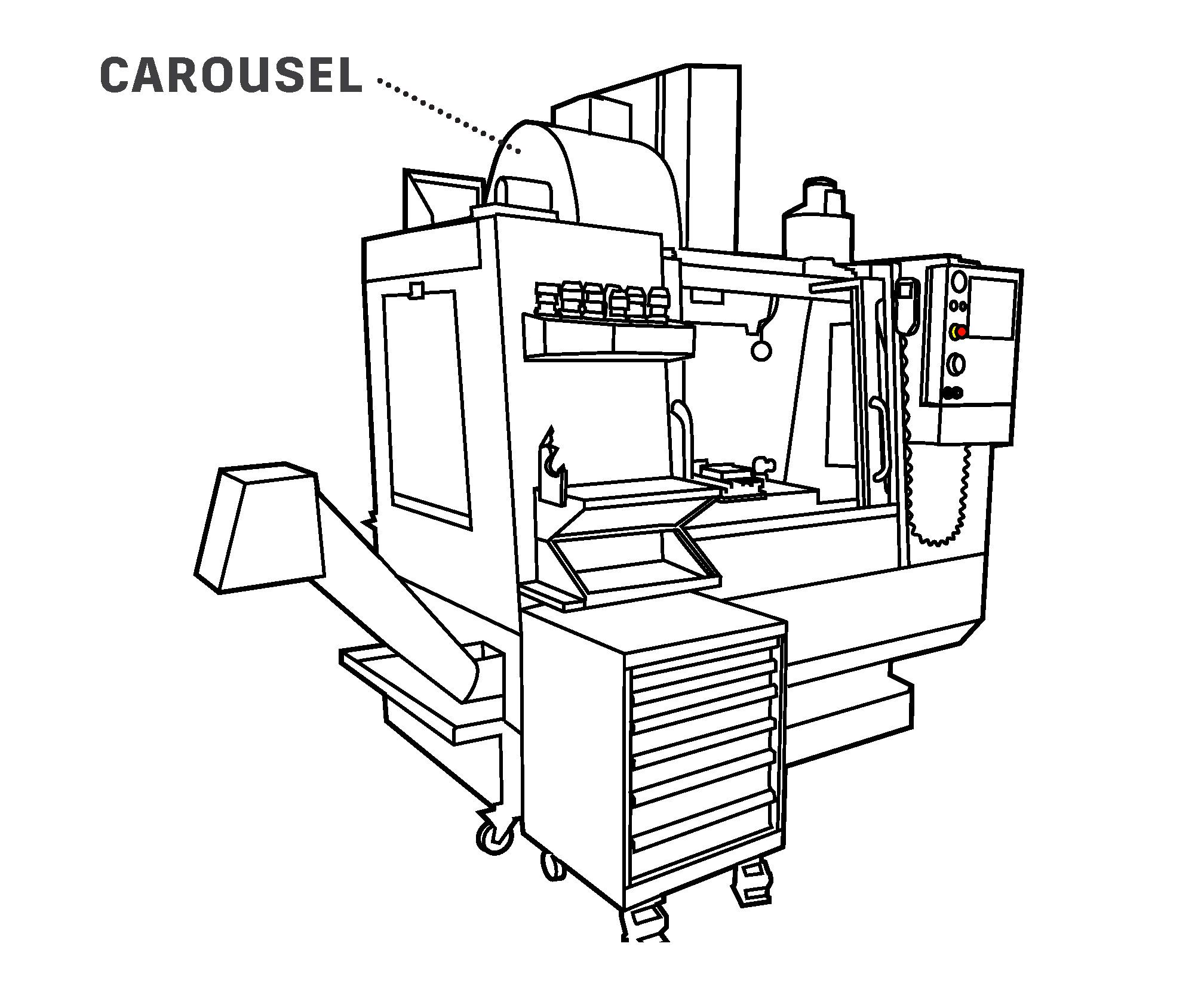

INSPECT THE POCKET TOOL TABLE AND CAROUSEL
Pocket Tool Table and Carousel
- The Pocket Tool Table (PTT) is a list of all tools inside the machine. It shows their location, in either a pocket or in the spindle.
- A pocket is a location in the carousel, which holds the tool when not in use. There are 24 pockets in the carousel.
- You must check that the PTT and the carousel are empty before starting. You are checking the last person’s work.
- The probe (tool #100) should never be removed.
Check the Pocket Tool Table
- Close the doors.
- Press MDI DNC. (mode keys)
- Press CURNT COMDS. (display keys)
- Press PAGE UP or PAGE DOWN (cursor keys) to navigate to the PTT.
- Check that all the tool entries, except the probe tool, are set to 0 (empty).
Reading the Pocket Tool Table
- Zero means no tool is in a pocket.
- The active pocket has an asterisk.
- Active means it's the pocket at the bottom of the carousel.
- Tool 100 is the probe.
- The yellow bar means that you have selected that pocket.
- H or L indicates a heavy or large tool.

Step 4: Carousel
Visually check the Carousel
You must check that the carousel matches the pocket tool table, because there is no way for the mill to know if they are in sync.
Visually verify that the carousel is empty before inserting tools. Putting a tool into an occupied space will break the tool, or worse.
Only half of the carousel can be seen at once. Check the visible half, then rotate the carousel to check the other half.
- Visually check the carousel to see if any tools other than the probe are visible.
- Look at the Pocket Tool Table and find the active pocket.
- To rotate the carousel 12 positions, add 12 to the active pocket number.
- If the answer is larger than 24, subtract 12 instead.
- Enter P[pocket number] ATC-FWD. Check the carousel again after it rotates.

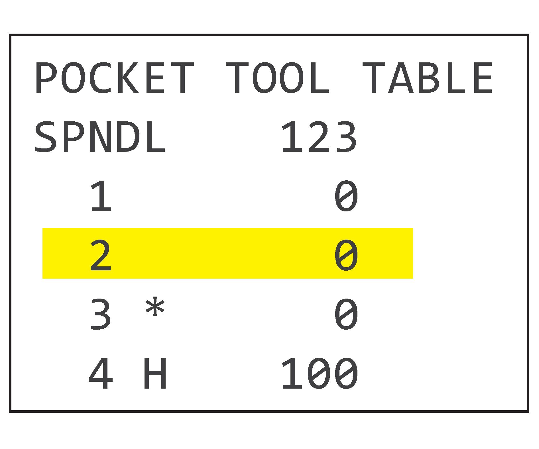

Example - Install tool #123:
- Select an empty pocket. You selected pocket 2, highlighted in yellow.
- 123 WRITE/ENTER
- You just told the machine that tool 123 is in pocket 2.
- RESET
- T123 ATC-FWD
- The mill performed a tool change from pocket 2 (empty) into the spindle.
- There's no tool in the spindle, even though it's listed in the PTT.
- Open the door and put tool 123 into the spindle.
- The PTT and the machine are now in sync.

4. Use a tape measure to measure the length of the tool.
- Measure from the tip of the tool to the base of the spindle.
- Be within 1/4".
- Be within 1/4".
