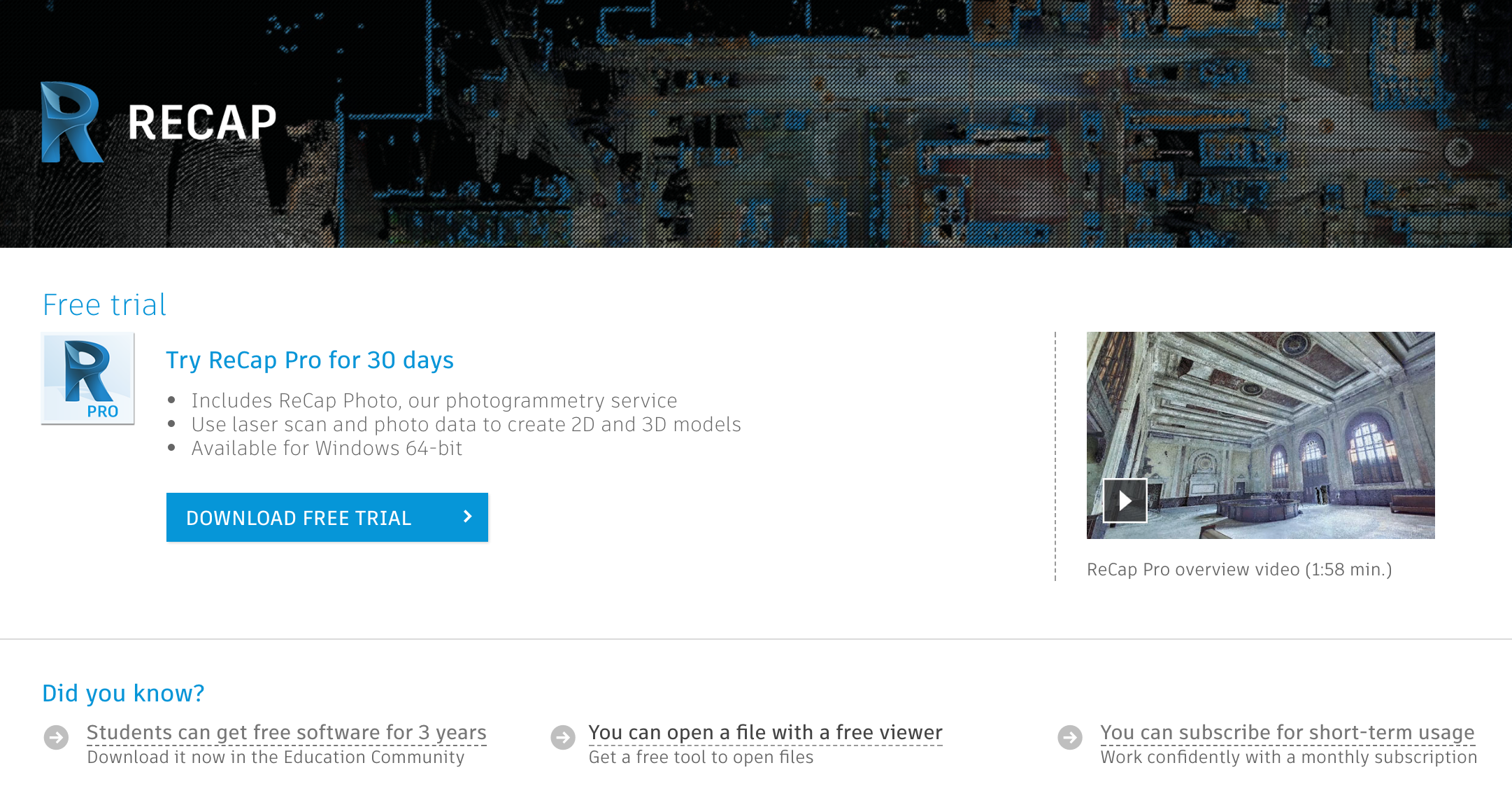

- Autodesk ReCap Photo (or another 3D capture program): ReCap Photo is part of ReCap Pro which is free for 30 days, $40/month for a subscription, or free for students or educators

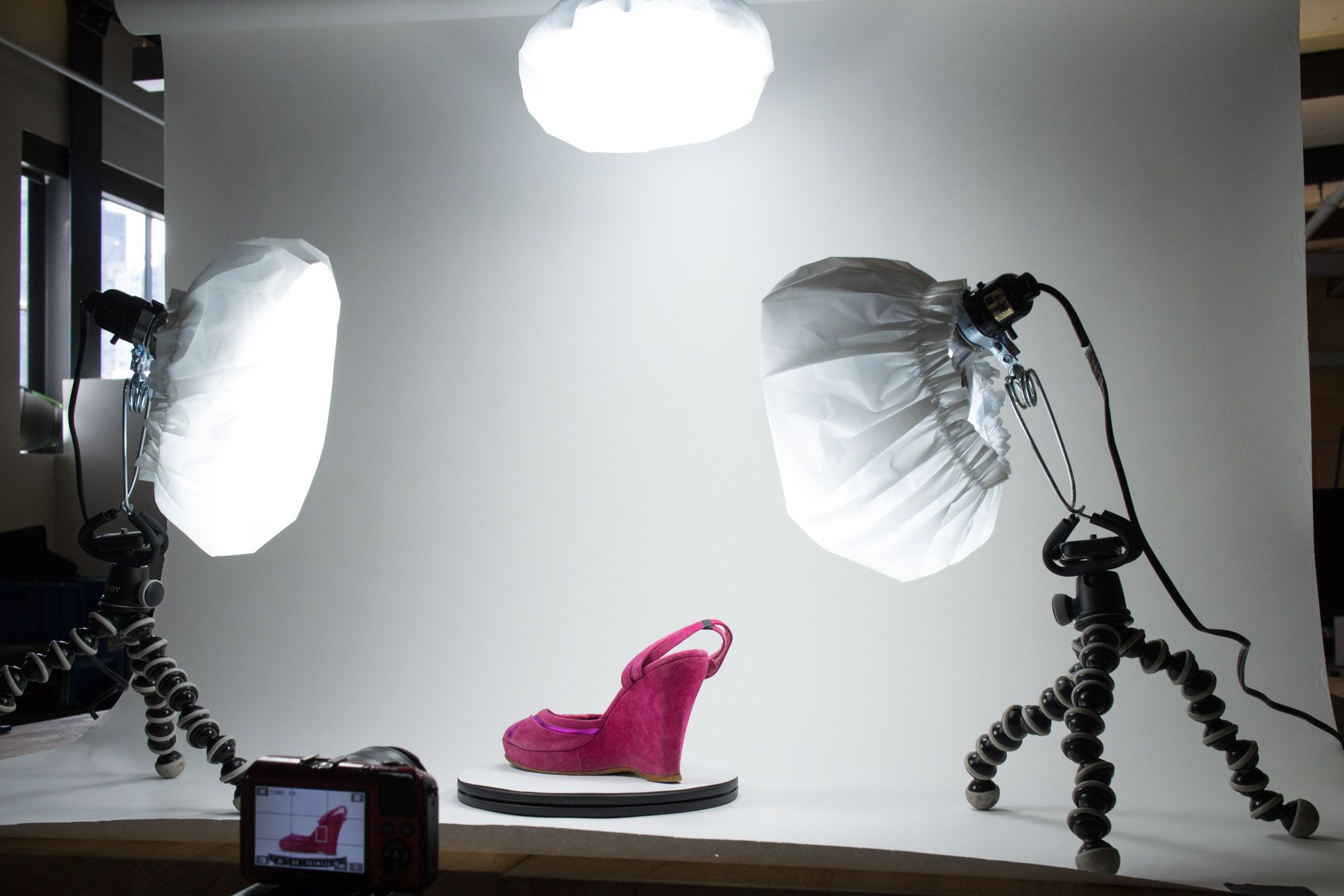

The right kind of lighting is crucial to photogrammetry, so If you can't find even natural lighting, you'll need to have a few diffused portable lights. You can buy more pricey versions of these lights or you can create a relatively cheap DIY version using clip lights and shower caps by following the project in this lesson of audreyobscura's great Photography Class.

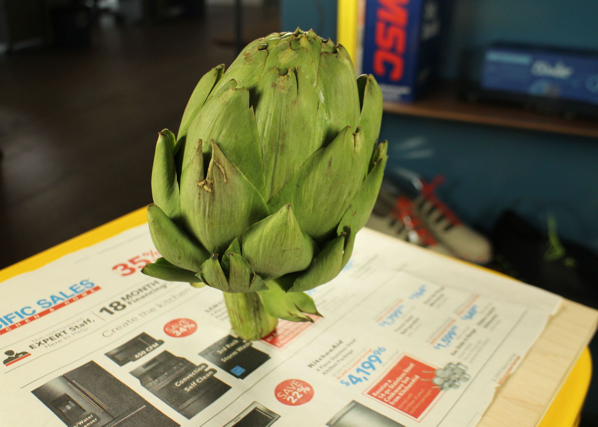

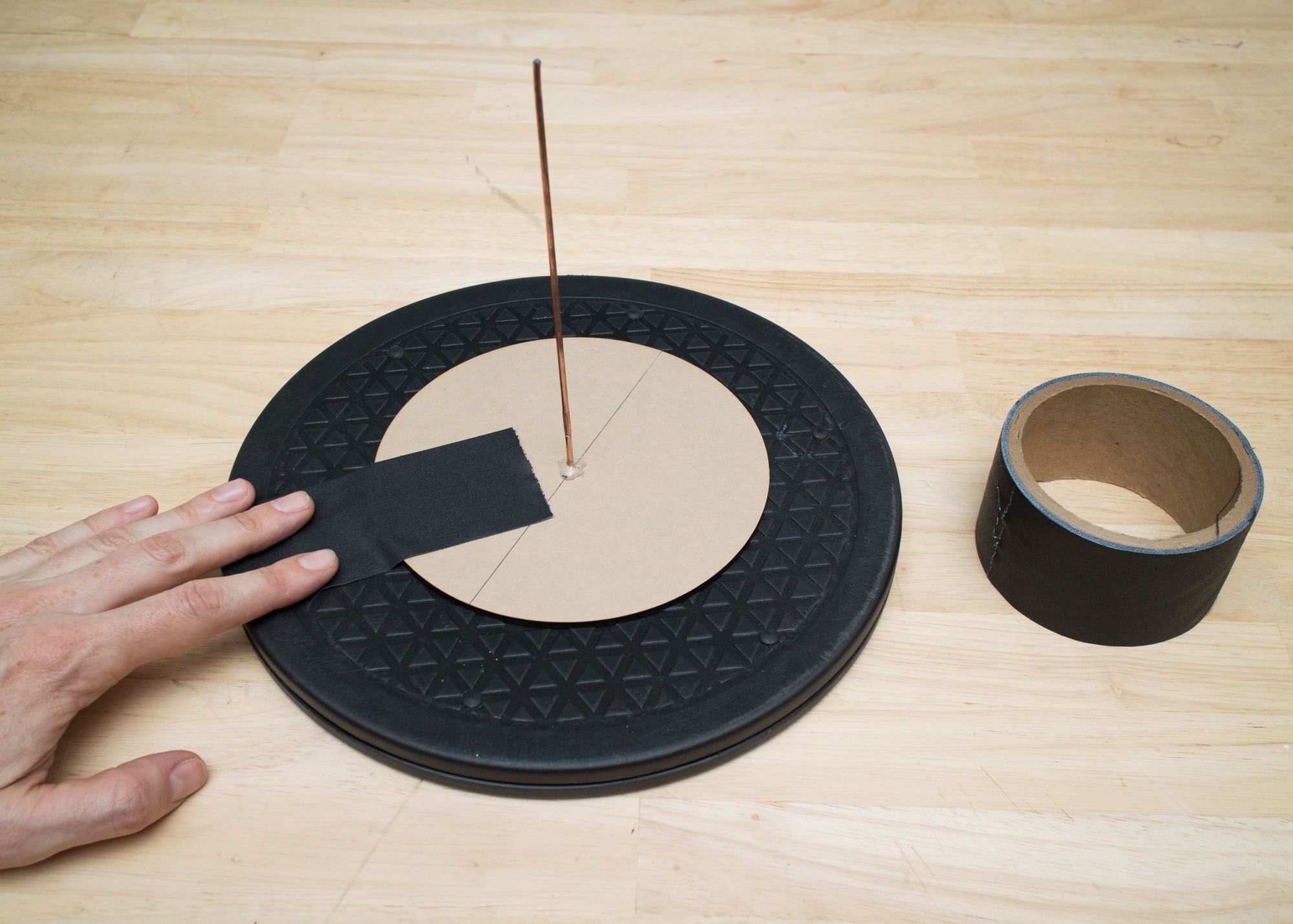

In addition to this, you may need a way to fixture some objects in a specific position to capture as much of them as possible in your scan. For example, to scan this artichoke, I created a simple fixture by pounding a nail through a square of plywood and sticking the stem of the artichoke on the nail, and when I was using the rotating object method, I attached a stiff wire spike to my lazy susan to hold small objects.
To shoot a rotating object, you need slightly more equipment. First of all, you will need some kind of manual rotating turntable or lazy susan to place your object on. Depending on how large or heavy your object is, you will need a different sized turntable. You could also make your own fairly easily by following this Instructable by the awesome tomatoskins.

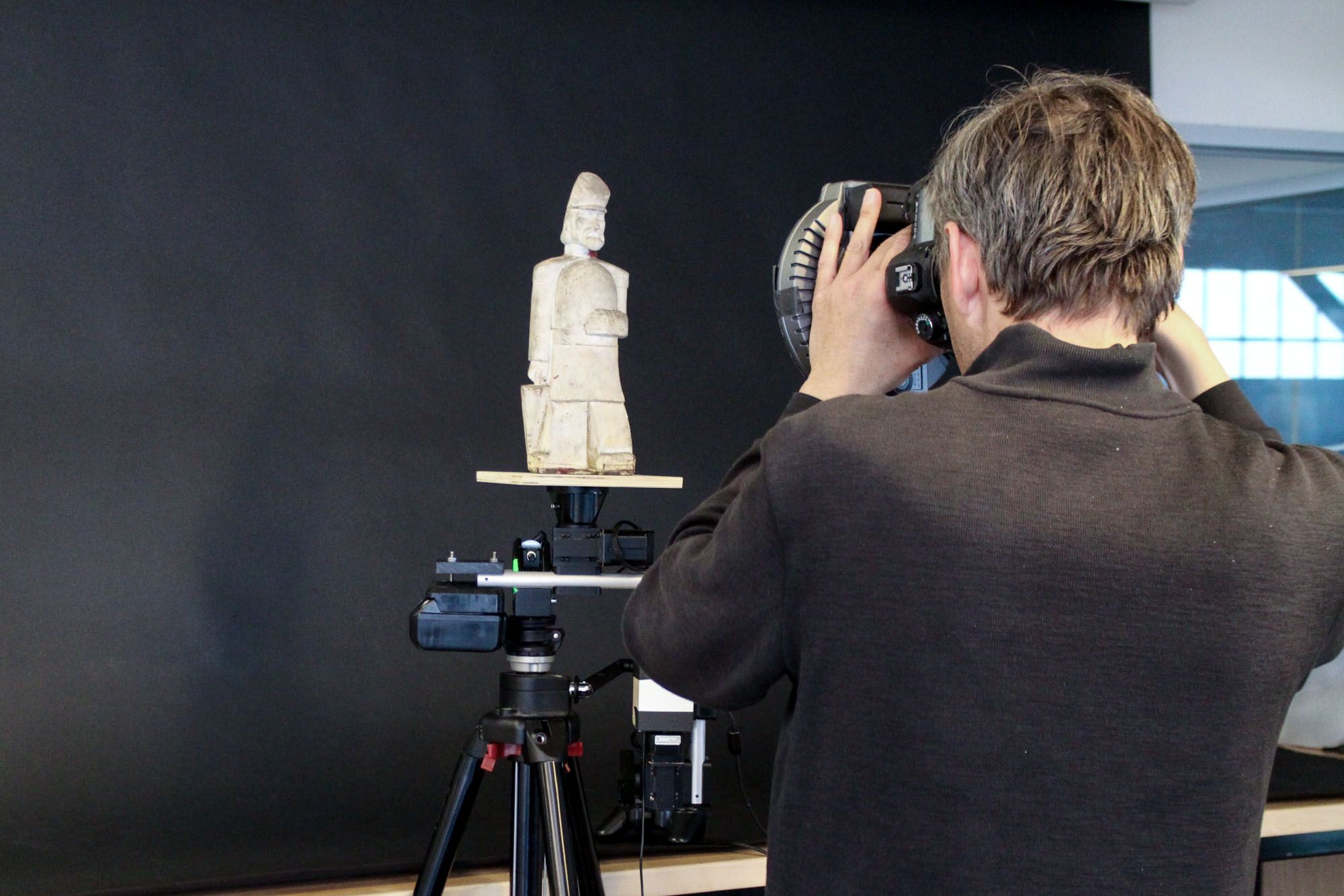

When you are shooting a rotating object, you need the background to be as featureless as possible (I'll explain the reason for this later) so you will need to shoot against a seamless backdrop, a sweep, or inside a shooting tent. Black backdrops tend to work best unless your object is especially dark.
For this method you absolutely need a tripod to hold your camera in one place and some kind of lighting set up like the one described above. Another good lighting option for this type of shooting is a ring light that goes around your camera lens.
If you are really ambitious, you can try creating some kind of automated rotating capture rig like this one by Downunder35mm.

You can try a 30 day trial of ReCap Pro with ReCap Photo for free, which gives you the ability to upload unlimited photos and create as many models as you want in that time. After that you can choose to purchase a pro version for $40/month or $300/year. ReCap Pro is free for 3 years for educators and students though! And the definition of student and educator is fairly broad here, so if you can, try to register for an education license.
The one downside is that ReCap Pro is only available for Windows. But there are ways around this if you are a Mac user like me. You can install Windows on your Mac using Bootcamp so you start your computer with either a Mac or PC interface, or use Parallels to run both systems simultaneously. You can also subscribe to Frame for $10/month which will give you a virtual cloud based Windows desktop.
