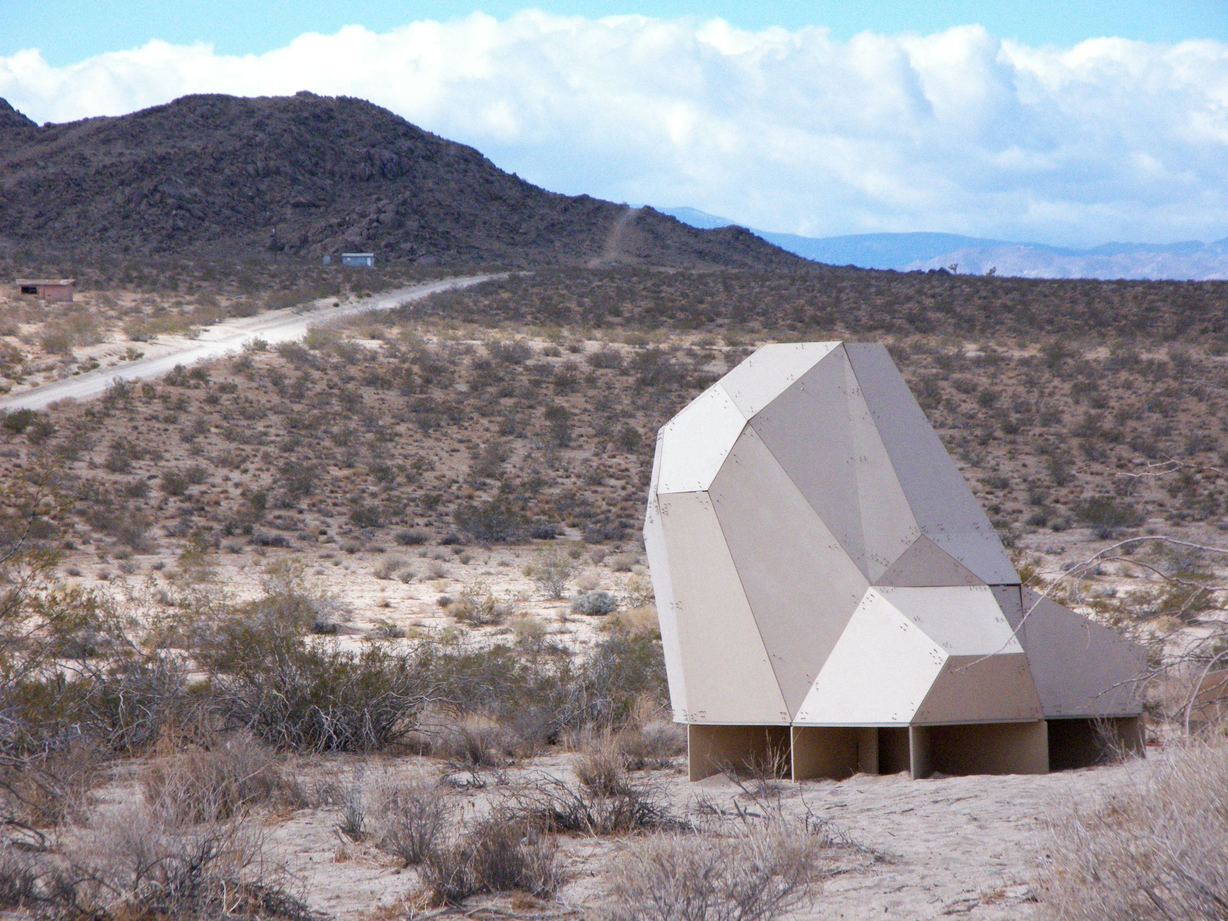

I think the CNC router is the most powerful DIY tool in the world. Although 3D printers and laser cutters are great for making all kinds of things, they're very limited when it comes to size and structure. With a CNC router and enough plywood, you can literally make a house. I made this 9' tall semi-permanent shelter for two campers using $250 worth of MDF, some flexible metal flaps, wood screws, and a CNC router...
Ungloo, Joshua Tree, CA, 2008

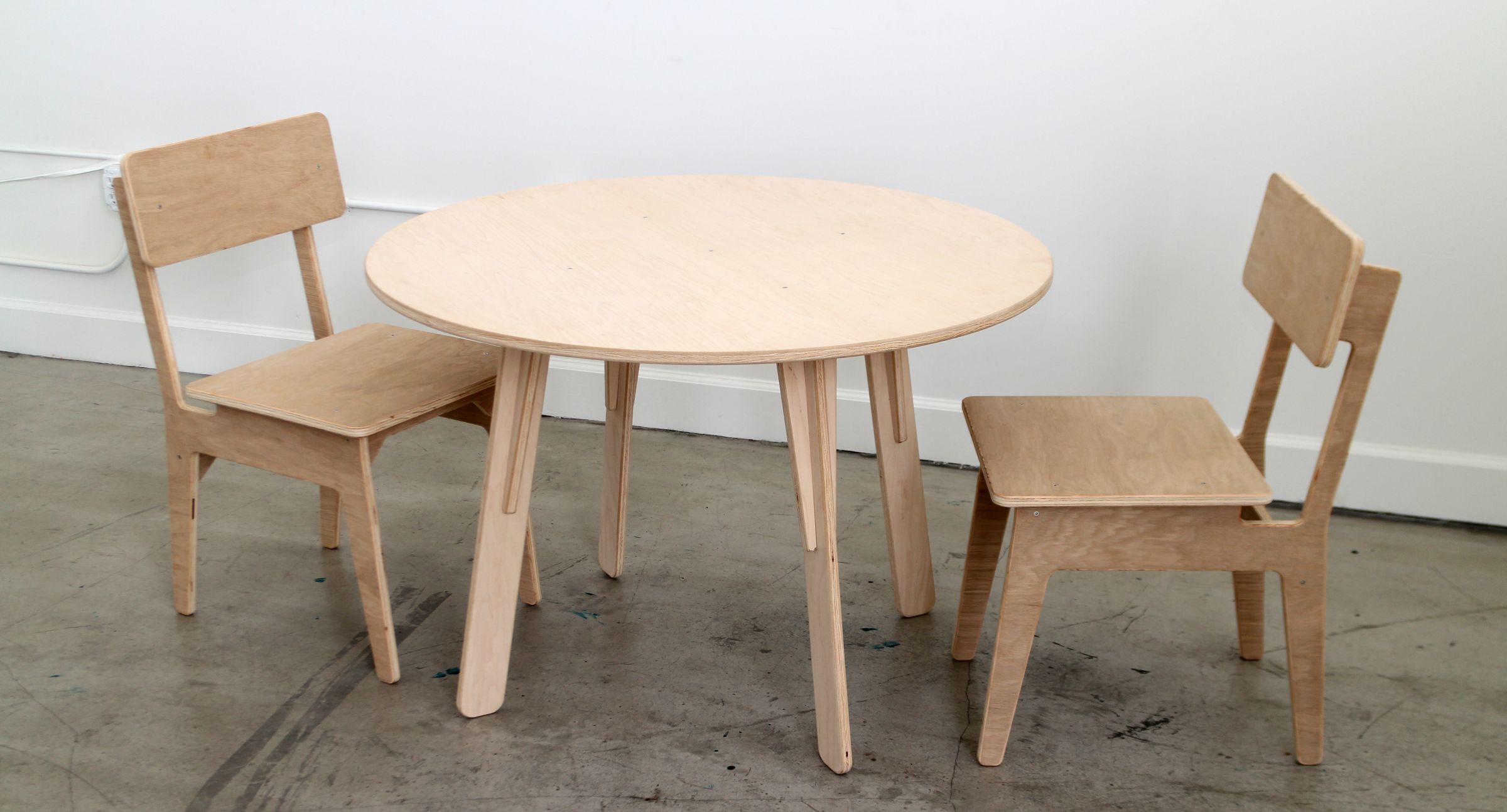

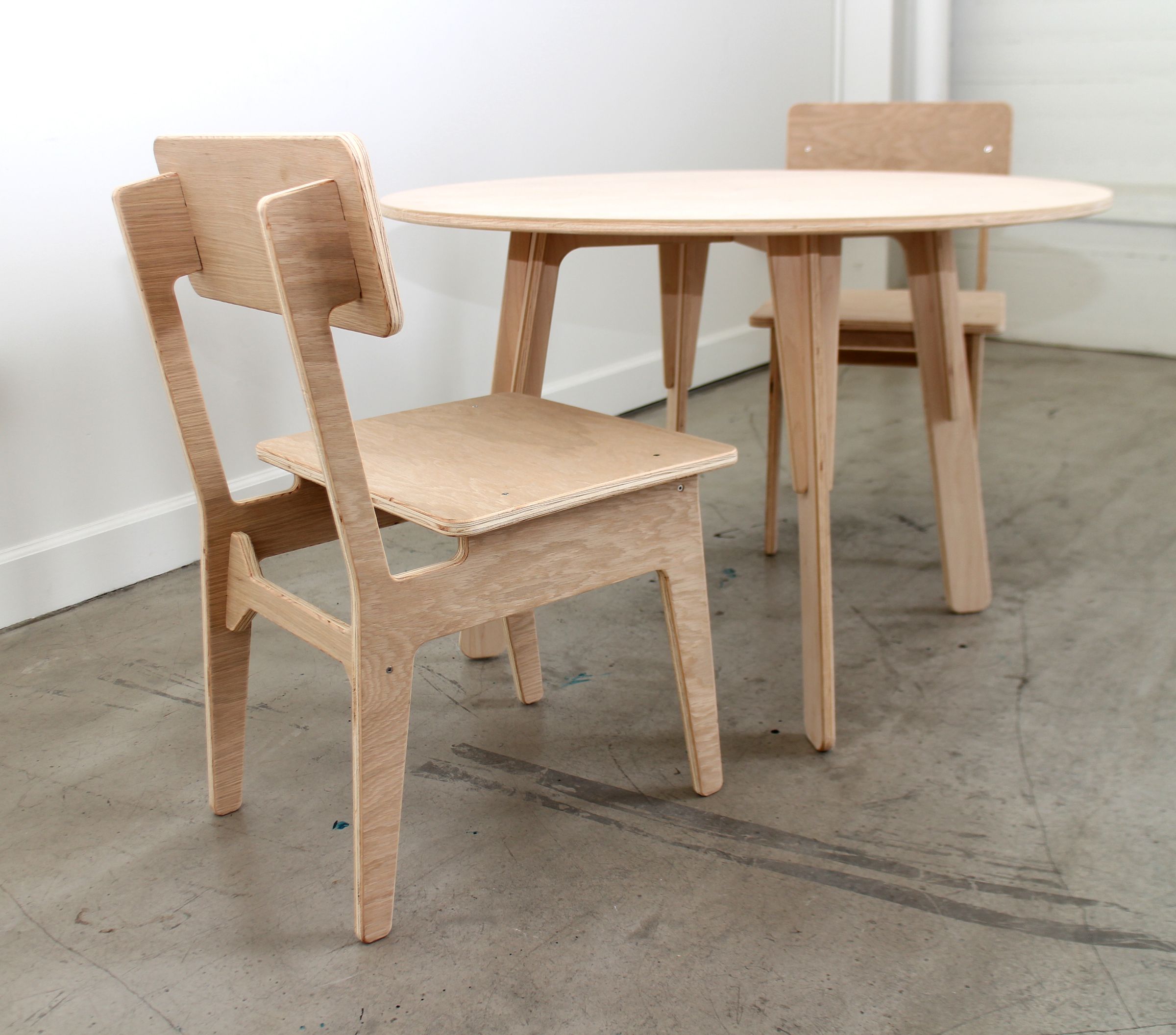

PROJECT 2: Dining Table + Chairs

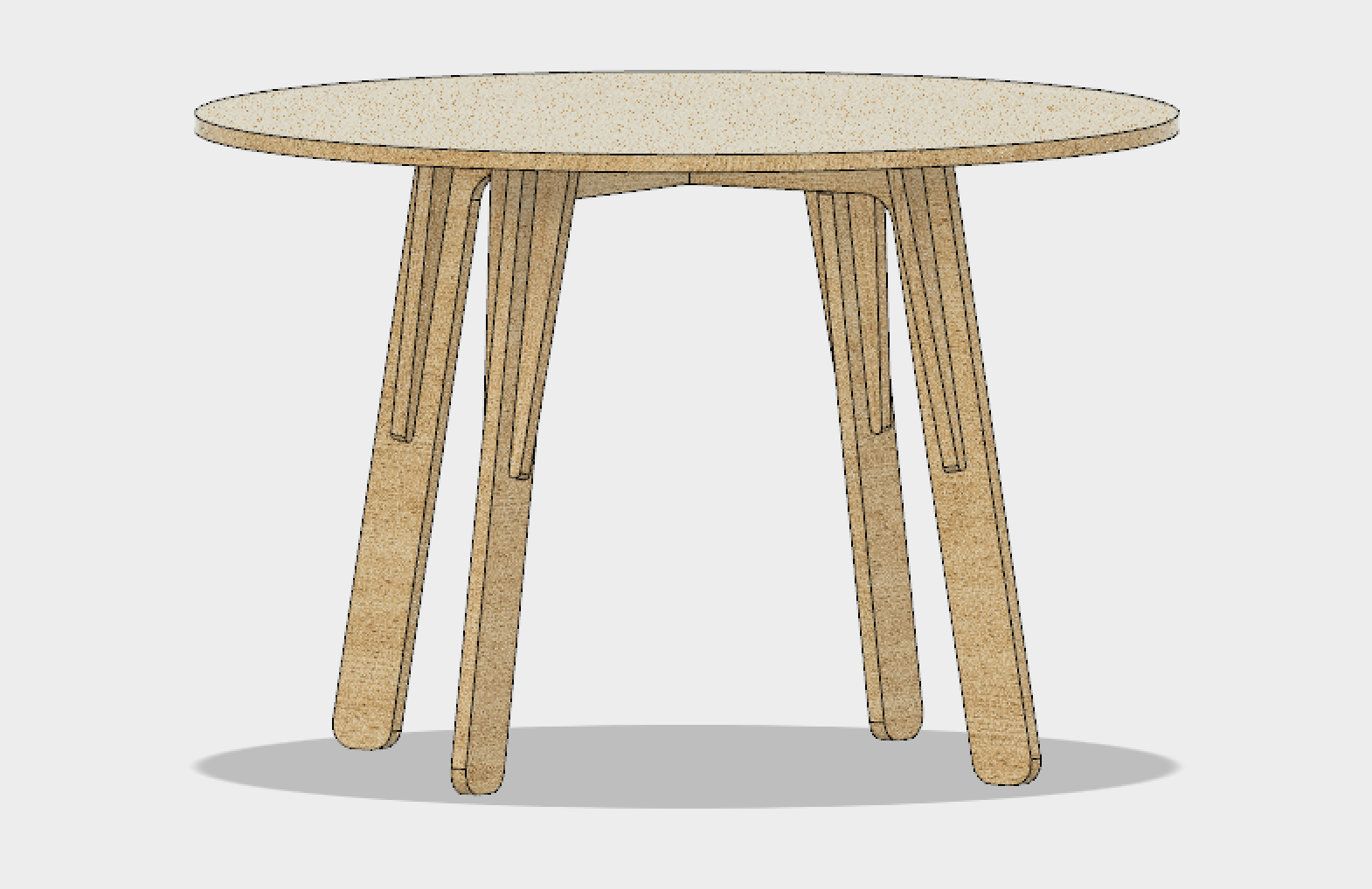

To learn the subject, we'll focus on flat-pack design by making a full-sized dining table. We'll design it in Fusion 360, a free CAD modeling suite complete with a sophisticated CAM environment. We'll make this project on the Shopbot CNC Router, a machine shop tool that can be found in maker spaces worldwide.
Flat-Pack Dining Table
Finally, we'll get some practice with more complex geometry by designing a flat-packed dining chair to go with the table. Since we're using CNC, we can make as many copies as we want in no time!
Flat-Pack Dining Chair

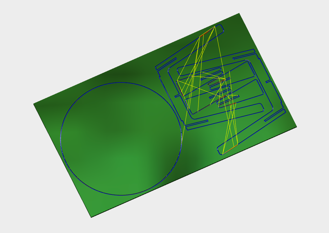

2. CAM Setup
CAM (Computer Aided Manufacturing) involves taking one or more 3D objects and creating a G-Code tool path that will cut out or mill the parts as desired. Another reason we're using Fusion 360 is that CAM is built into the software, so all you have to do is switch from one workspace to another to work on the CAM setup.
You'll also be able to change a design, then update the CAM setup to work with the changes you've made. This makes it easy to experiment and improve your designs as you cut out parts.

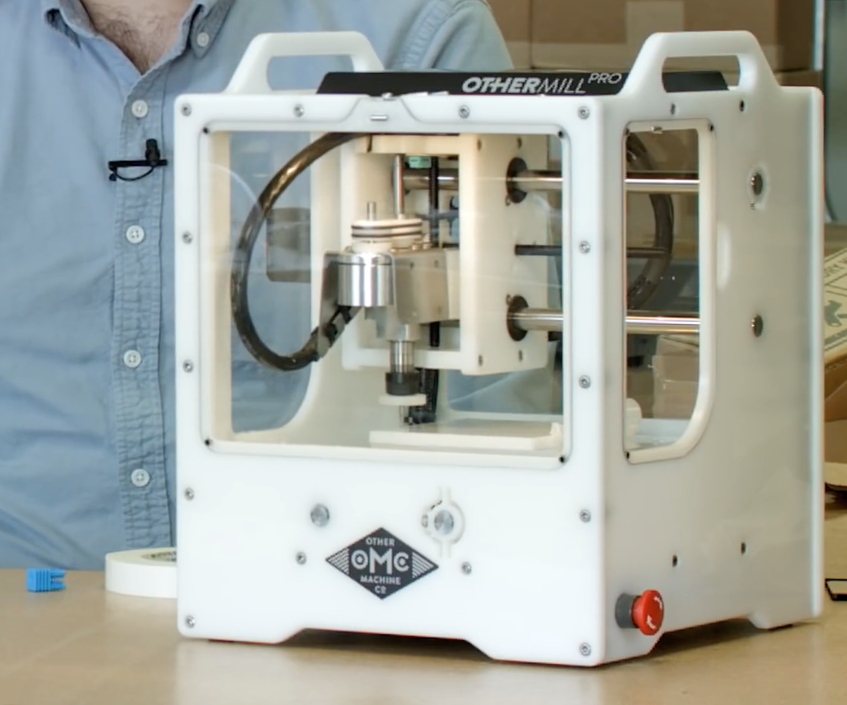

Other Machine Co. Othermill
Other Machine Co. makes a small, desktop CNC machine that I'll use in Lesson 5. It's made for PCB boards specifically, but it's a fully functioning CNC mill with a 2" maximum depth. It's great for small parts and a good option if you've got limited space.

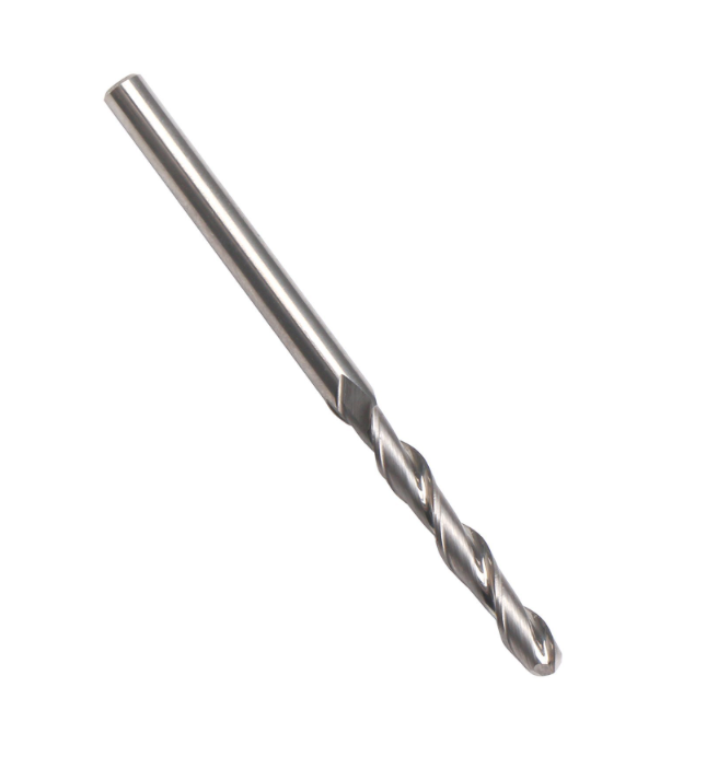

End Mill for Small-Scale Carving
For the desktop CNC carving project, a ball-nose 1/8" end mill is a good choice. This type of end mill lets you get a smooth finish on a carving project because the round shape helps you avoid the stepping effect you'd get from a flat profile tool.
Amazon: 1/8" Ball Nose End Mill

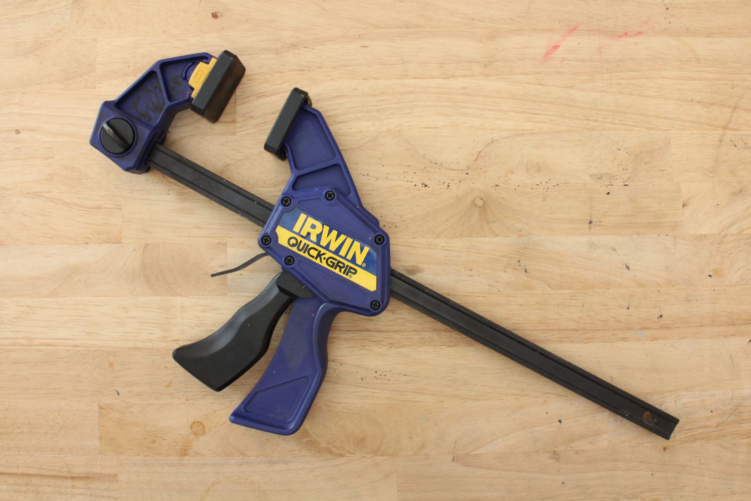

Clamps for Work-holding and Assembly
I like the Irwin Quick Grip- it's very sturdy and easy to use. These are great for holding material if you don't have another hold-down system and they're crucial for sanding and assembly.

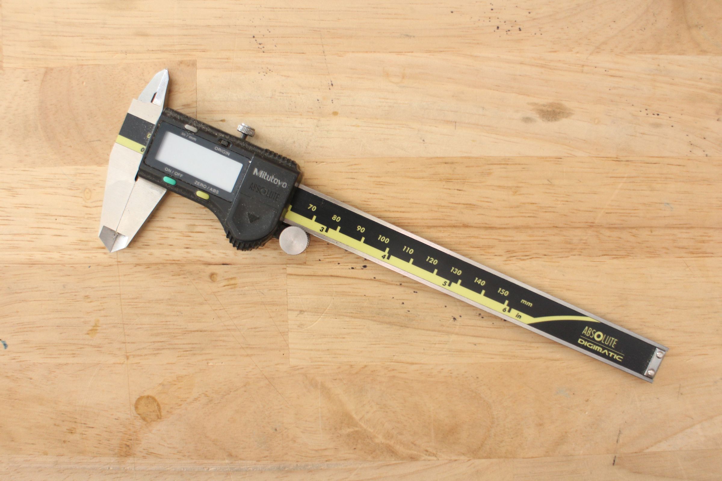

Digital Calipers
These are an absolute must. You have to know the exact thickness of your material for any CNC project.

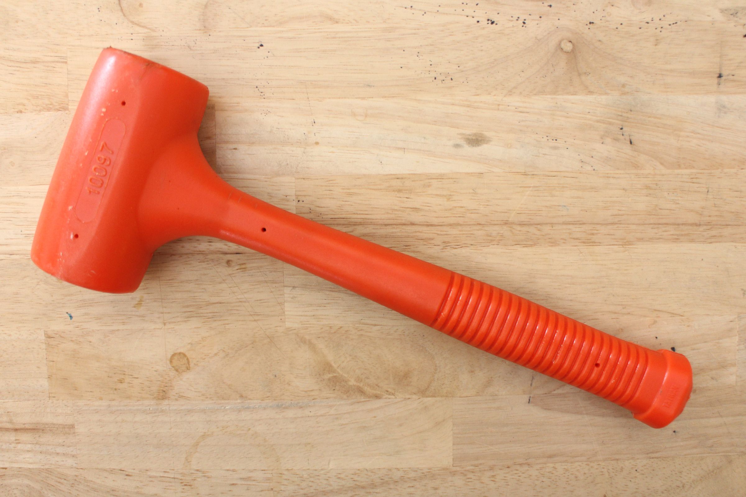

Soft Hammer
You'll need these for assembling flat-pack parts and for nudging large sheets into place on a full-size machine.

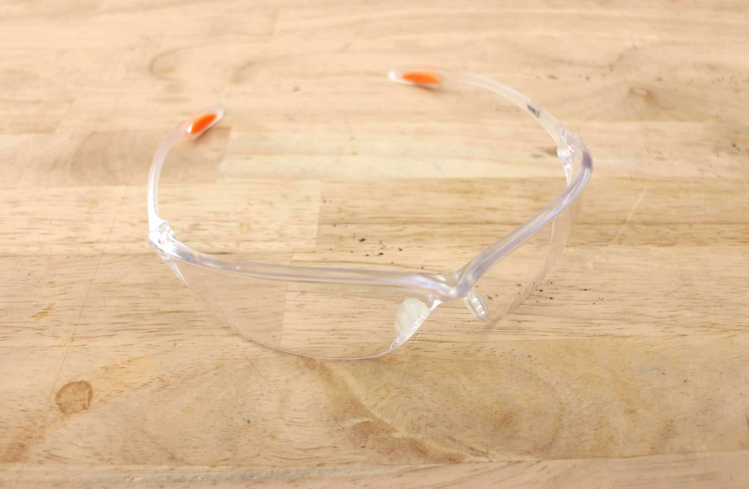

Safety Glasses
I've seen parts get jammed in the tool and fly across the room. ALWAYS WEAR SAFETY GLASSES.

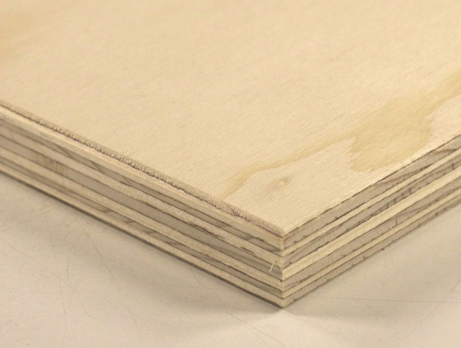

Plywood
I'm using 3/4" A-grade maple veneer plywood for the flat-pack project. You can use CDX if you want, but the A-grade stuff is much nicer to work with and requires less finishing work.

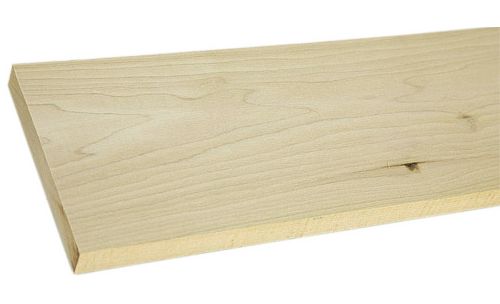

Hardwood
I'm using Poplar for the carving project, but solid wood or plywood will work for this one as well.
