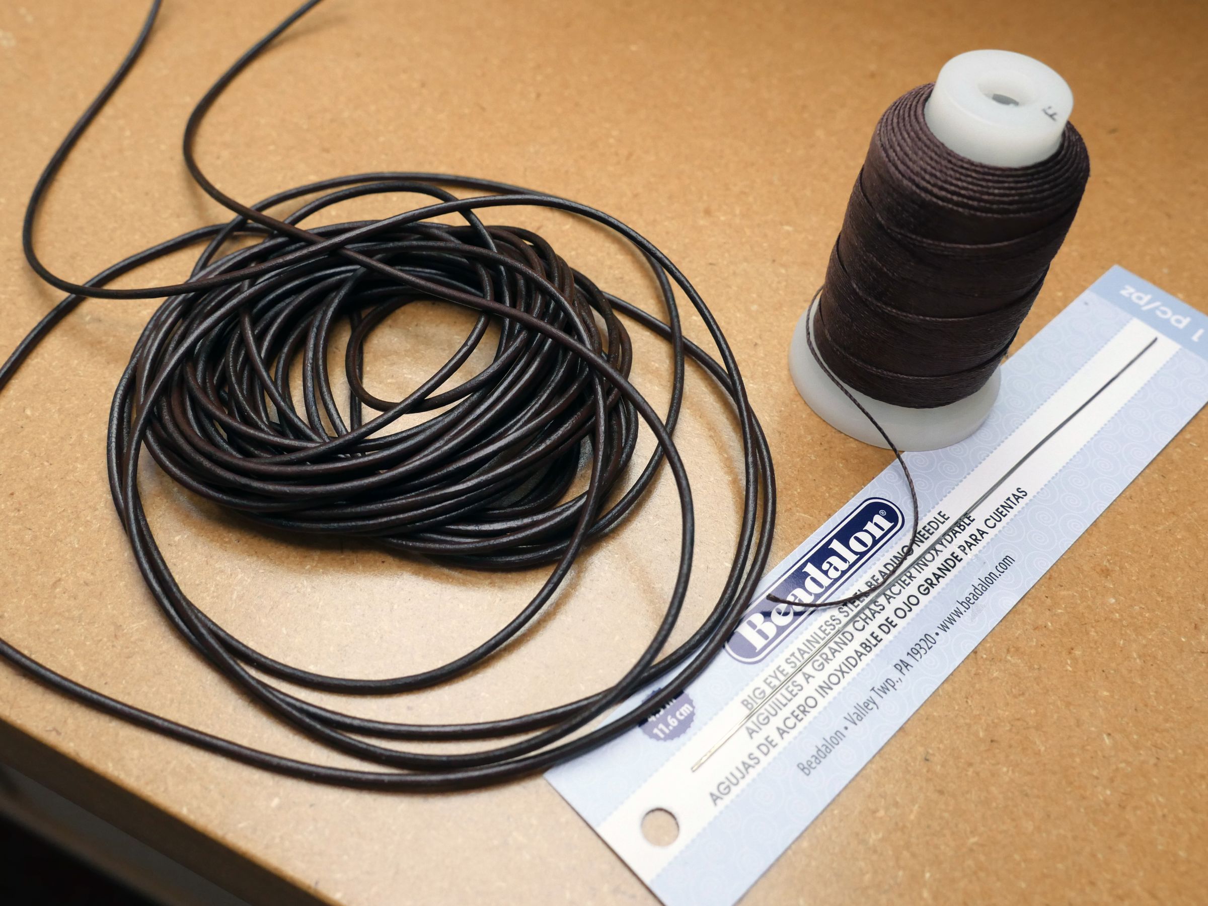

Leather cord and coordinating silk beading cord are available in a wide variety of colors and sizes. Beading needles are especially long, flexible, and have large eyes to easily accommodate the beading cord.

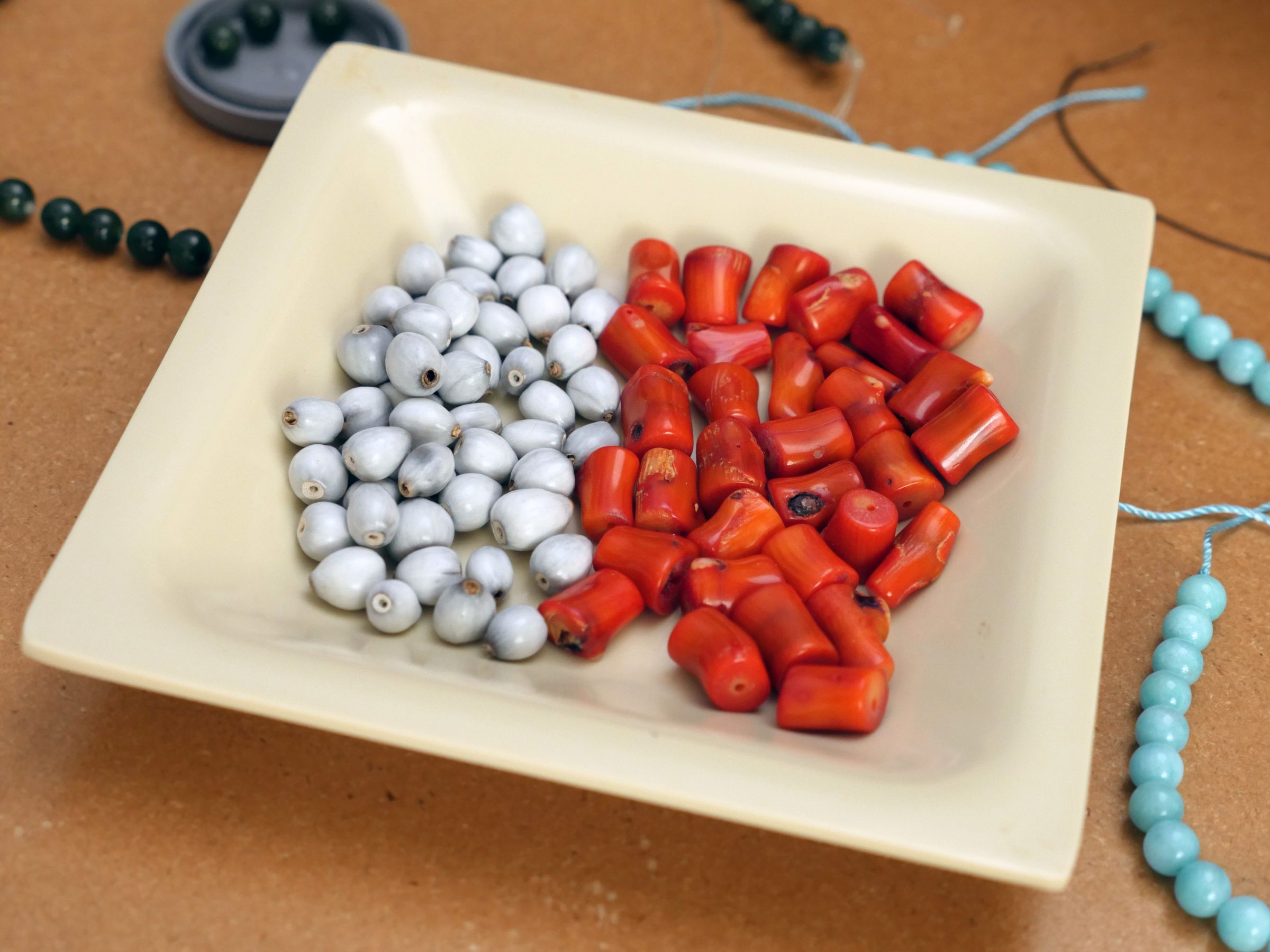

Beads can be made from almost any material. This class uses round blue 6mm beads made from Amazonite stone, but you're welcome to use beads in the material of your choice, whether it's stone, crystal, or something else entirely, like seed pods and coral (pictured above).

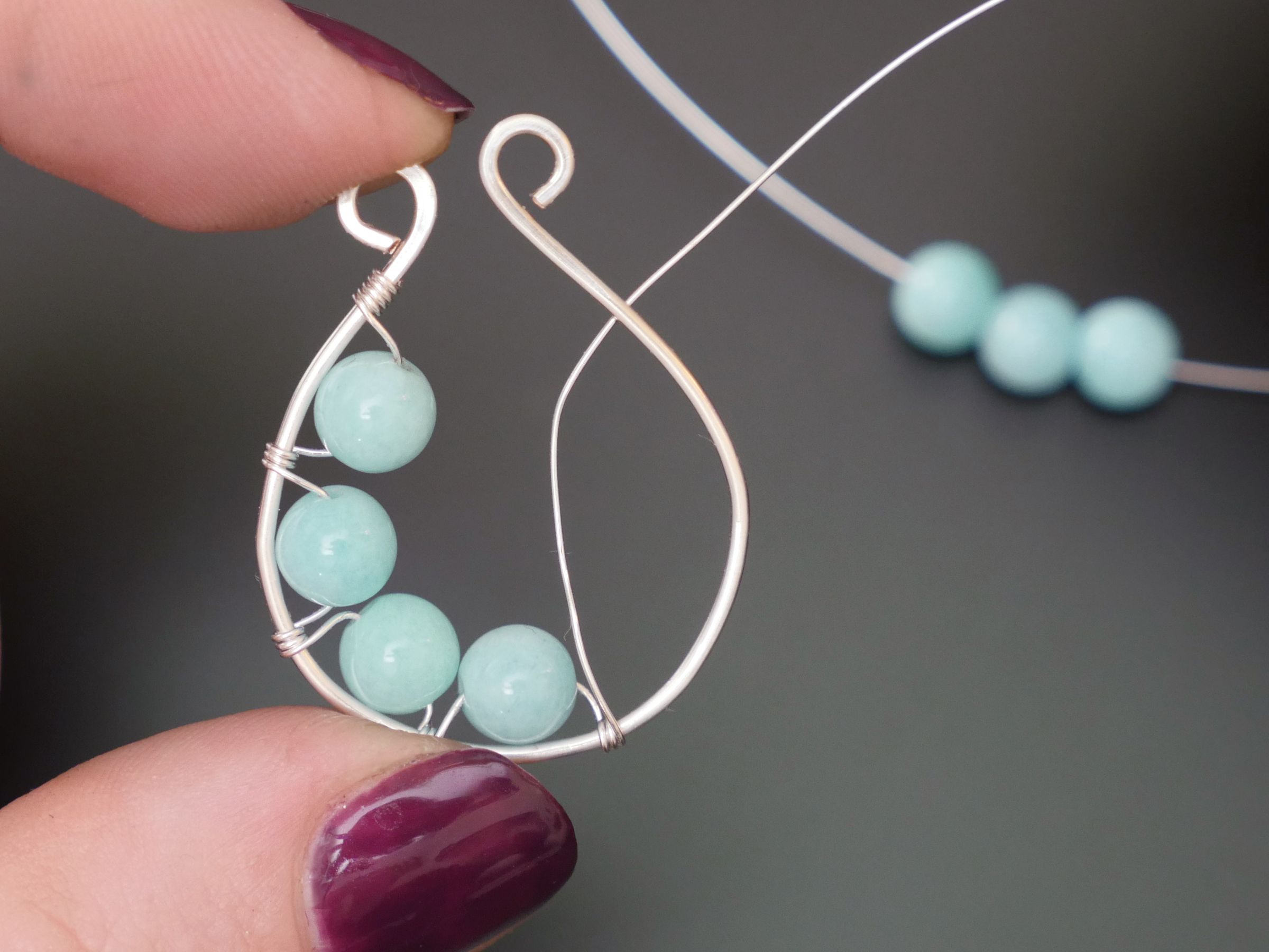

The wire wrapping project in this class uses the same round beads to make some silver-toned earrings with two different thicknesses of silver-plated wire (26ga and 18ga). Small jump rings and ear wires are called jewelry findings, and they too are available in different styles and sizes. If you prefer a different wire color, go for it!

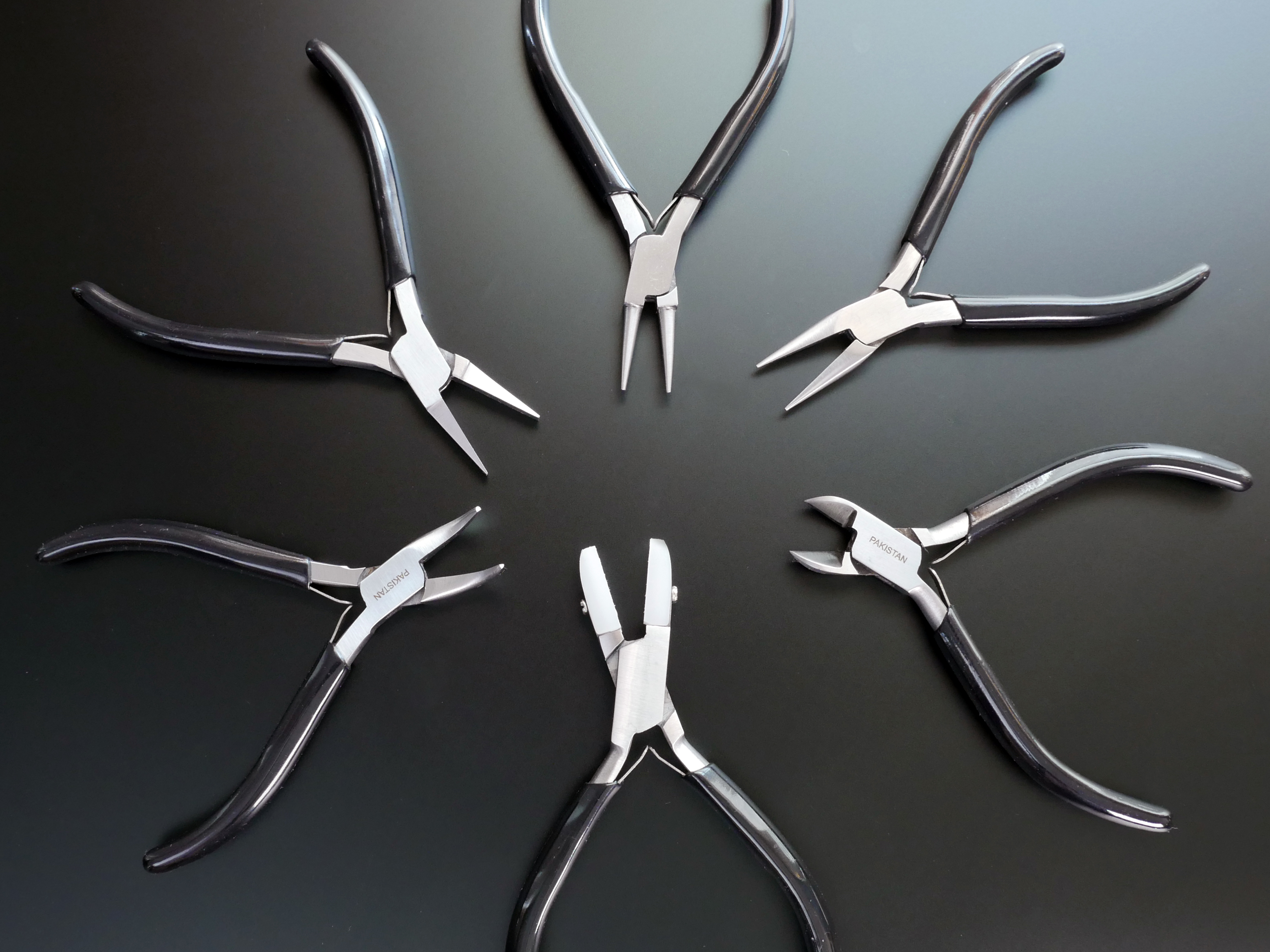

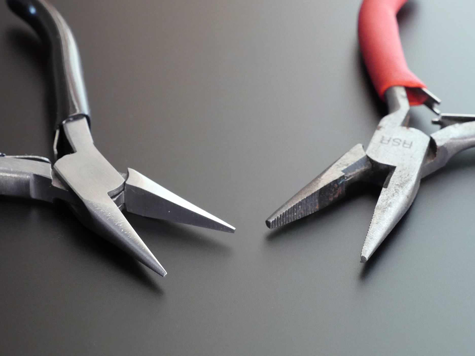

A variety of clean, smooth-jawed pliers is essential for making jewelry with wire. Jewelry pliers have smooth surfaces (no teeth to imprint marks on soft jewelry), and come in different shapes for different purposes. Yes, you really do need this many! To open and close jump rings, you will use two pairs of pliers at once. Do yourself a favor and get a dedicated set of jewelry pliers!

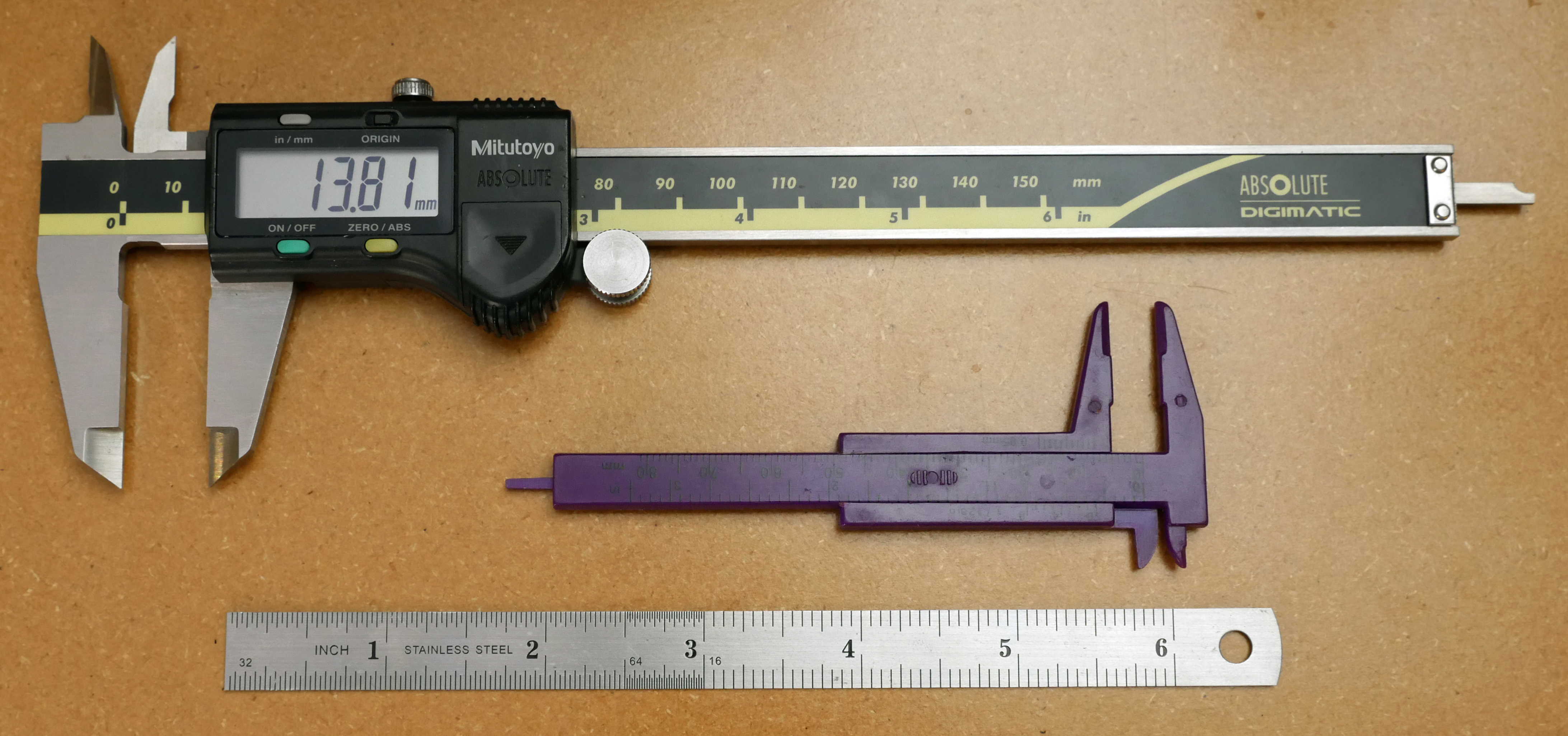

Jewelry is a precision craft. At the very least, you'll need a small ruler to measure materials and draw straight lines. Analog or digital calipers can help you determine the size of beads, wire, and sheet metal after they've been collecting in your supplies box, but aren't strictly necessary to complete any of the projects in this class.

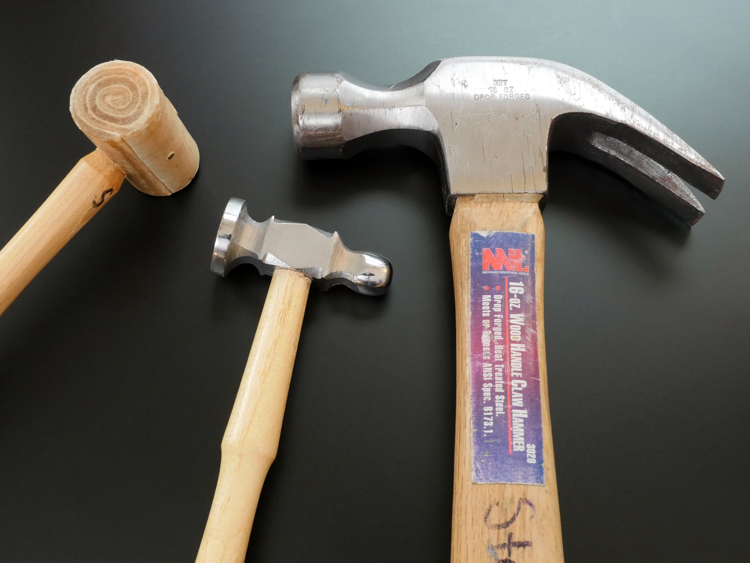

A bench block is a smooth (usually stainless) steel surface that's used for hammering. Use a smooth chasing hammer for pounding wire flat or applying surface texture. Use a rawhide mallet (or nylon mallet) to shape metal without deforming the surface, like when you want to straighten round wire or flatten smooth-finished sheet.

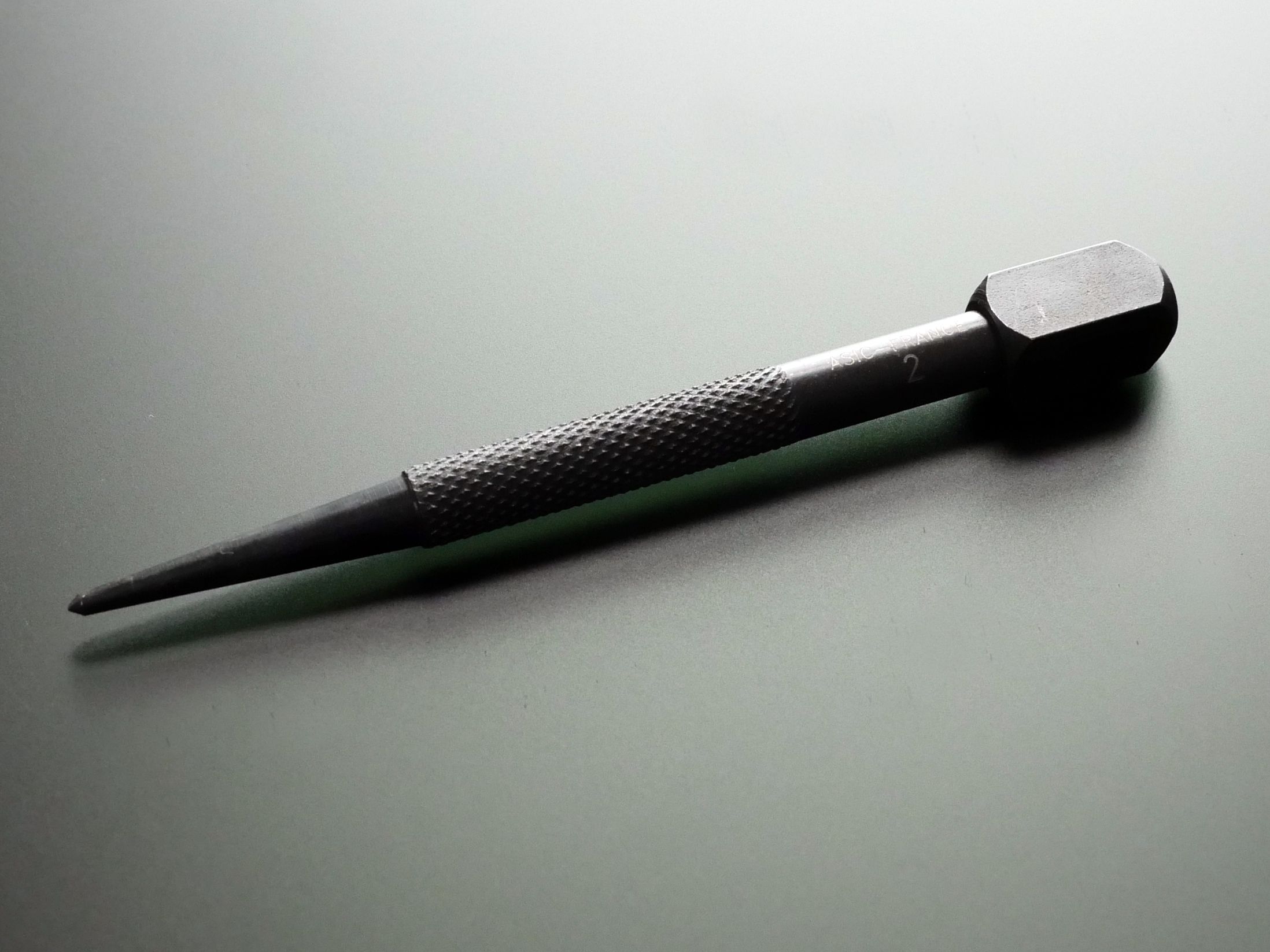

A full size carpenter's hammer comes in handy for driving a sharp center punch, which is the first step in drilling a hole in sheet metal. Don't use your polished chasing hammer with steel tools; you'll scratch up the surface, and those scratches will transfer to other work later!
There are many more specialty jewelry hammers for all kinds of shaping and texturing, but these three will get your collection started and help you complete the projects in this class.

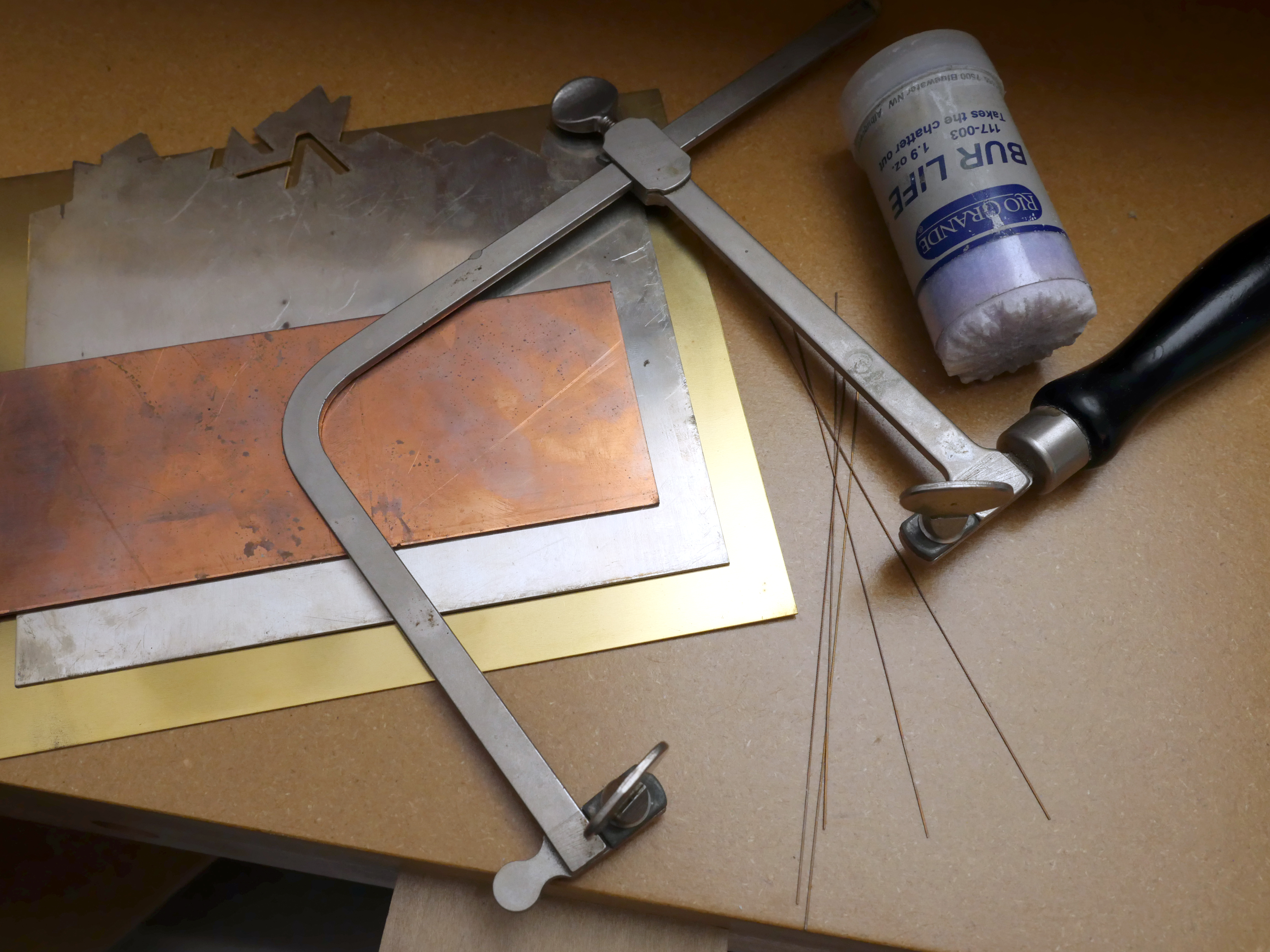

A jeweler's frame saw is fitted with tiny blades to cut intricate shapes from sheet metal. You can use any 18 gauge (1.1mm) non-ferrous metal for this class (copper, brass, sterling silver, etc.), which differ greatly in price. A bur lubricant is needed to reduce stress on the fragile blades.

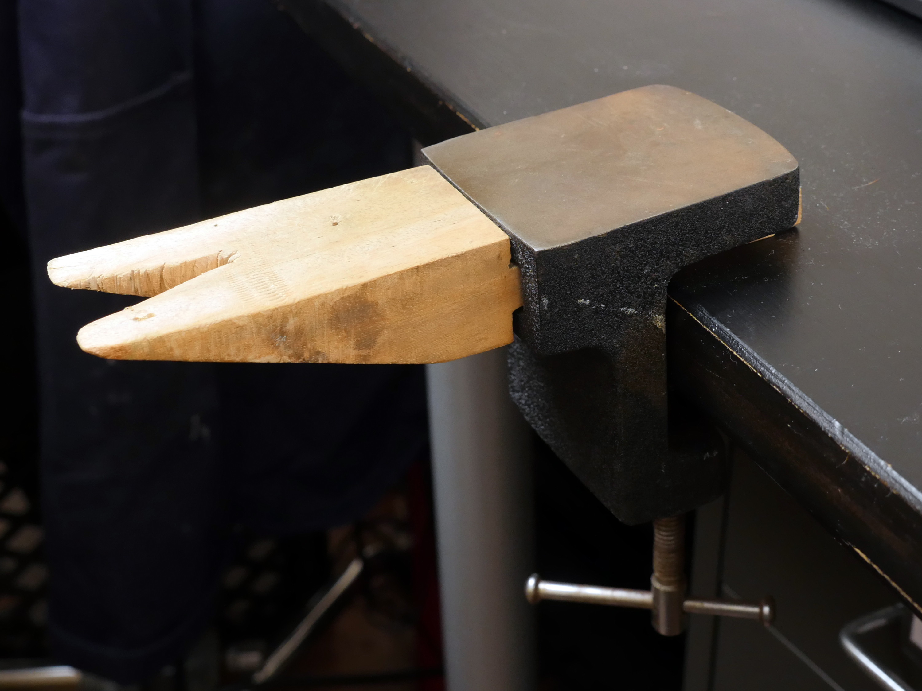

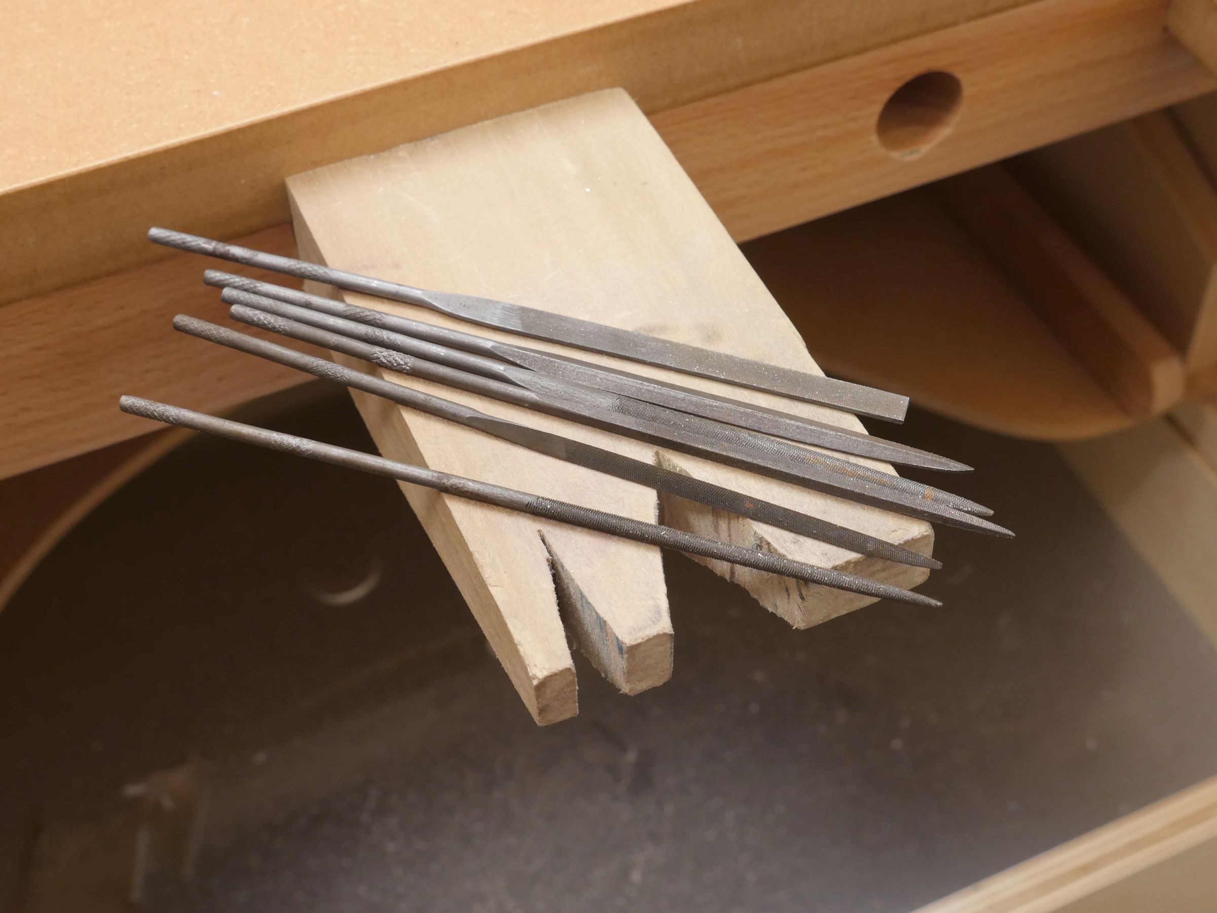

To work with small bits of sheet metal and other in-progress metal jewelry, a sturdy bit of wood with a V-cut (called a bench pin) is extremely helpful. It'll let you brace your work and access every nook and cranny as you cut, file, sand, and polish. You can transform any sturdy table into a jewelry bench with a clamp-on bench block/ bench pin combo. New bench pins may require you to cut the notch yourself, so if you don't have a hacksaw handy, double check the one you buy already has a notch.
Needle files help you refine your metal's shape and prepare for sanding, and come in different shapes. Get a variety set to dedicate just to soft jewelry metals.

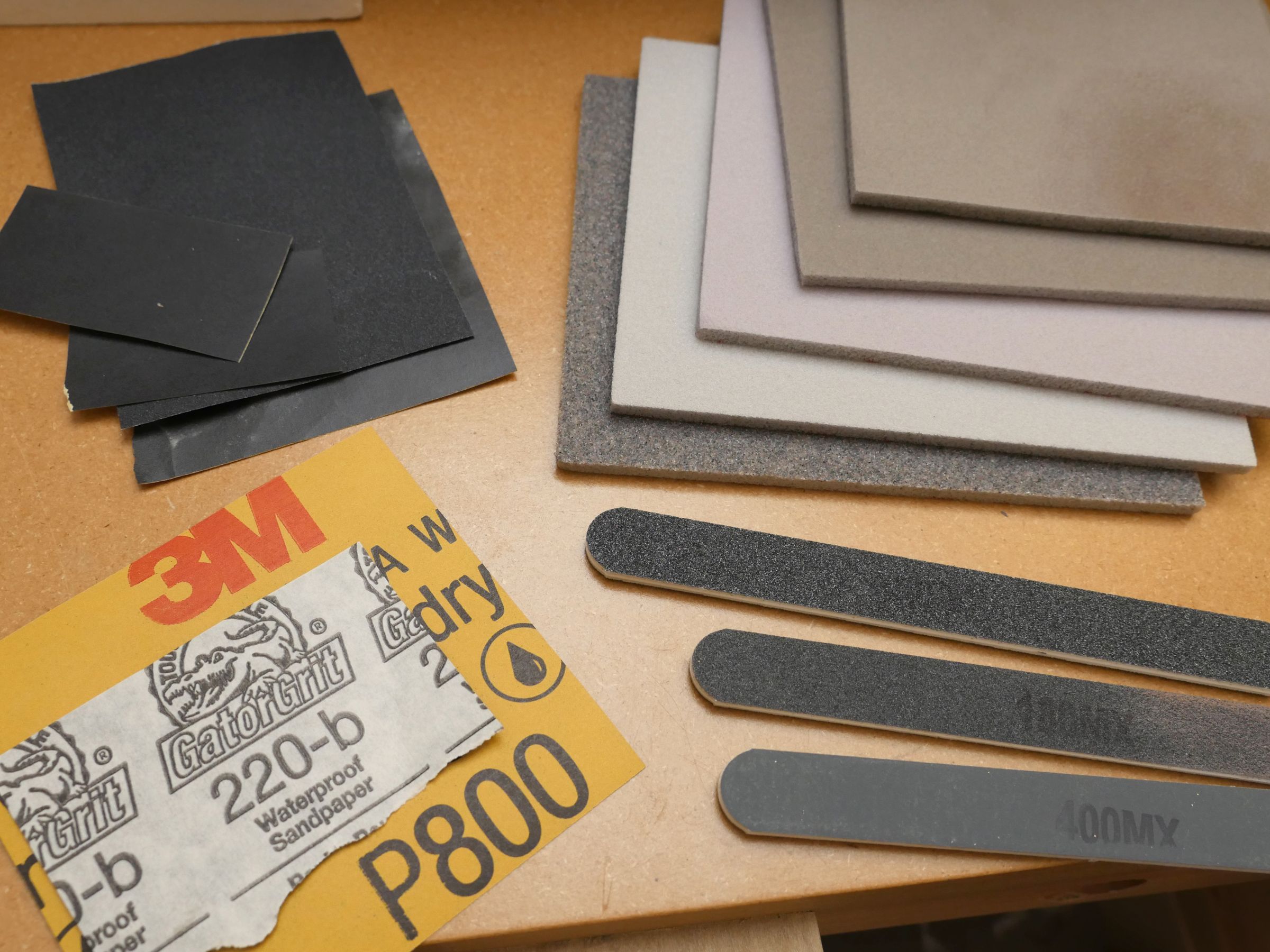

To refine the surface of your metal, you'll use sandpaper of coarse to fine grit, which refers to the abrasive particle size. You can tape sandpaper to a flat surface to create a mini sanding board, and get sanding boards that work like nail files. If you don't plan to polish your projects with a rotary tool, you can achieve a very respectable lustrous surface by finishing with some superfine sanding pads.

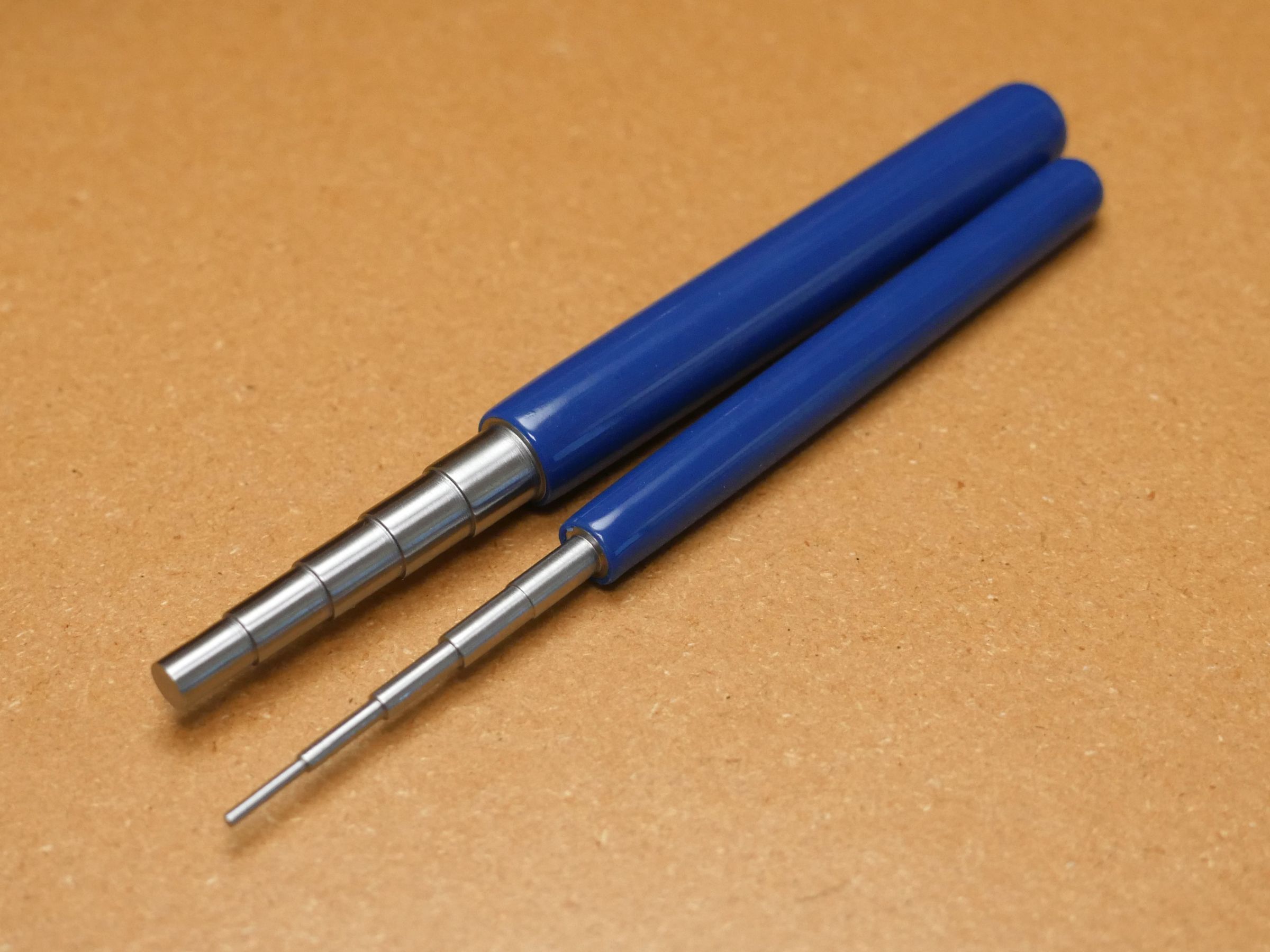

To form perfect circles, loops, and other rounded shapes, you'll use steel mandrels. The small step mandrels pictured on the left are useful for small wire projects, and the large ring mandrel on the right will be used to shape your soldered silver rings.

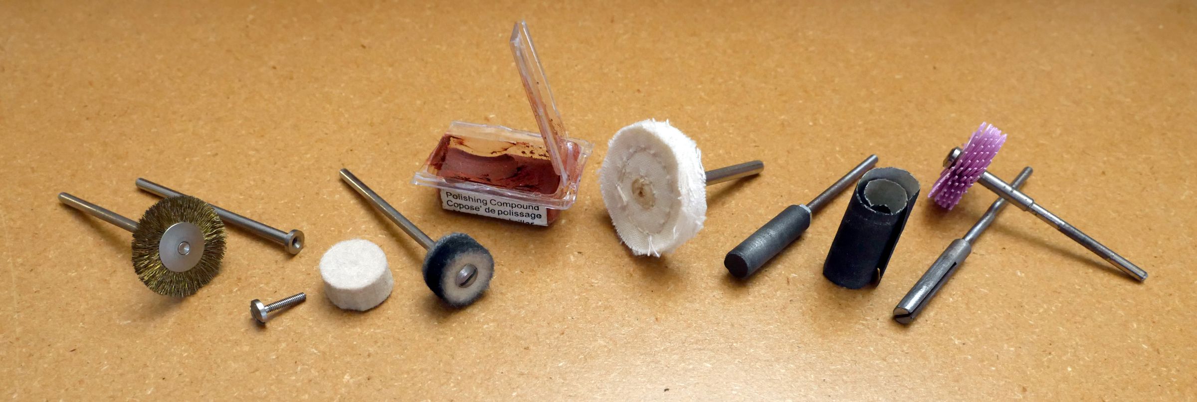

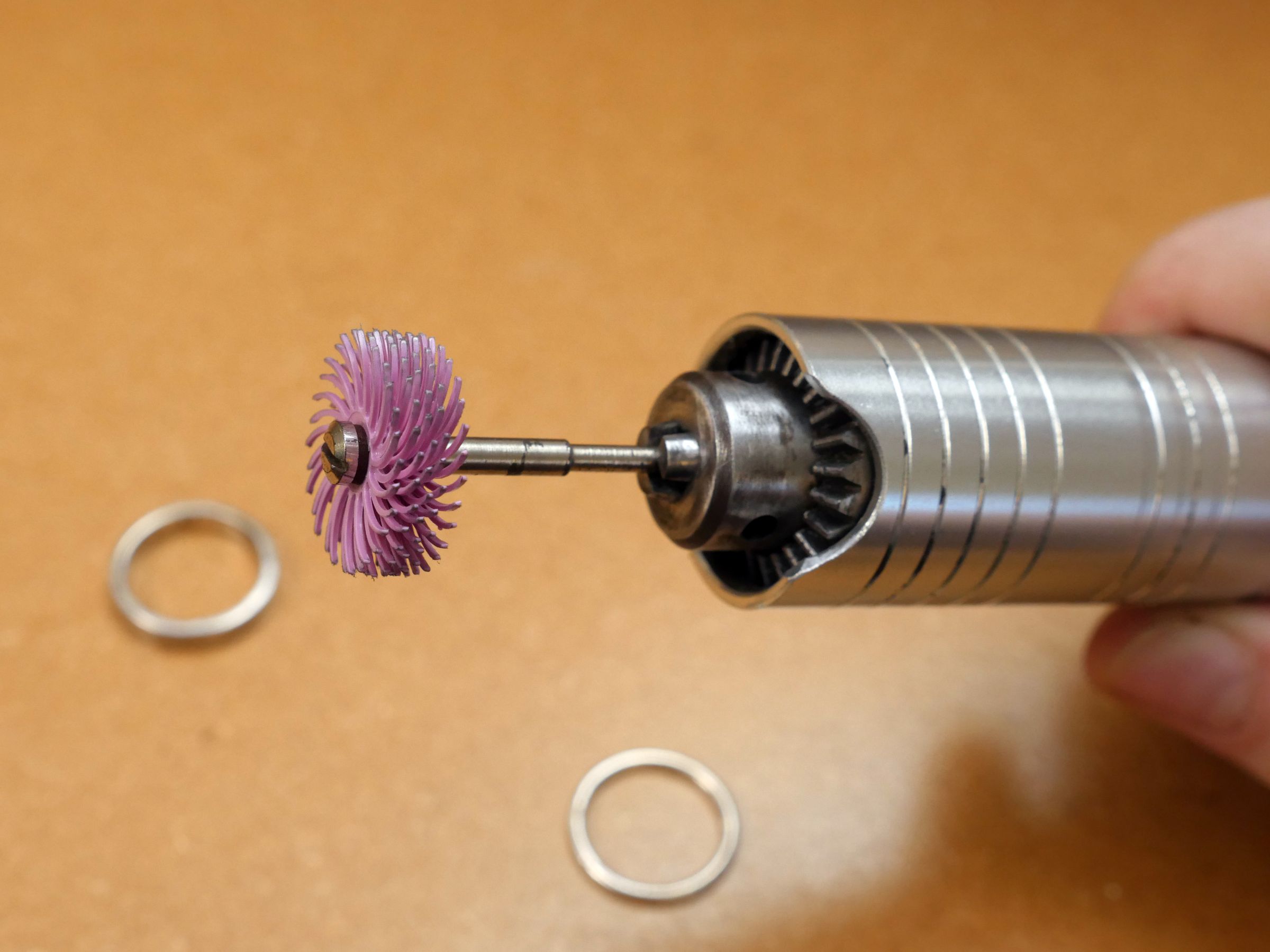

Used in this class for drilling holes and polishing metal, a rotary tool is incredibly useful for small jewelry projects (and can shorten sanding time quite considerably). Although I love my Foredom flex shaft, which has a hanging motor, lightweight handpiece, and foot pedal for speed control, you can get by with a Dremel or a full size power drill held in a vice.

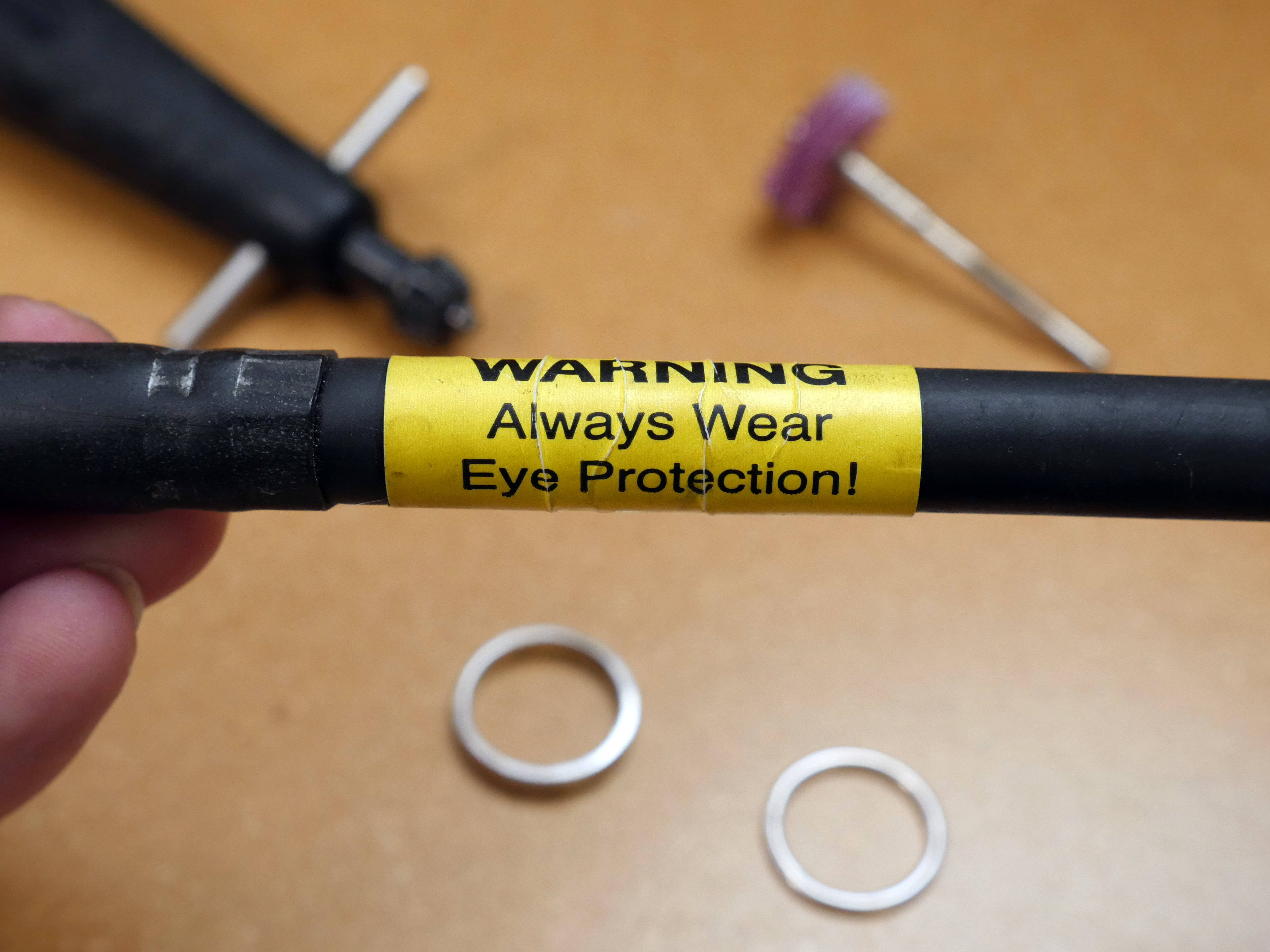

These tools spin very fast, and run the risk of launching a bit of material or broken tool into your eyes or someone's near you. Always wear safety glasses and a dust mask when using rotary tools, and tie long hair back.
The function of the rotary tool changes based on what accessory is loaded in the chuck (a dedicated wrench is often required). This class uses tiny drill bits to pierce internal cutouts in the sheet metal project, and polishing buffs to finish the surface of the soldered ring project. Polishing compounds are very fine abrasive materials used with soft buffs to refine surfaces all the way to a highly polished mirror finish, if desired.
There are many other types of rotary tool accessories available for sanding and polishing (brushes, bristle discs, silicone with embedded abrasive, etc.), and you may discover a preference for certain types and shapes based on what you like making (e.g. flat broad shapes vs. more intricate designs with hard-to-reach places).

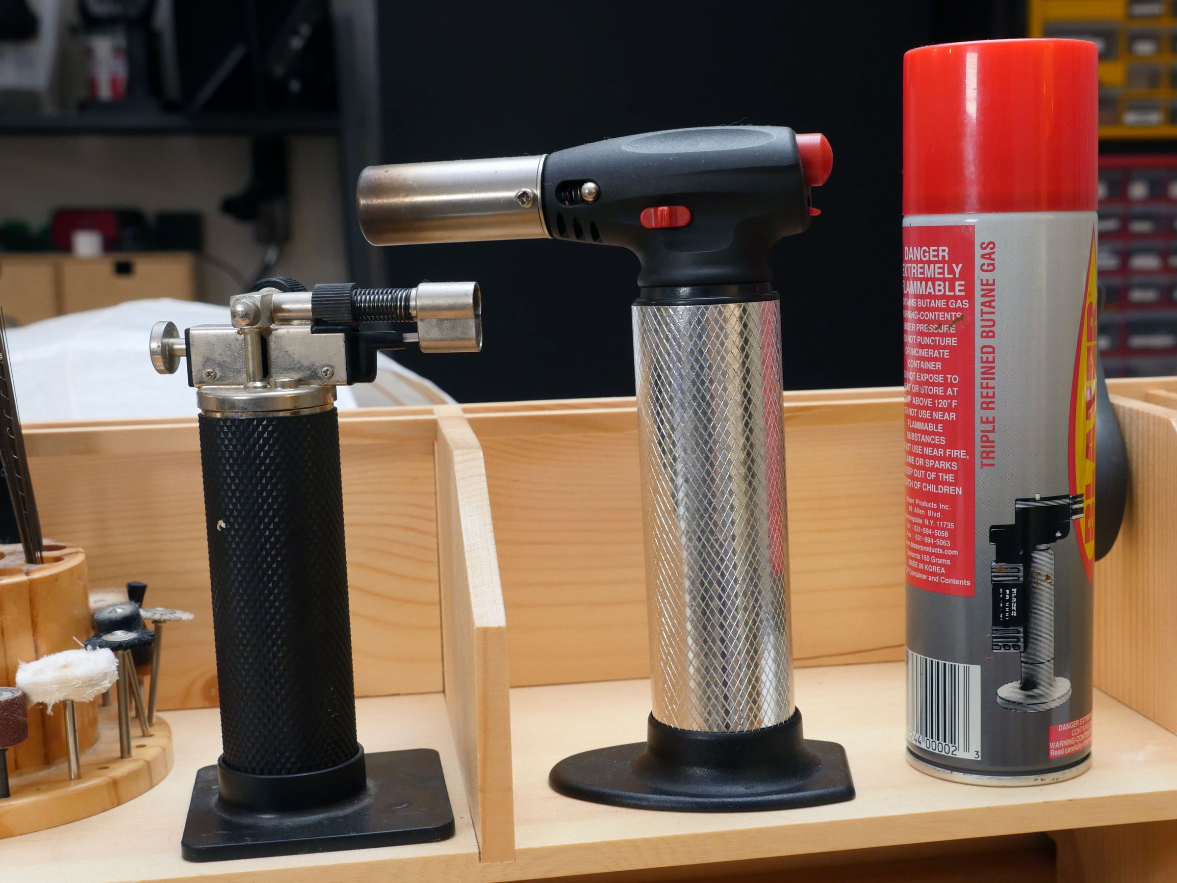

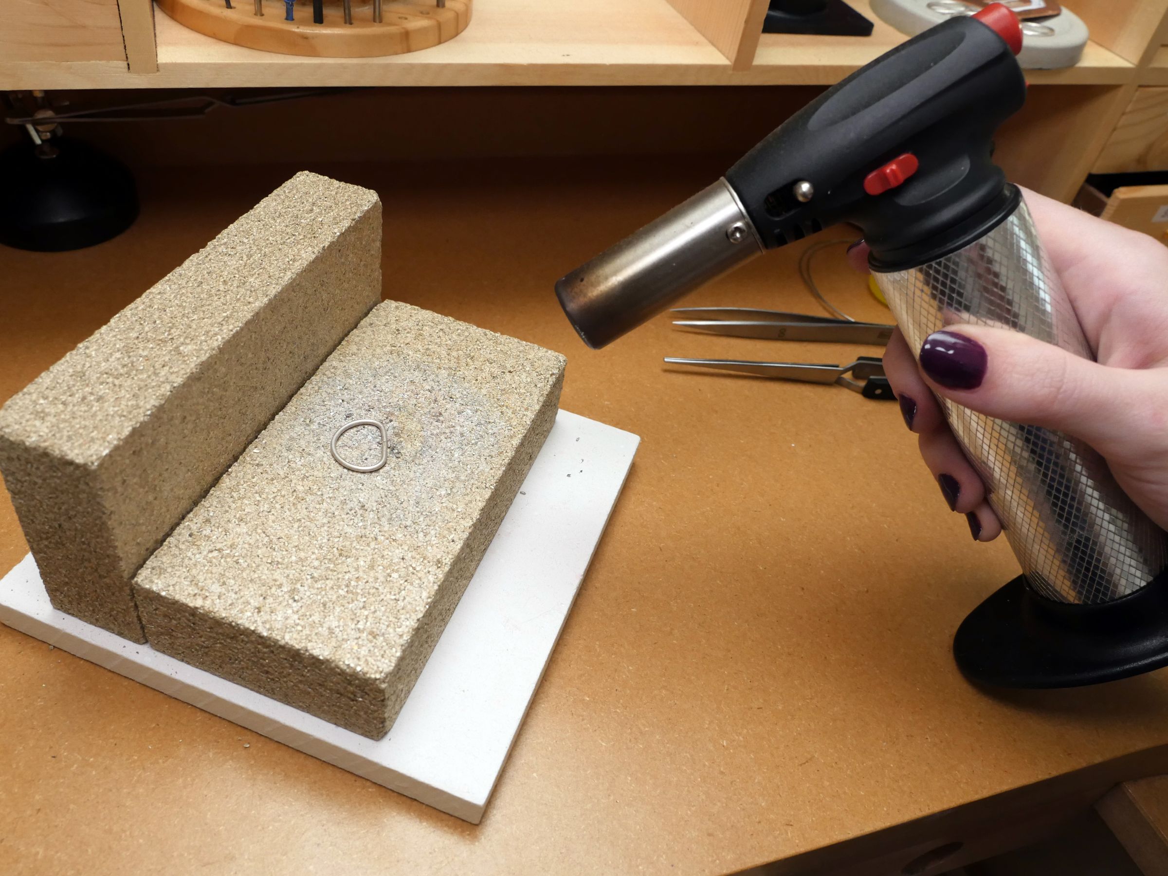

You can find small and relatively inexpensive butane torches at kitchen supply stores and online. These household-type torches are perfectly suited to the small silver wire project in this class. Store the torch and fuel in a safe place, protected from extreme temperature, and be sure to keep a fire extinguisher nearby.

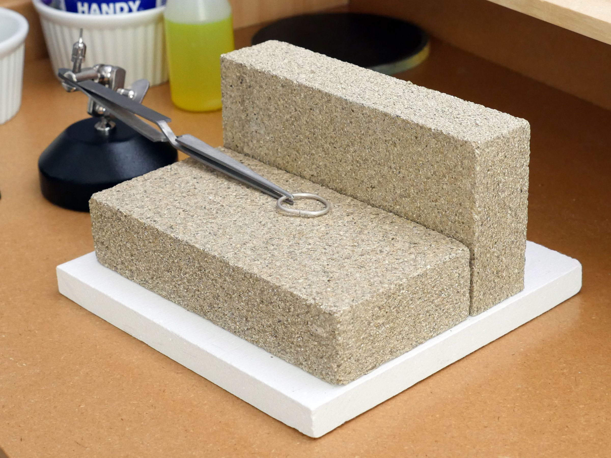

To protect your work surface, you'll solder on fireproof bricks, which are available in many materials such as vermiculite, charcoal, and ceramic.

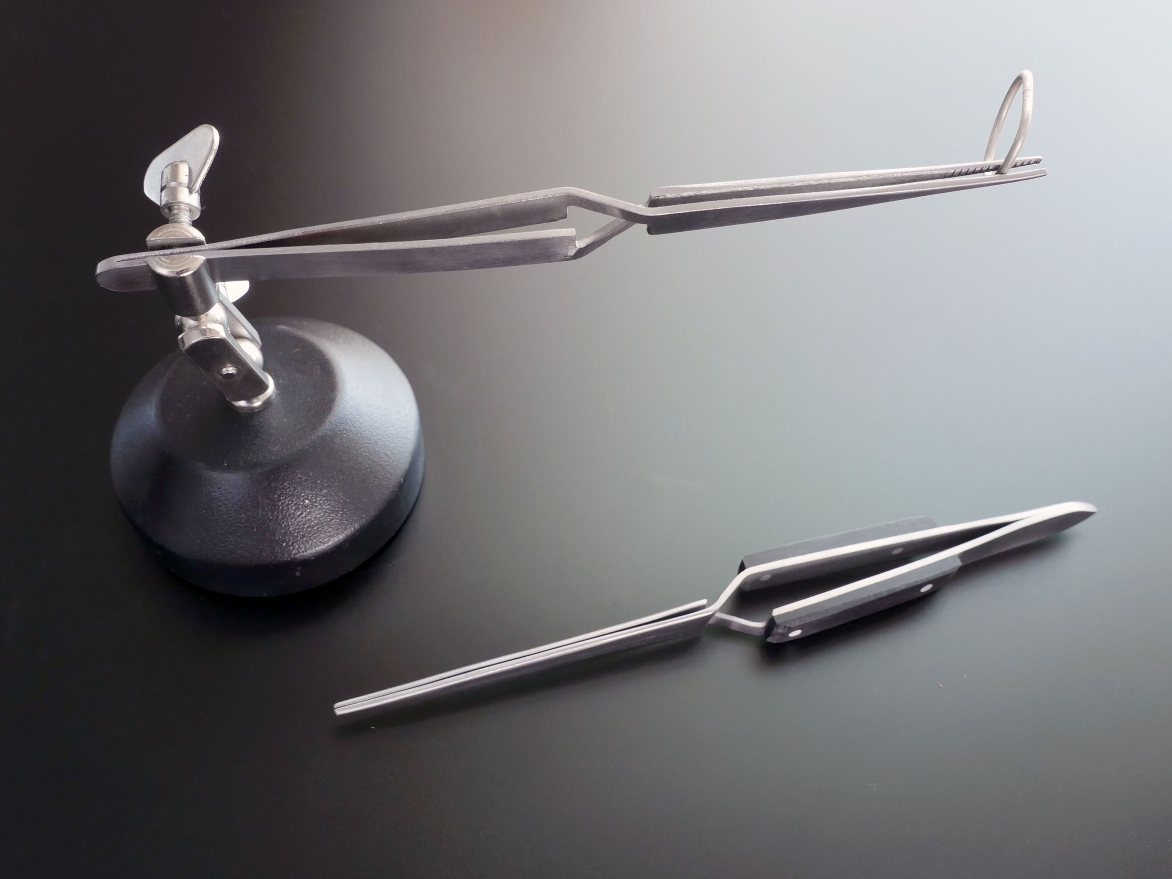

Cross-locking tweezers (as a third-hand tool or alone) are great for holding onto hot jewelry pieces. They operate opposite from regular tweezers, clamping down by default and only releasing their grip when you squeeze the handle.

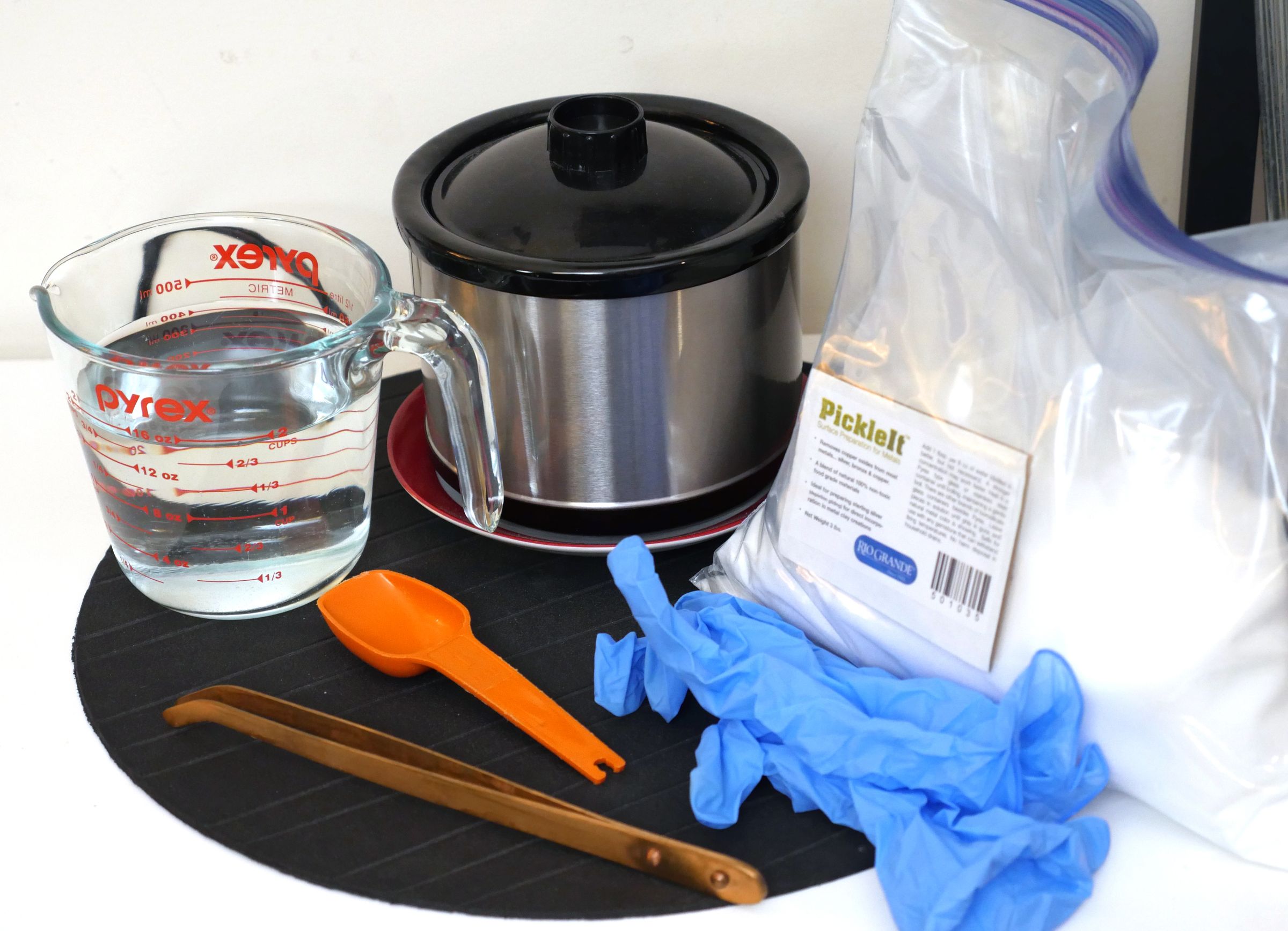

After soldering, a byproduct of oxidation called firescale will have formed on your metal, which is best removed by a pickle solution. This acid works better when it's warm, so you'll use it in conjunction with a little slow cooker called a pickle pot (never again to be used for food). If you can't use a dedicated pickle pot, a mason jar is a suitable alternative, although the process will take considerably longer at lower temperatures. Be sure to read the chemical safety information and instructions with your pickle: some are very hazardous and others rather benign (safety glasses, gloves, and a well-ventilated area are recommended regardless of pickle type). Many pickle solutions react to steel tools, ruining the batch by copper-plating anything that enters it afterward. For this reason, copper tongs (or wood, or plastic) are used to deposit into and fetch jewelry pieces from the pickle pot.
