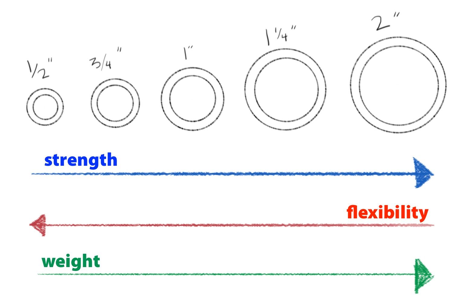

Common PVC Pipe Sizes
You have lots of options when it comes to PVC pipe sizes, the most common are 1/2", 3/4", 1", 1 1-/4", and 2". The larger the pipe size, the more rigid and less flexible it will be. This makes thin tubes really useful for lightweight applications and small structures, but poorly suited to standing up to heavy loads because the pipe will flex. As the pipes increase in diameter, so does the inner wall thickness, making them stronger and more inflexible. For most projects, I use 1/2", 3/4" or 1-1/4". The smaller diameters bend and flex easily but still maintain some strength - good for hoop houses and gardening projects. The larger diameters are great for making structures or furniture because they will not bend and are very difficult to sheer. Larger diameters are also quite heavy and cumbersome. Be sure you're ready to carry big bulky pipes.
The wall thickness of your pipe and fittings is called the schedule. The two most common schedules are 40 and 80. Schedule 40 PVC is typically white, and used for residential and irrigation purposes. Schedule 80 PVC has a thicker wall, dark gray in color, and is used for commercial and industrial applications. It is wise to not mix schedule 40 and schedule 80 parts and pipes in one project, as they have different fit tolerances as well.
Besides rigidity, schedule 80's thicker wall also allows for a greater amount air or water pressure to flow through the pipe. Schedule 40 PVC pipe will be able to stand up to most tasks that you can imagine, but if you anticipate more than 300 psi of operating pressure, consider using schedule 80 pipes and fittings (unless you're making something very dangerous, or insanely strong, you shouldn't need it).

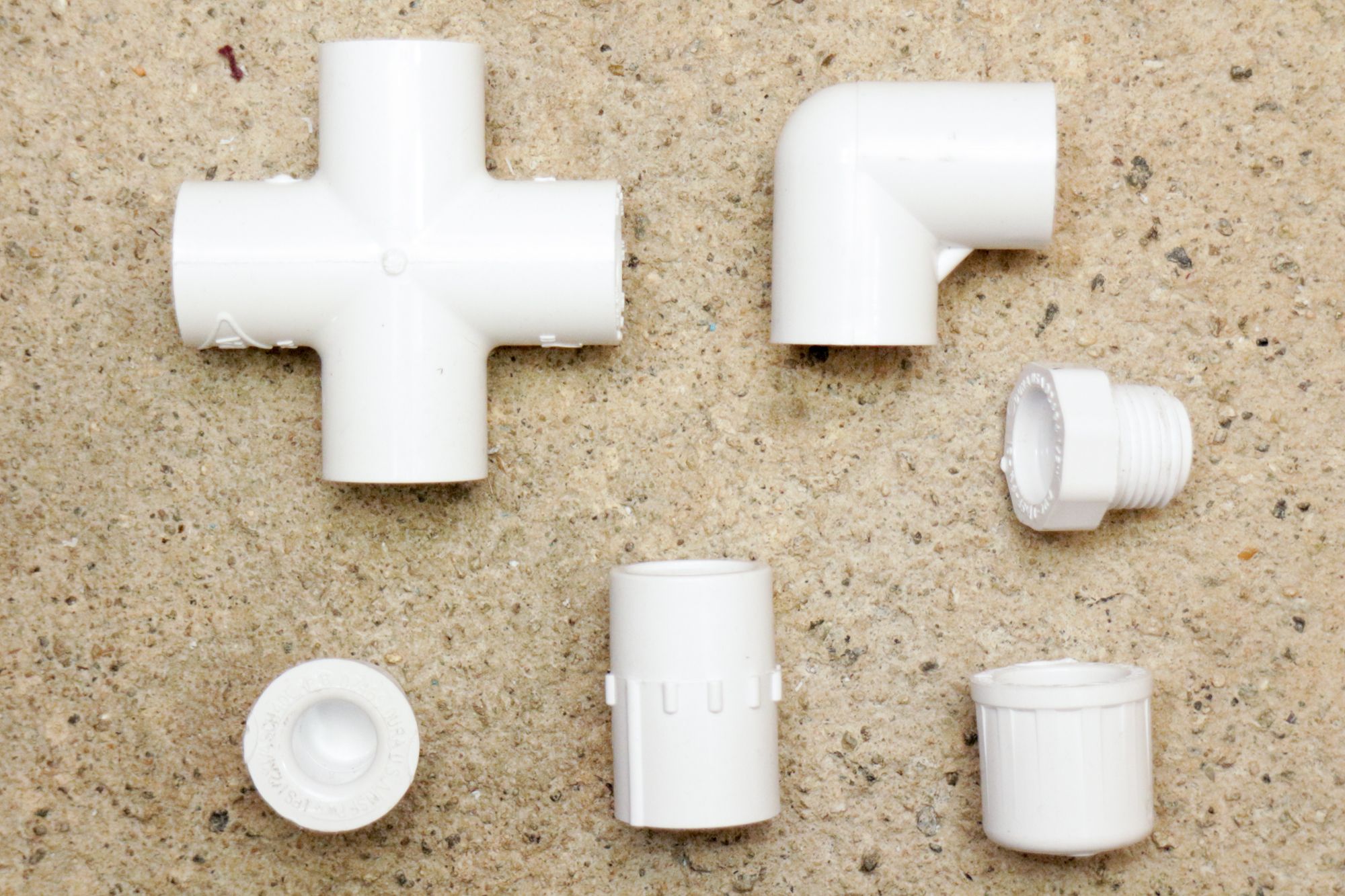

Kinds of Fittings
There are many kinds of fittings, from your basic tee, or straight pipe coupler, to 3-way elbows, or even 5-way connectors. Common bend angles of fittings include 90, 45, and 22. If you need to make a joint at a different angle, consider using a flexible coupler, if water needs to flow through your project or a more structural adjustable fitting that joins with a bolt, if your project needs to collapse or be set at an uncommon angle.

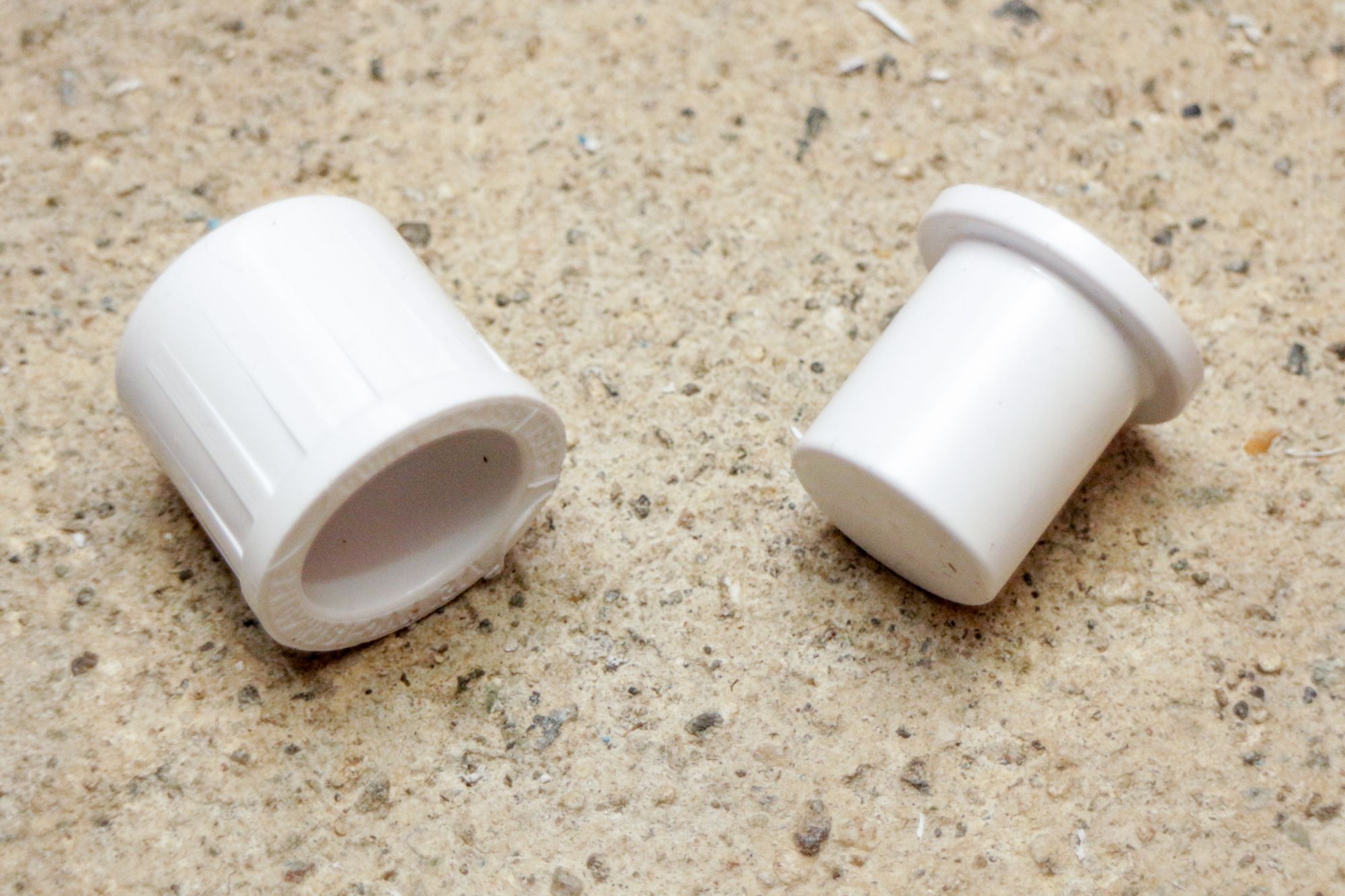

As we learned above, pipe is available in many different diameters. Every once in awhile you will encounter a situation where you need to connect two different sized diameter pipes. This can be done with adapting or reducing couplings or bushings.
A coupling connection is made by connecting to the outside diameter of the pipe, while a bushing connection is made on the inside diameter of the pipe.
The same is true for and external end-caps and internal stop-plugs.
Most fittings you will find are called slip fittings. In these connections, the pipe easily inserts into the joint to be fastened together. You can also find threaded fittings. Threaded fittings are great for making modular structures, or adapting to other pipe materials like steel, brass, or copper.
