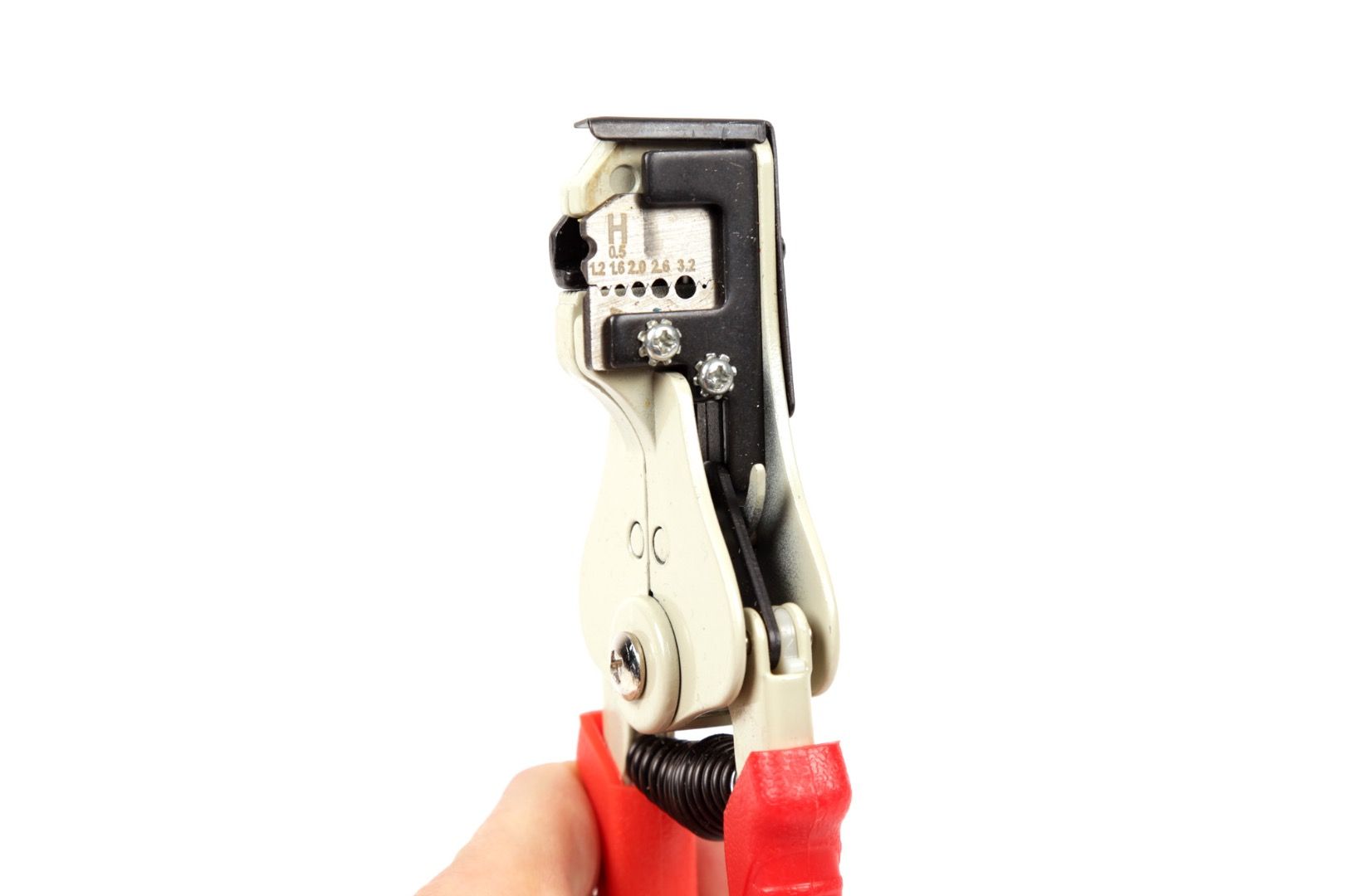

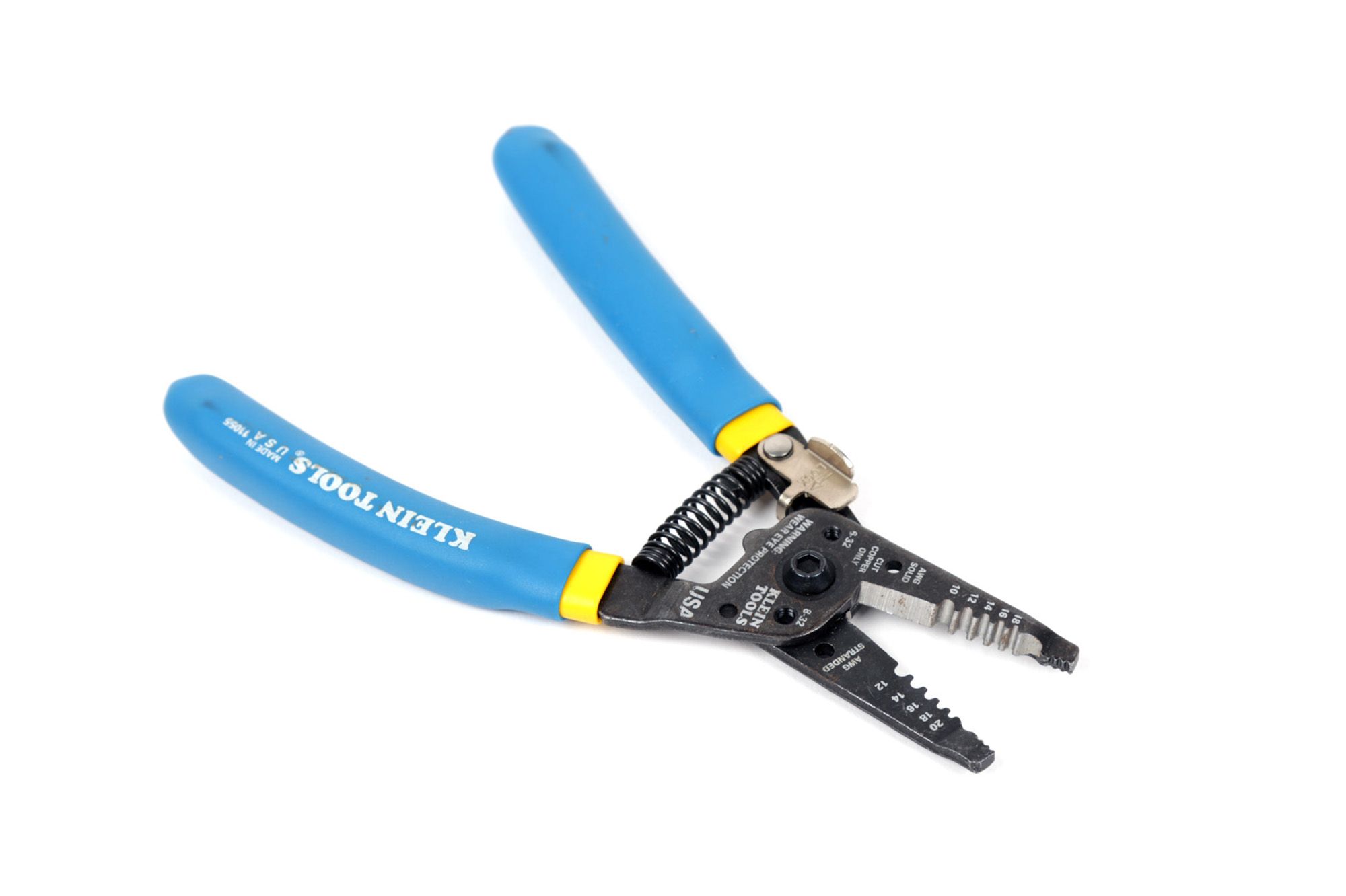

Wire Stripper
There are two main types of wire strippers available on the market: manual and automatic. The manual versions require some wrist action + elbow grease and come with a built in cutter. If you don't plan on making a ton of lamps, this is the one I'd recommend getting, as it's the least expensive. If you think you'll be making all of your relatives lamps for the holidays, do yourself a favor and invest in an automatic stripper. Your wrist will thank you.
Wire Cutters
I like having two sizes of wire cutters. The larger pair is for the grunt work of cutting the cord and the smaller one is for the finesse work of cutting the wire. If you end up buying the manual wire stripping tool, it will already have a wire cutter built in which will be adequate for the cord cutting, so in that case, I would just get the smaller pair and not both.

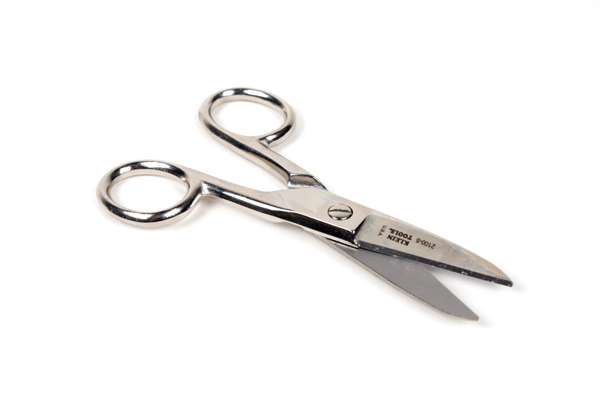

Box Cutter & Scissors
For general purpose good measure.

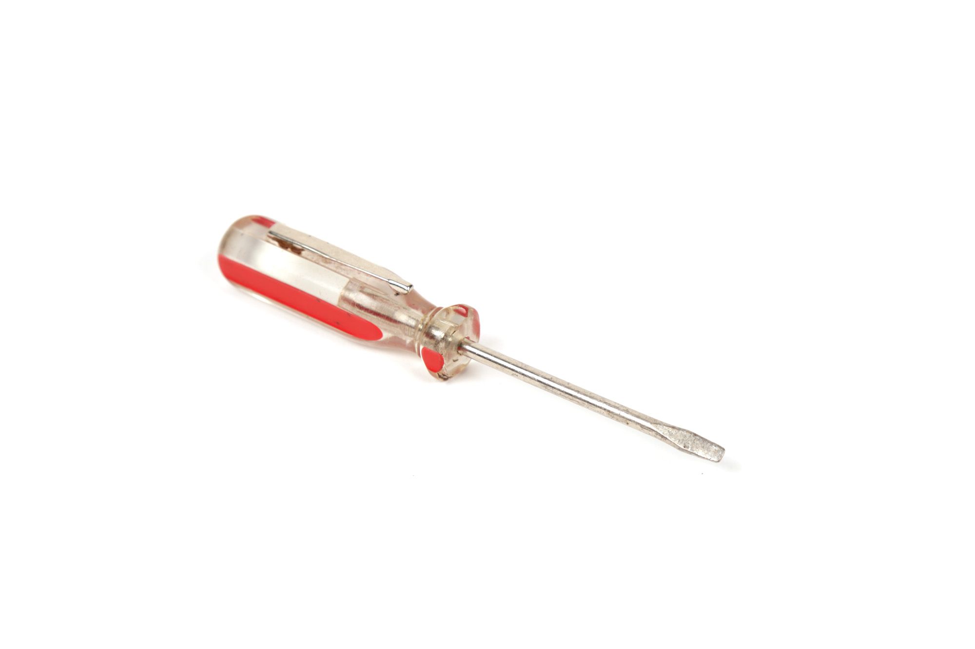

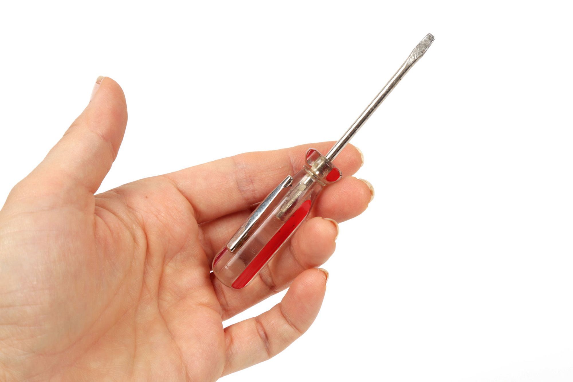

Small Flathead Screwdriver
This is one of the most important tools in a lamp making tool kit. I use it to tuck twisted wire ends around socket screws, separate caps and shells (socket housing) for repairs, and so much more! I would definitely recommend investing in one of these little puppies.

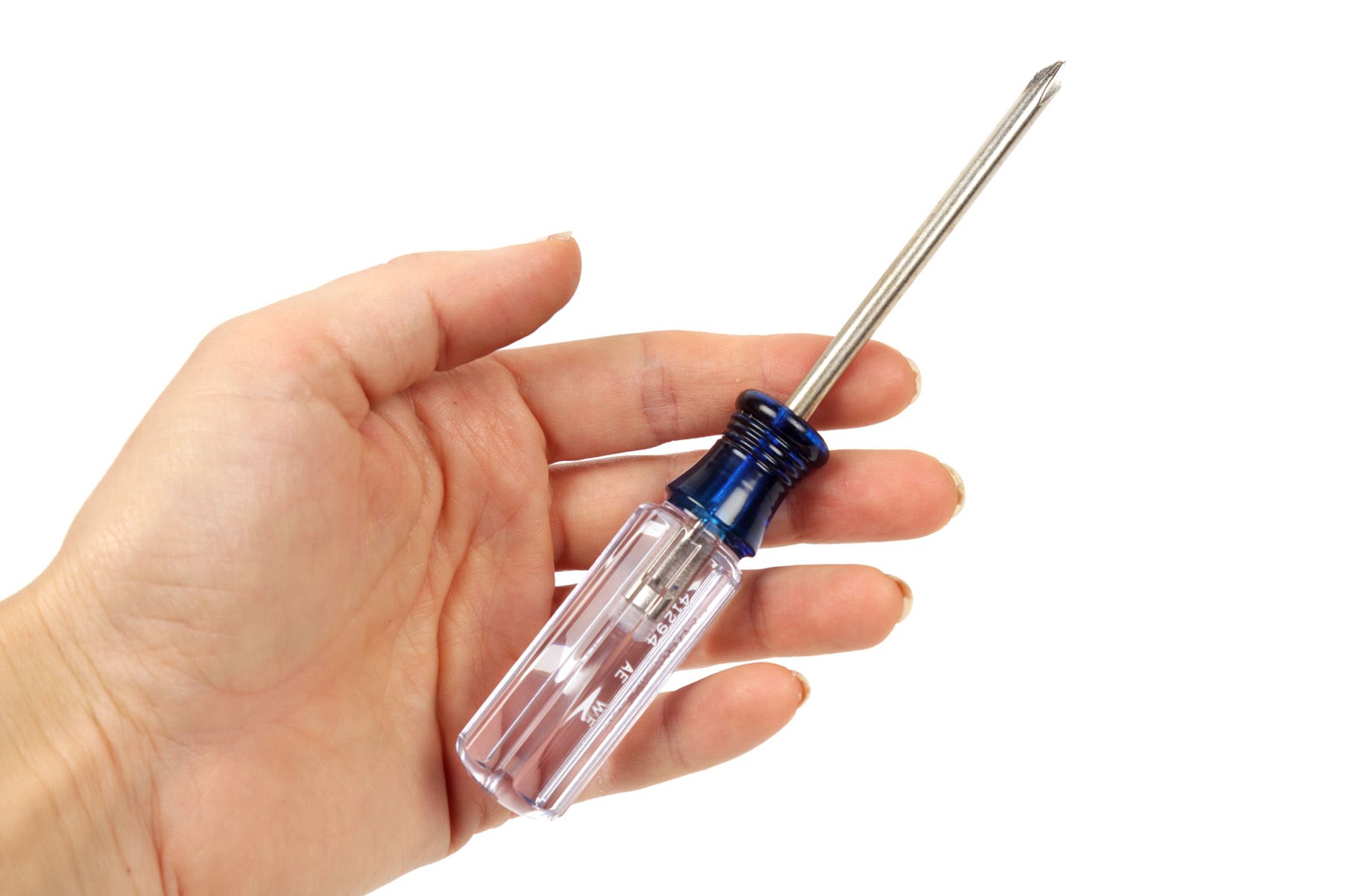

Phillips Screwdriver
This is another mandatory tool. It's used to tighten the socket screws and to take apart and reconstruct line switches and old fashioned style plugs. Make sure you buy one that fits comfortably in your hand and is easy to maneuver. A 6.5" - 8" one will work, depending on your hand size.

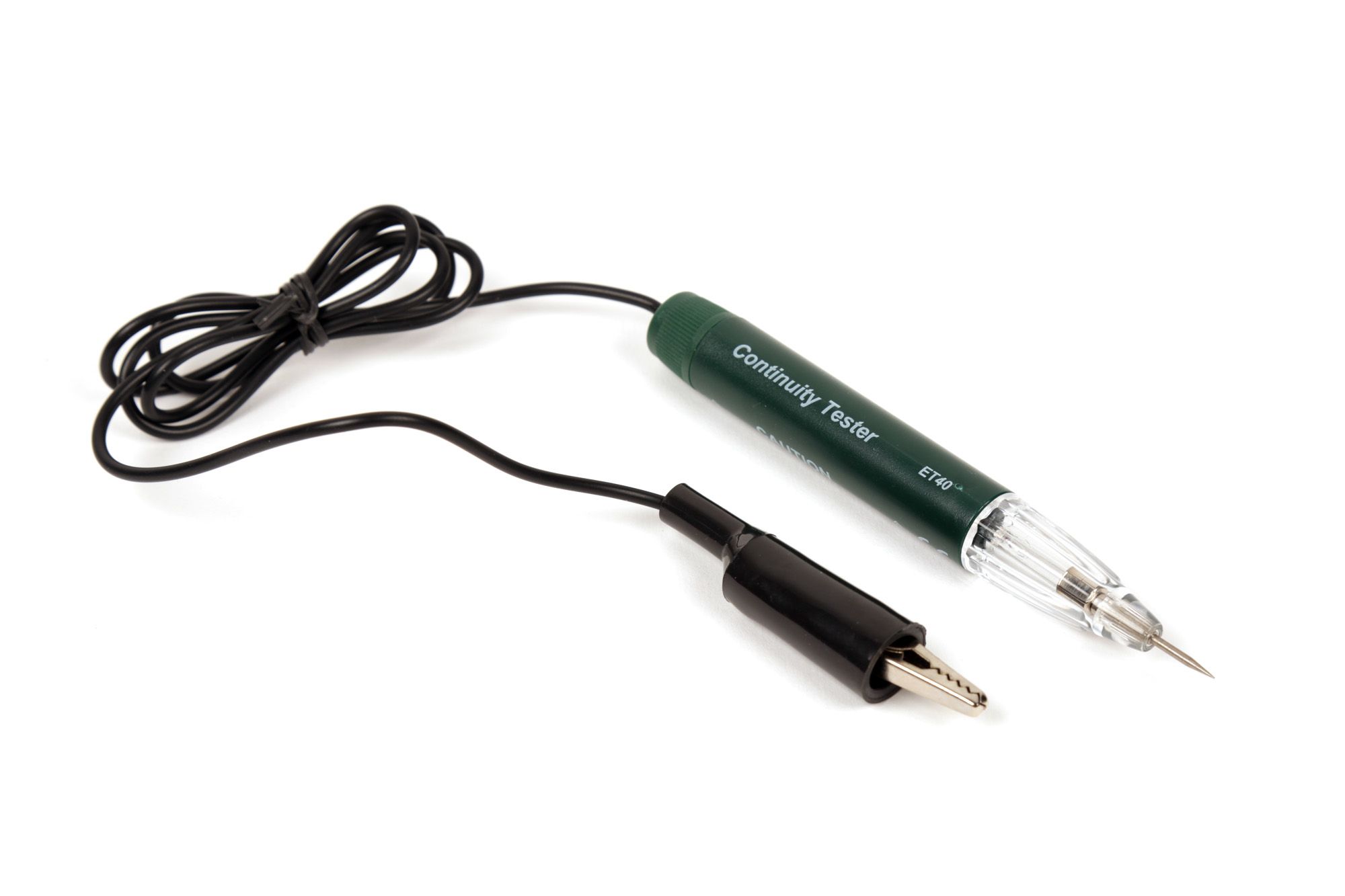

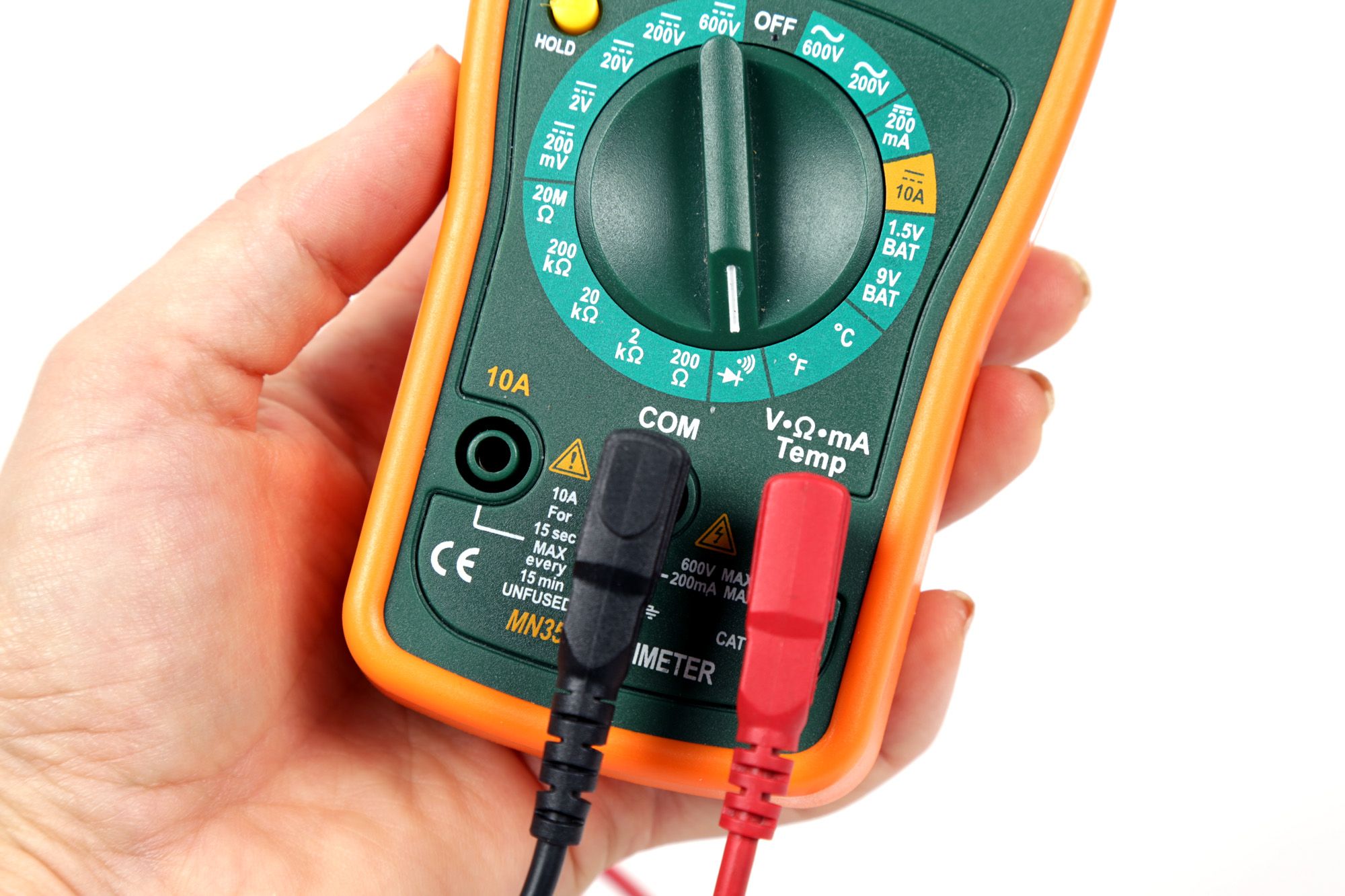

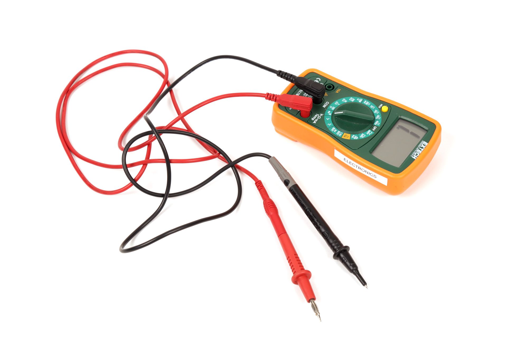

Continuity Tester OR Multimeter
It's important to have a way to test whether or not you've wired your lamp correctly BEFORE you plug it in, so you don't risk blowing a fuse or scaring yourself with the spark incorrect wiring can generate when plugged in. Either of these tools will do a great job of helping you discern this.
The continuity tester's only job is to test non-energized circuits, fuses, switches, wiring, etc. It's the simplest and cheapest of the two options and is perfectly adequate for all portable lamp testing.
The Multimeter, also known as a VOM (Volt-Ohm meter or Volt-Ohm-milliammeter ), is an electronic measuring instrument that combines several measurement functions in one unit, like measuring voltage, current, and resistance. It is way more than we need for this class, but if you already have access to one, it will definitely work for our simple testing purpose. Just set its switch to the setting pictured in the bottom right image below.

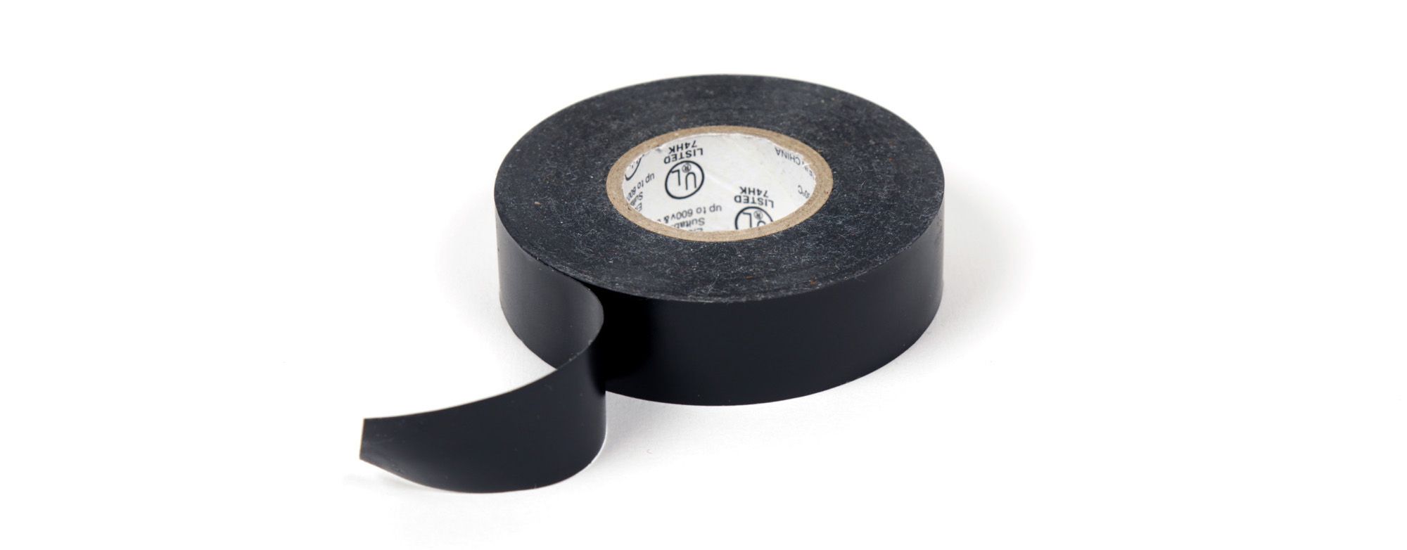

Electrical tape, also known as insulating tape, is used to insulate electrical wires and other materials that conduct electricity. For our purposes, it's used to secure wire nuts in place.
electrical tape

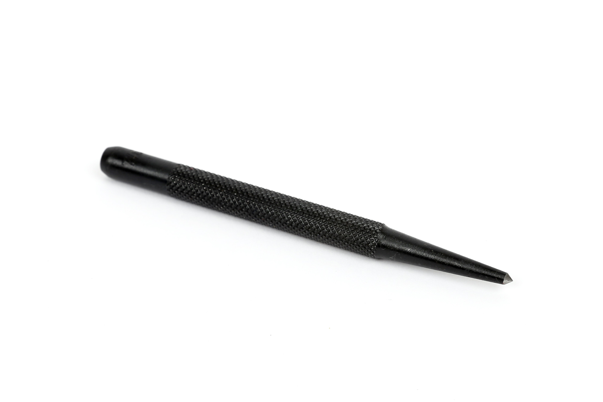

This, along with the hammer, is used to create a small hole in wood, metal, and some plastics that gives a drill bit a starting point and helps it stay put and not wander as you drill.
Center Punch

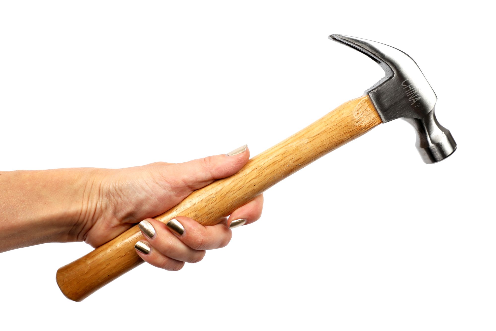

Used by Thor AND by us to make drilling center punch marks in future shades and lamp bases.
Hammer

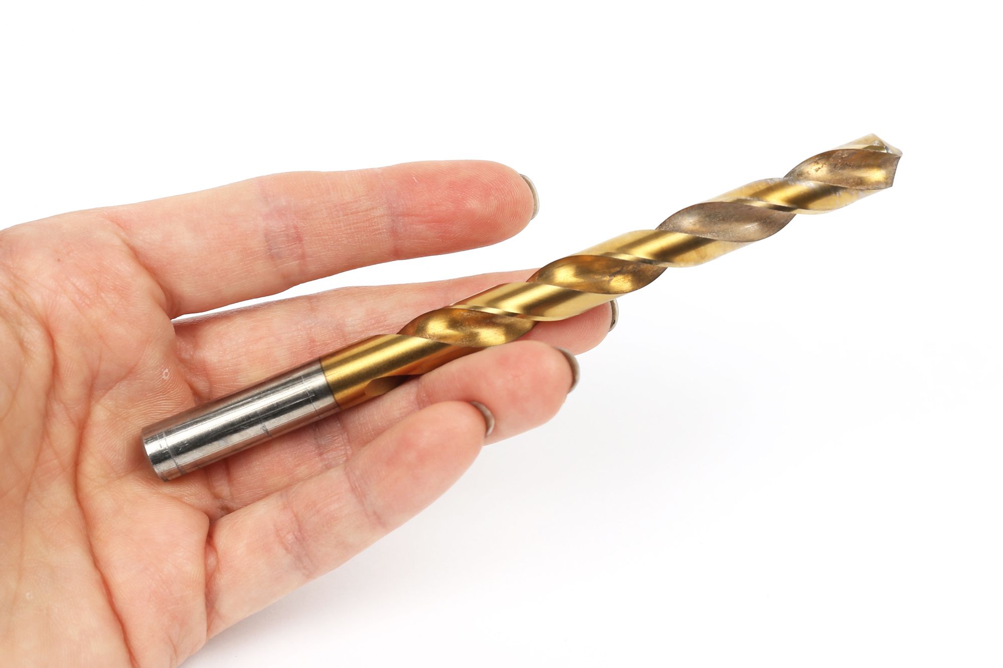

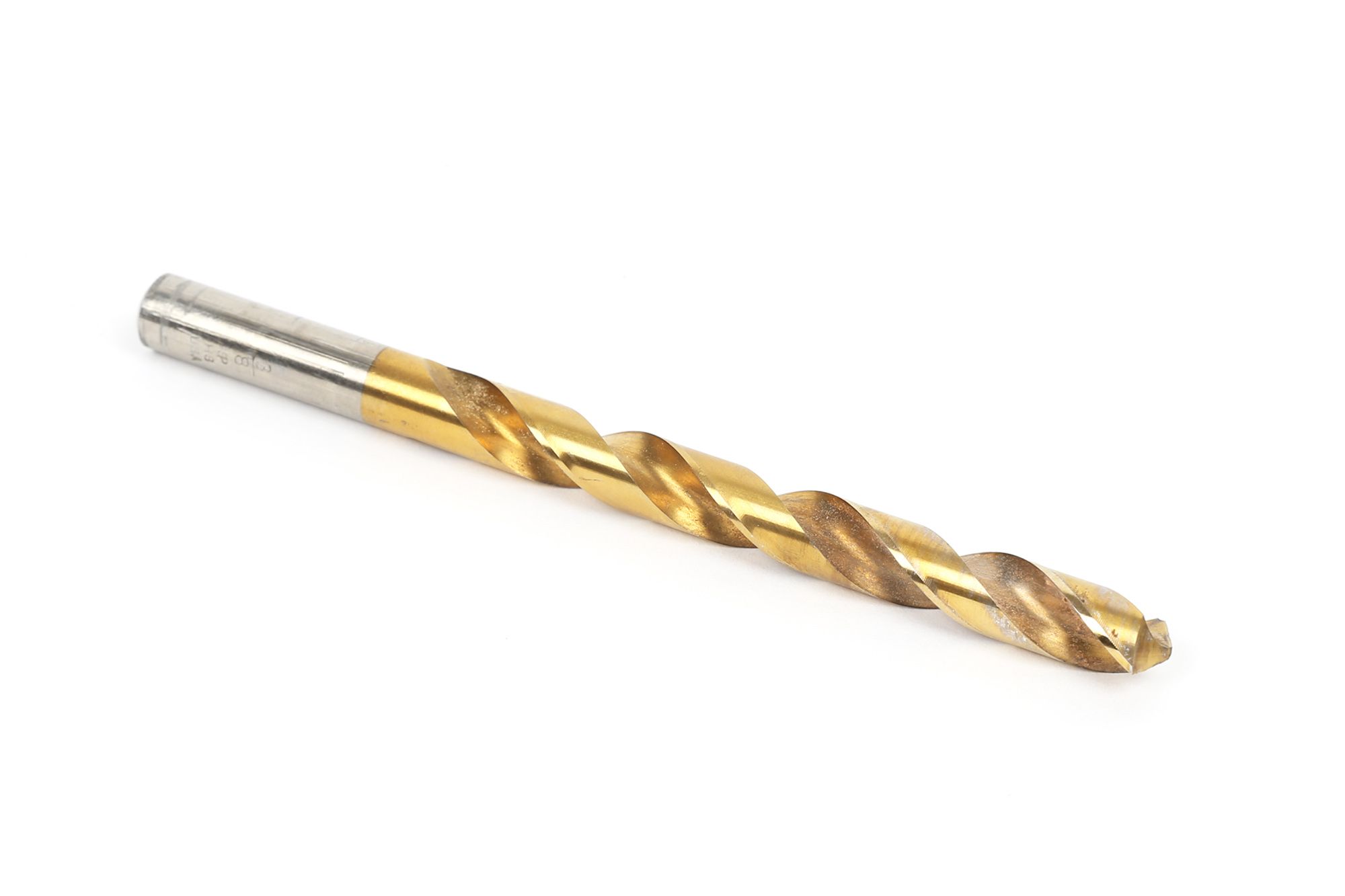

This drill bit is the size I use to drill holes in lamp bases to accommodate a center threaded rod. I find it's the best hole size for 1/8 IP parts.
25/64 Drill Bit

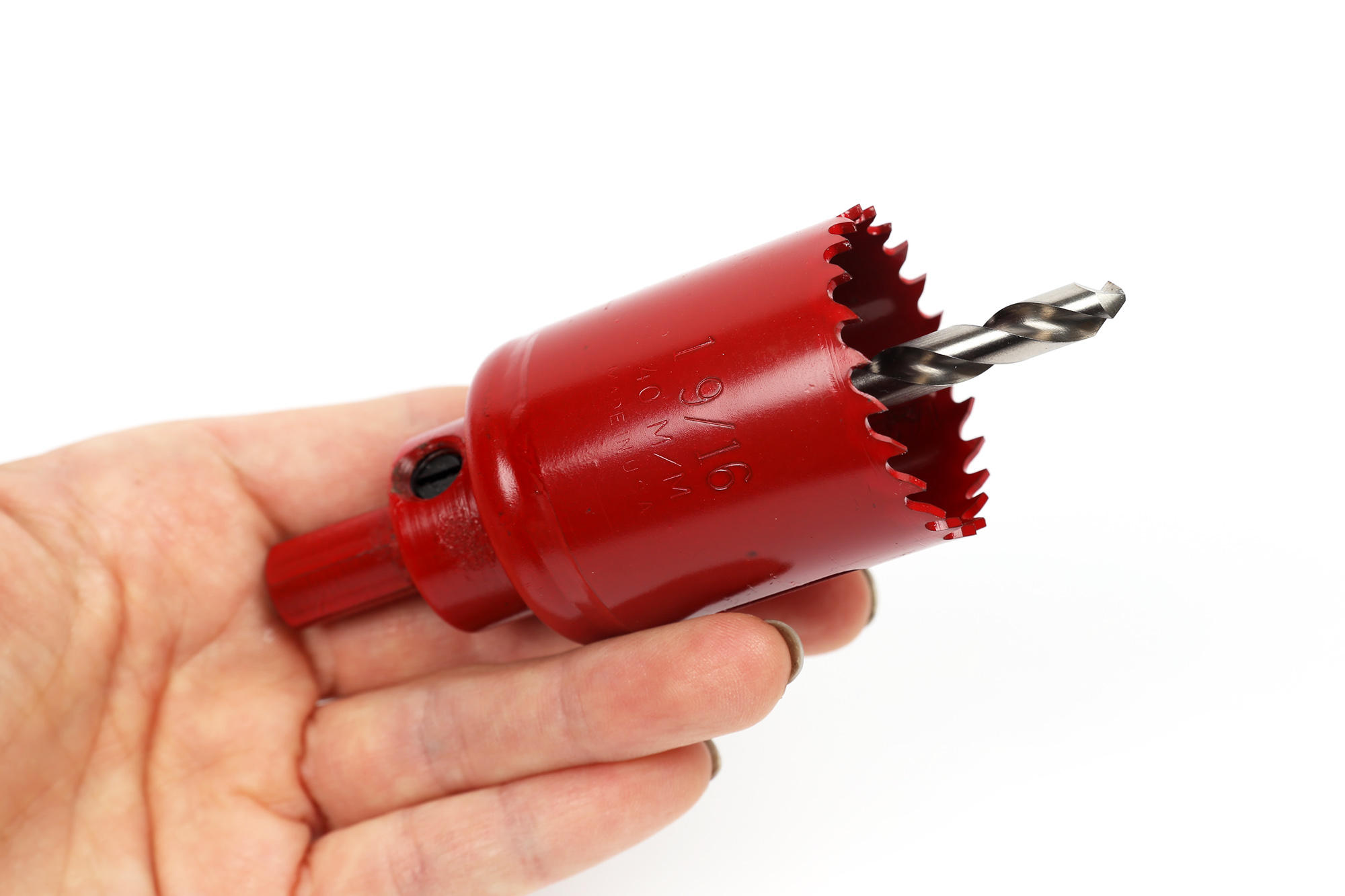

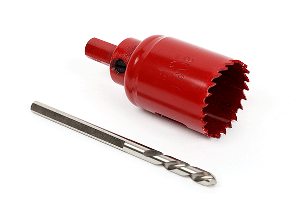

1 9/16" Multipurpose Hole Saw w/ Pilot Bit
This multipurpose hole saw works well on all kinds of materials. It is the perfect size to accommodate the threads of a phenolic socket. This one has a built-in arbor (= the part that goes into the chuck of the drill). NOTE: Must buy both the hole saw and the pilot bit. Links to both above.

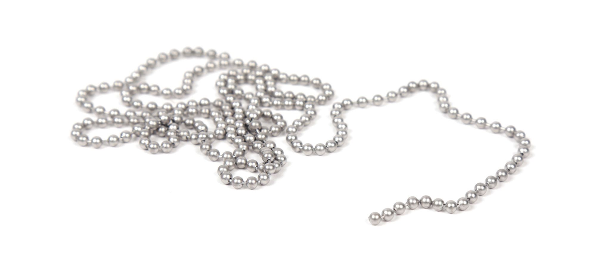

I use ball chain to help guide lamp cord through tricky interior paths. For instance, if you've drilled a hole in the side of an object and you want the cord to go into that side hole, up through the object and out the top, sometimes it can be impossible to direct the cord or it may get caught on something inside. Instead, I would suggest, securing the end of the cord to the end of the ball chain and feed the ball chain through first, which will allow you to use gravity and tilting to find the path using the chain and then once the chain is out the top, use the chain to pull the cord through. Presto!
3' of ball chain

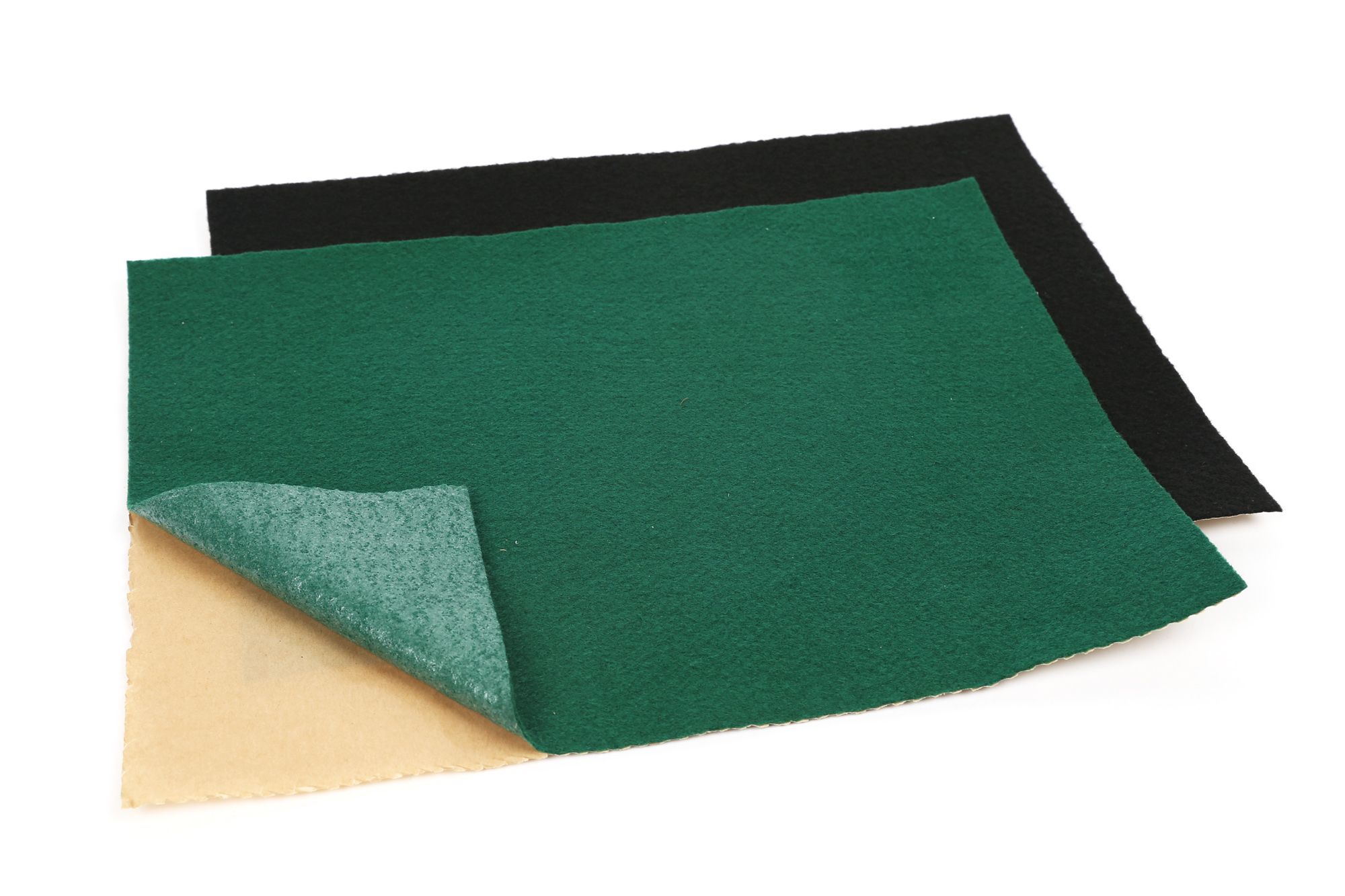

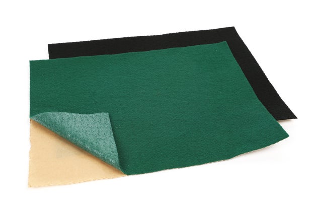

Self Adhesive Felt
Adding felt to the bottoms of table lamps is the best way to ensure that the lamp doesn't scratch the table.
