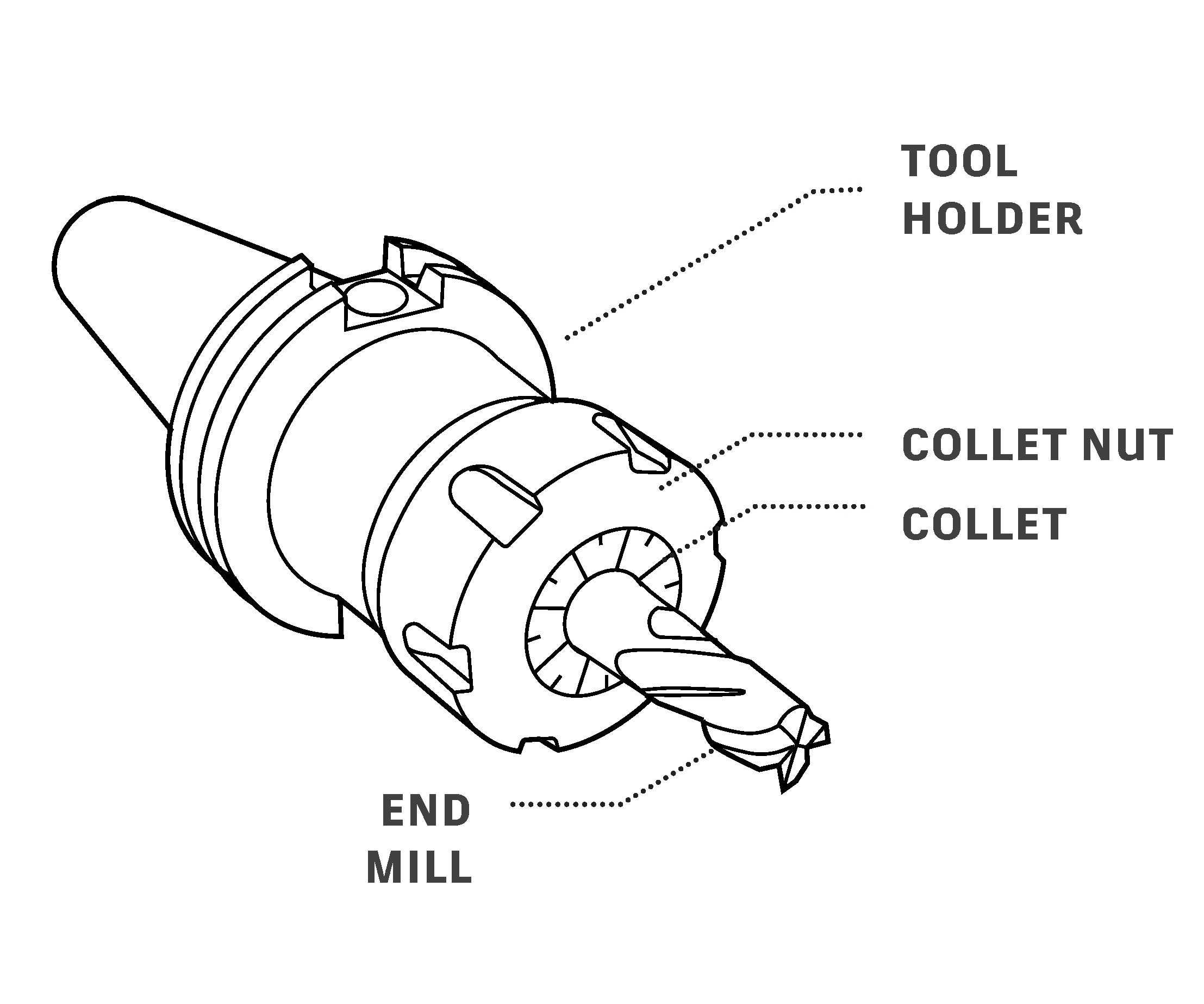

Collets & tool holders
- Use a collet that is the same size as the shank of the cutting tool.
- Snap the collet into the collet nut.
- Screw the nut onto the collet a few turns.
- Insert the cutter as deep as possible.
- Grip the shank, not the flutes.
- Tighten the collet nut with the wrench.

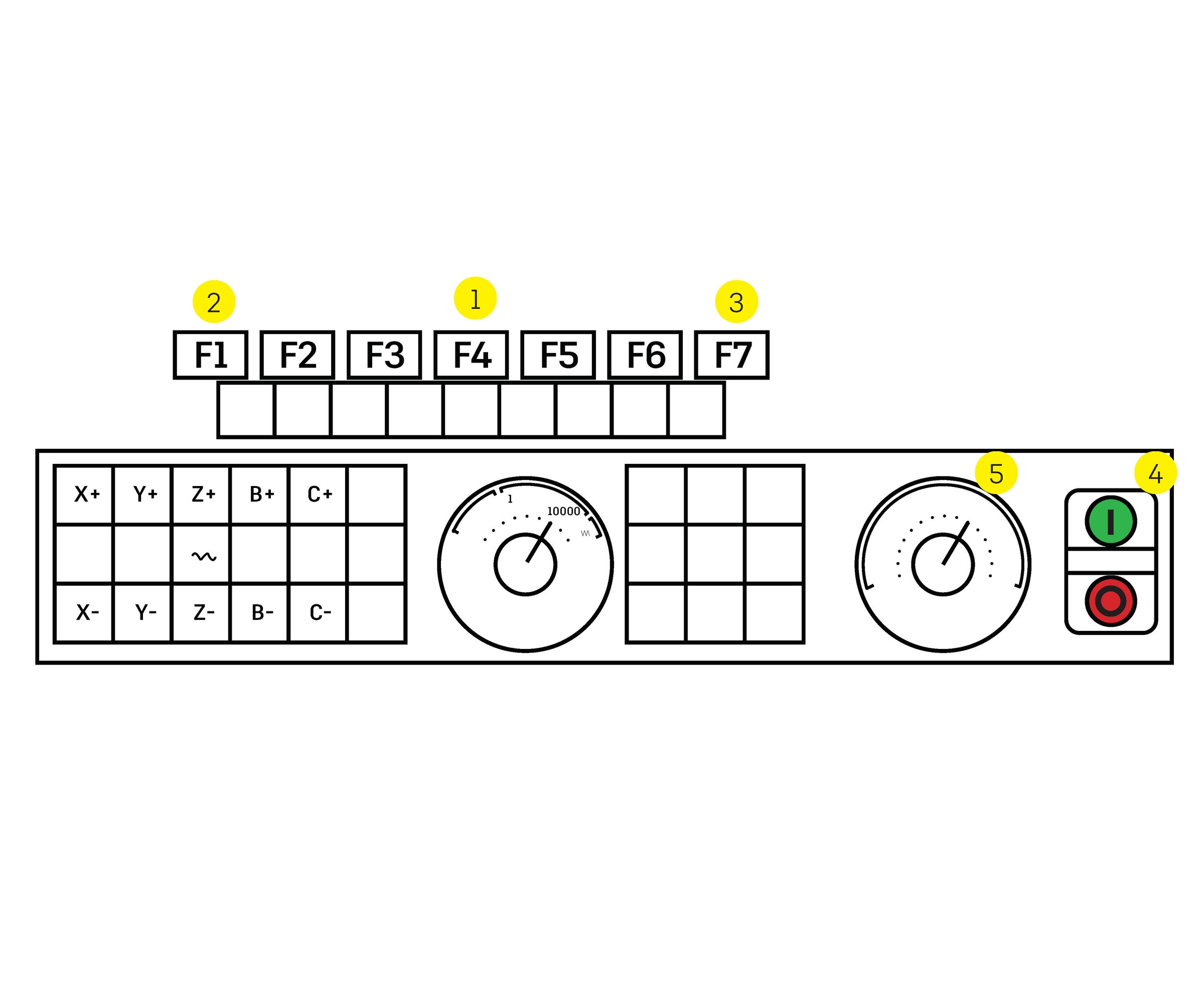

Reference the axes
- Open the Jog Menu. (F4)
- Press Reference Search. (F1)
- Select All Axes. (F7)
- Press Cycle Start.
- Check that the Feed Override is not set to zero.
Referencing the axes will hit the limit switch on all 5 axes and send the head to Machine Home. This position is G53 X0 Y0 Z0 B0 C0.
After referencing, the spindle will move to Y-1.

- Enter MDI mode.
- Press Main Menu
- Press Jog. (F4)
- Press MDI. (F4)

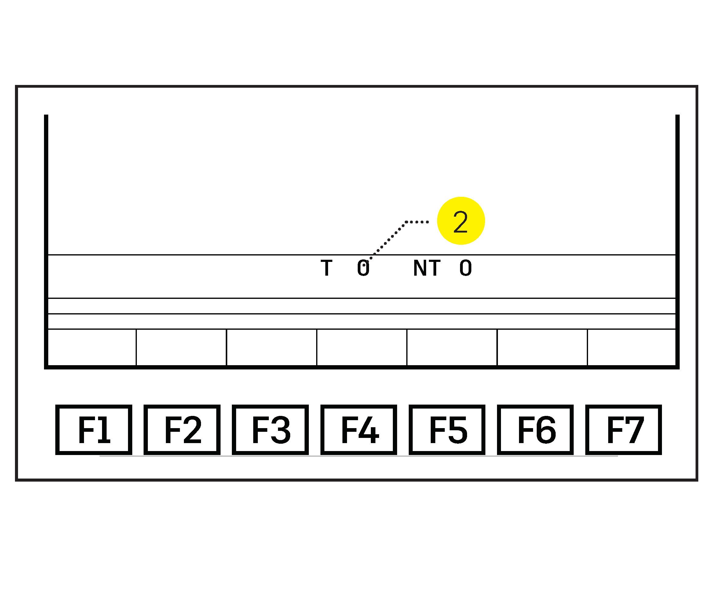

- Ensure the current tool is 0.
- If it isn't, run the Goodnight program or see Shop Staff.
- Ensure the tool magazine is empty.
- Turn the Mode Key to Setup.
- Open the spindle dust collector if needed.
- Type M66.

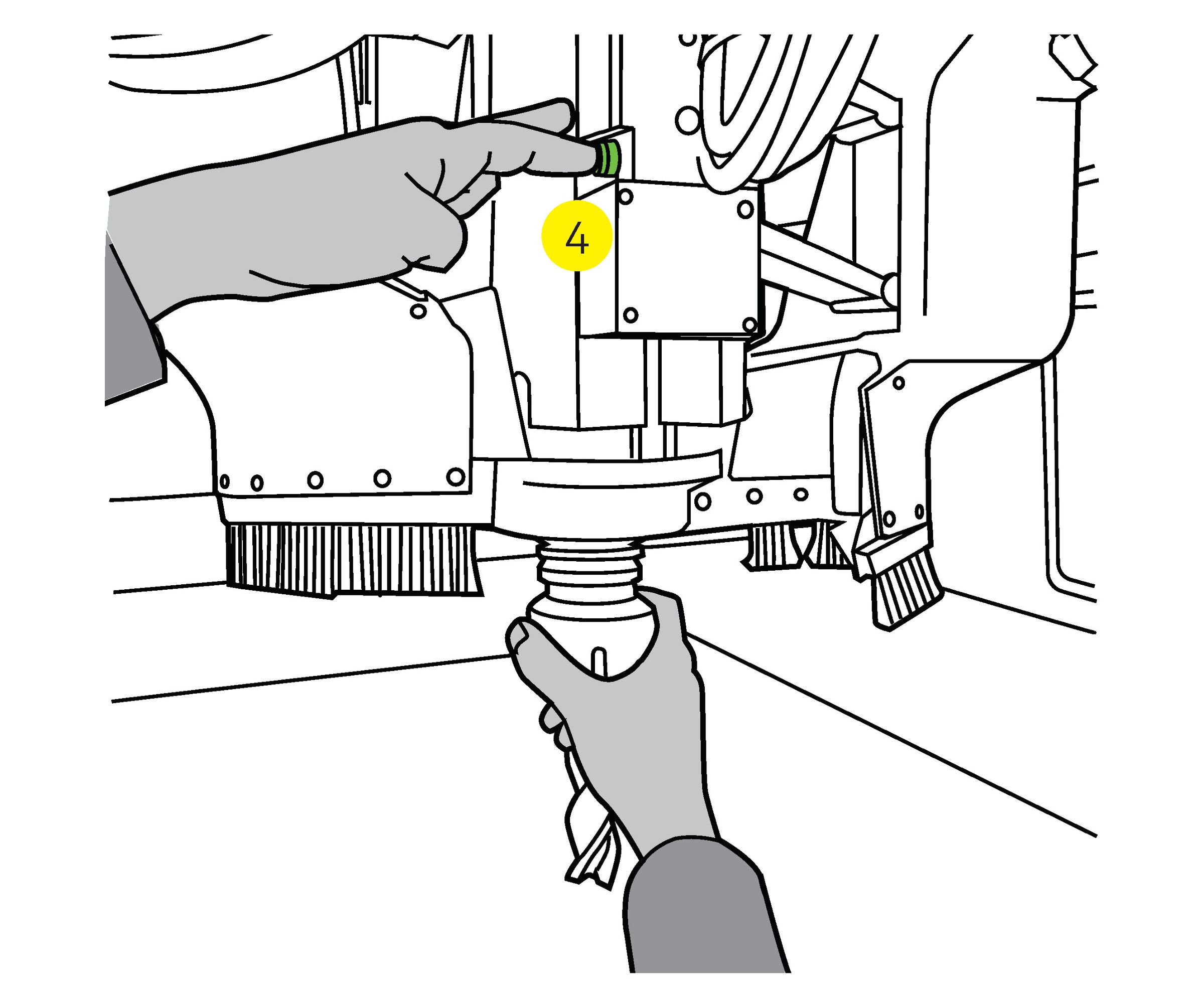

Install the tool
- Press USER. (F5)
- Press Manual Tool Eject. (F1)
- Press Enable Tool Eject. (F1)
- Insert the tool into the spindle.
- Hold the tool in the spindle.
- Press and release the green button on the spindle.
- Press EXIT (F7) twice.
